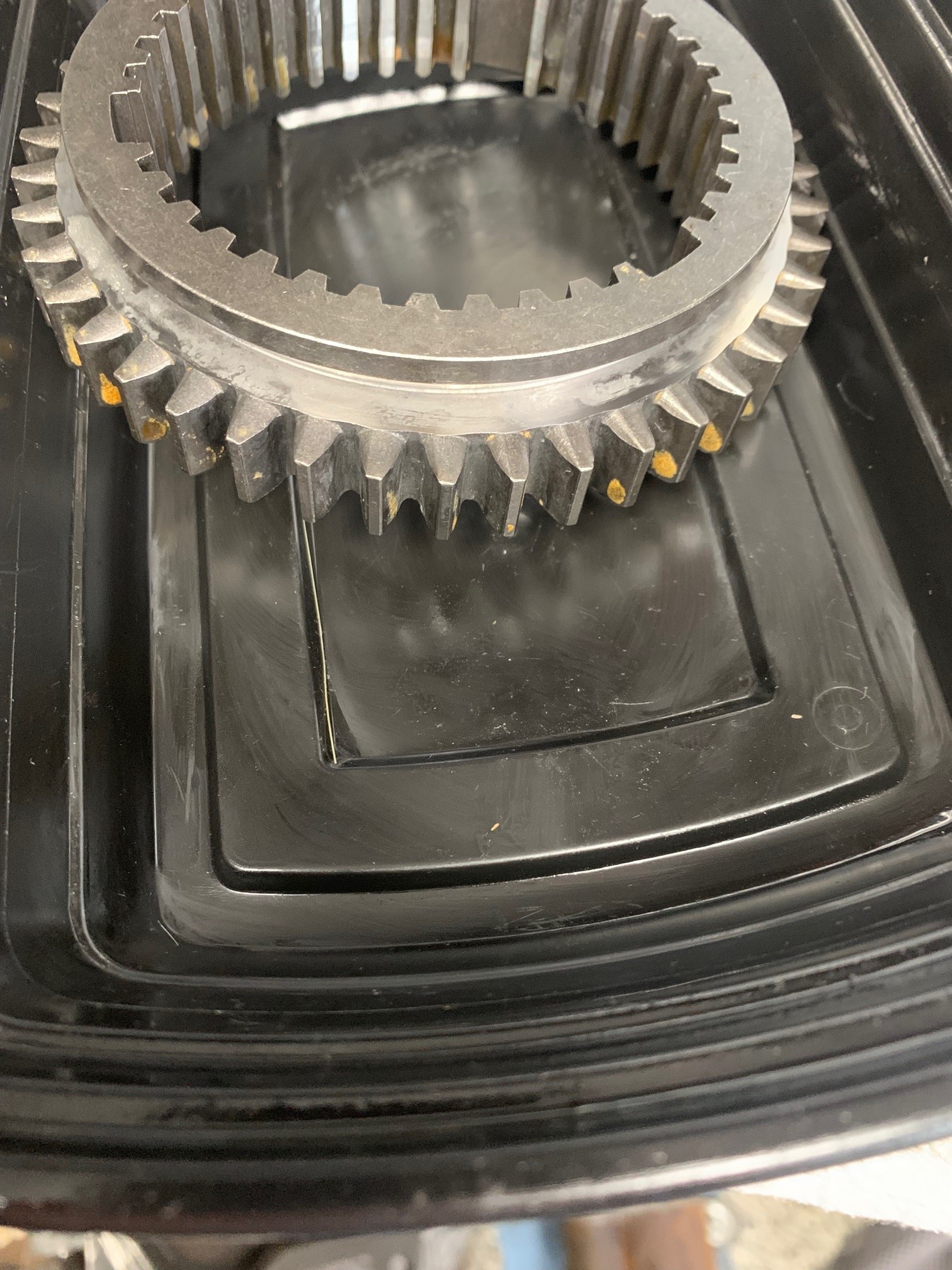

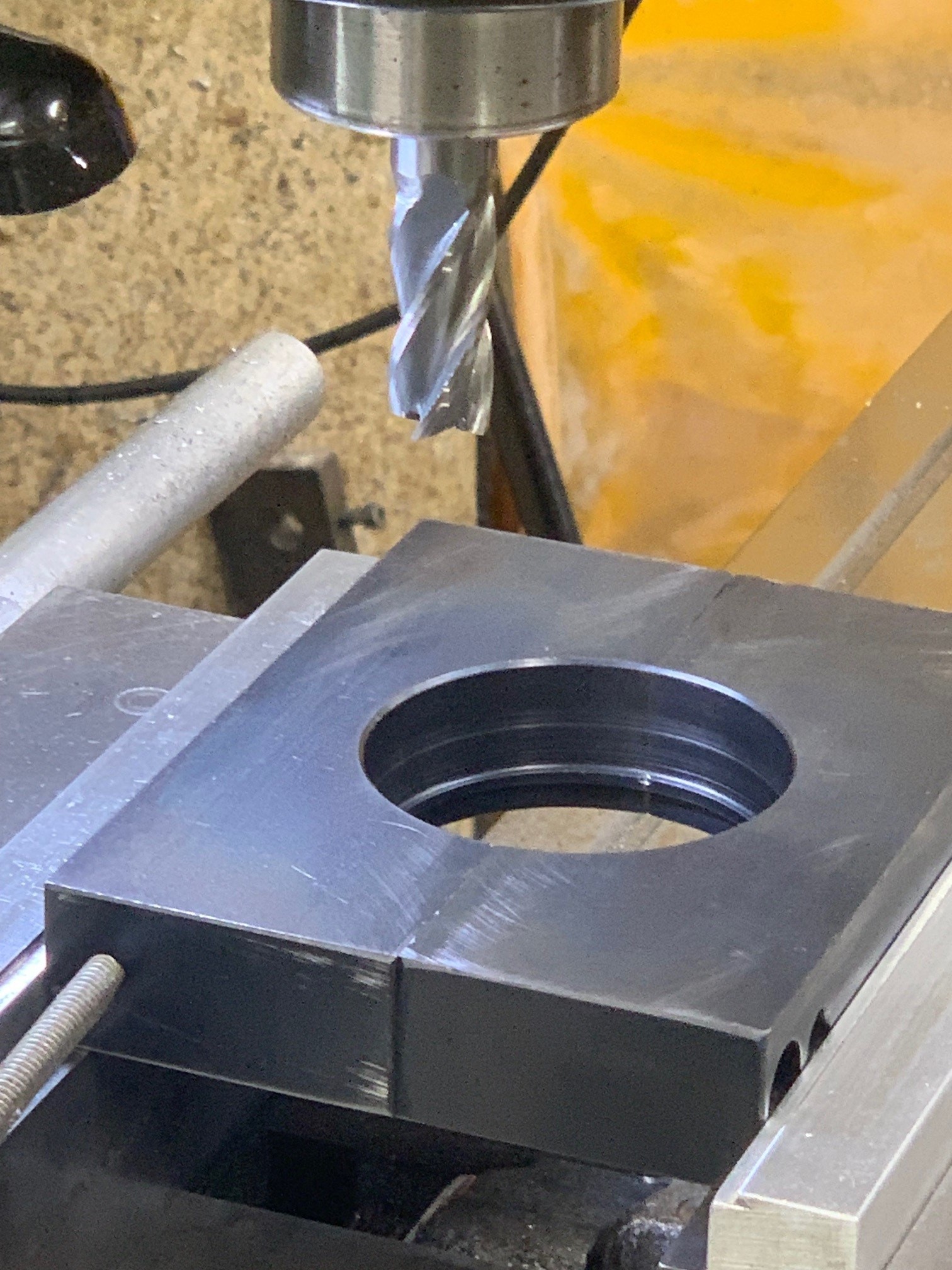

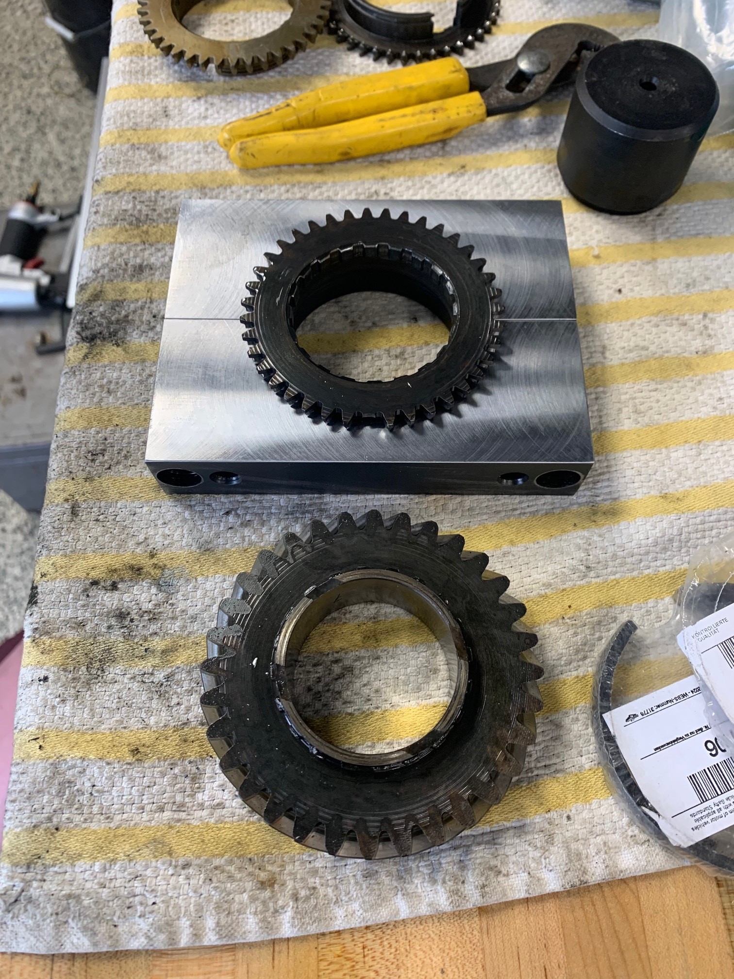

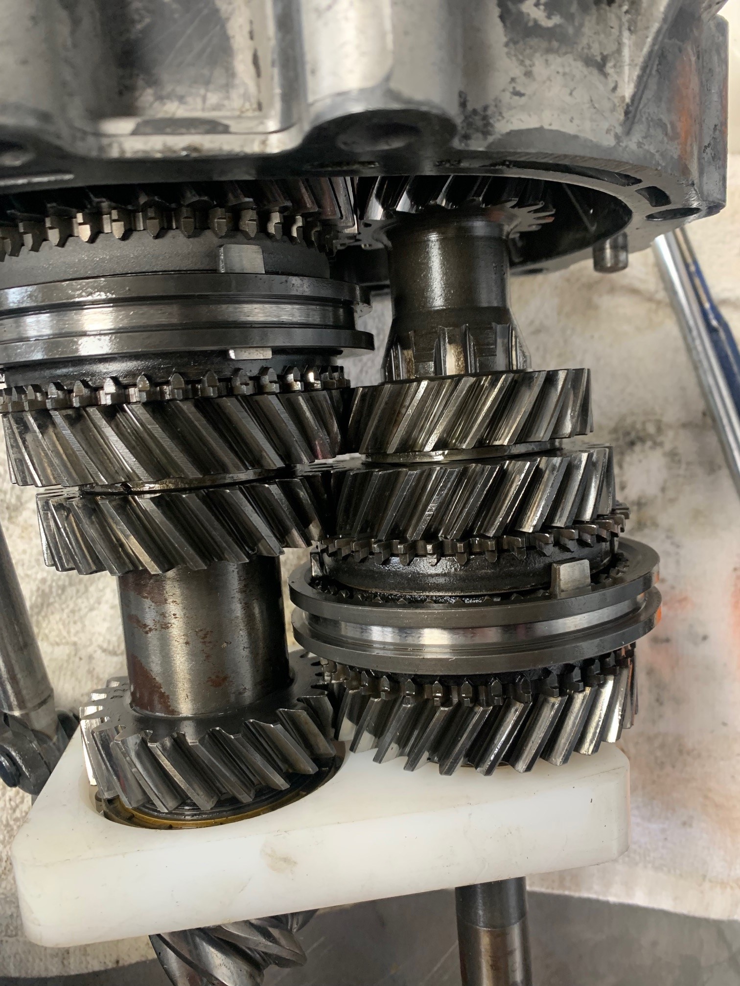

Transmission parts arrived here are some updates:
P226 Tool needed to be re-tooled
Needed to be faced a mil and the ring reduced .33mil
Once the dimensions of the Tool were correct for a 901 box, things started to work with the now correct P226 ****Note the DogTeeth are missing a tooth - never did find it....
New 2nd gear Sync and Teeth!
First Slider was coated with a wax/kosmaline stuff - hard to get off - Brake Cleaner (5 coats finely got it done
