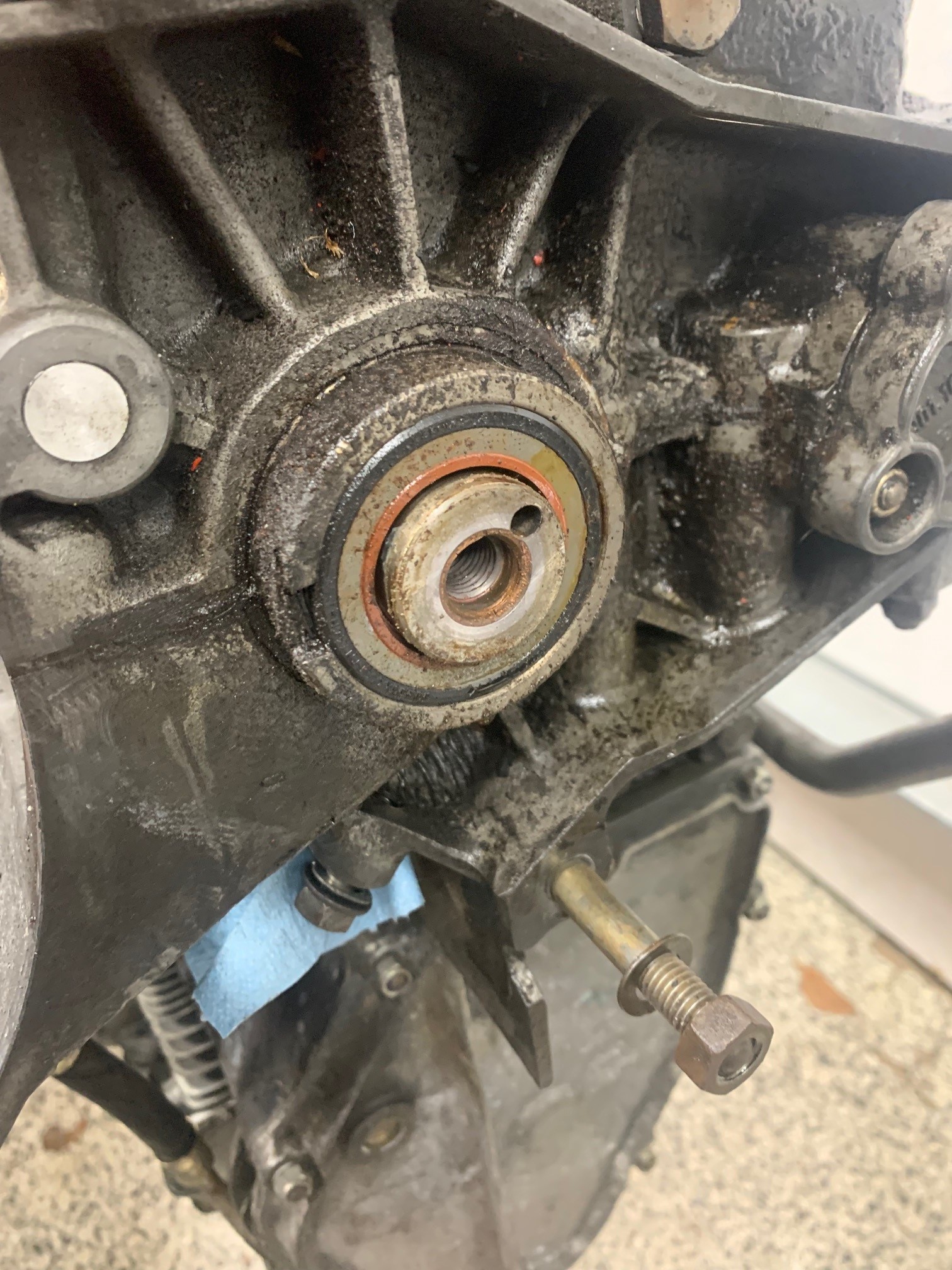

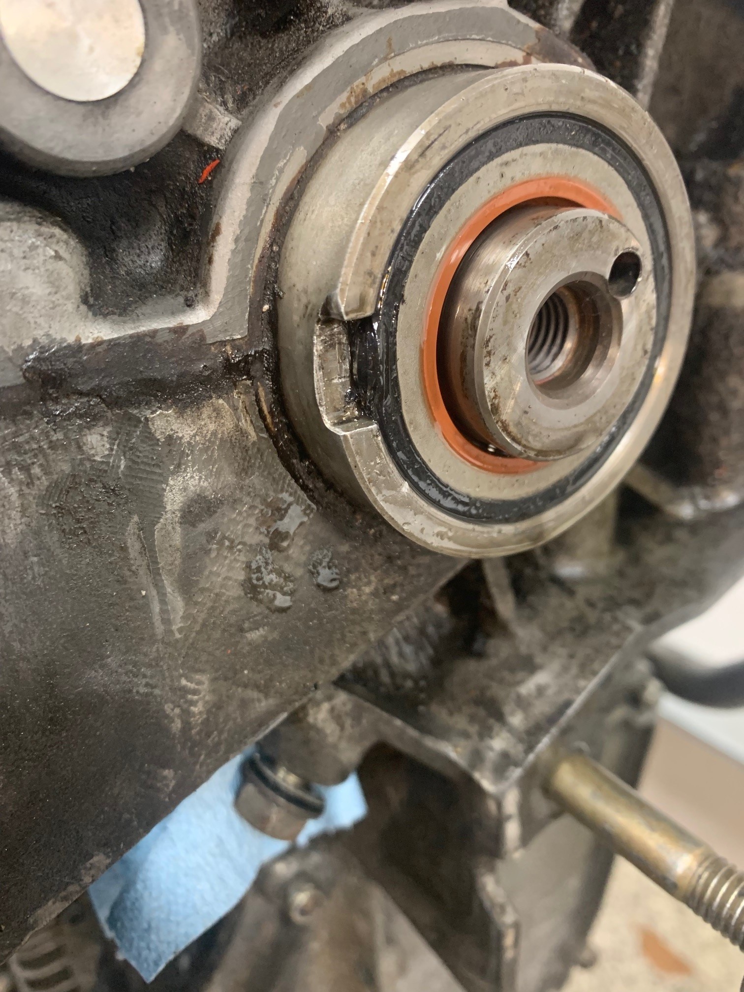

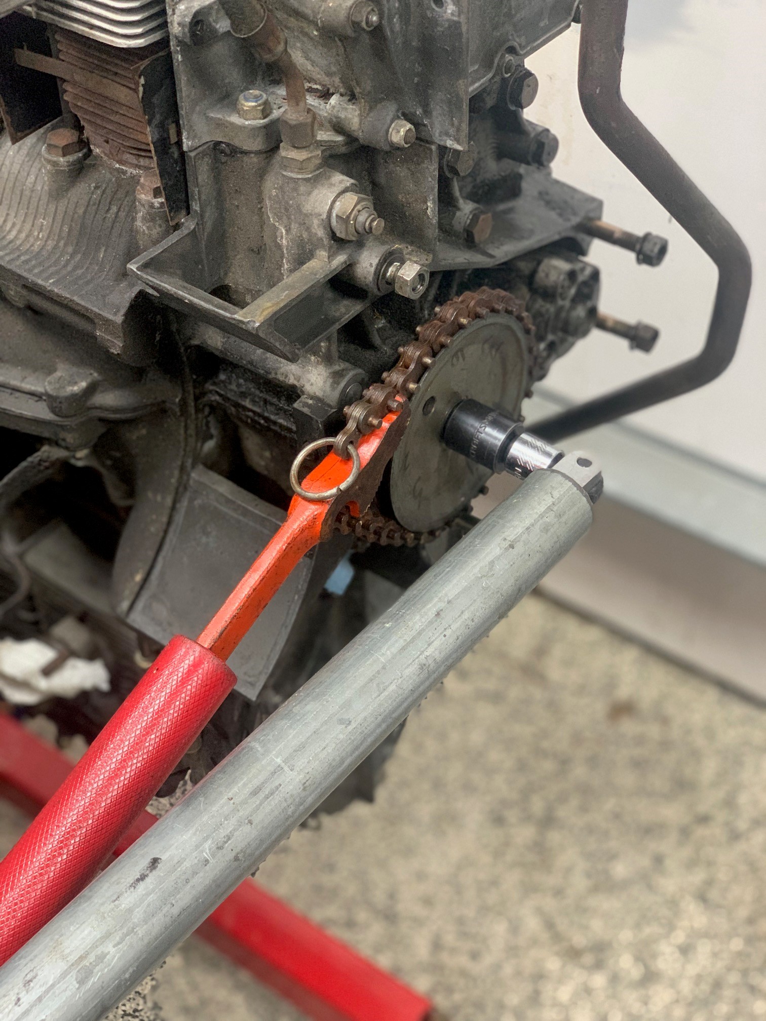

****UPDATE*****
Pulley Seal came, time to remove the pulley, get to use my favorite tool - this one saved me 100 times in the past, holds everything and distributed the counter torque evenly, no mar marks on the pulley.
Hmmmm, not sure the seal is leaky, the triangle of death is/was VERY leaky,
DANG!!!! Caught the lip, will try again when the new seal comes - fortunately there is a $300 version and a $12 version - I bought two of the $12......just in case (IMG:style_emoticons/default/shades.gif)
