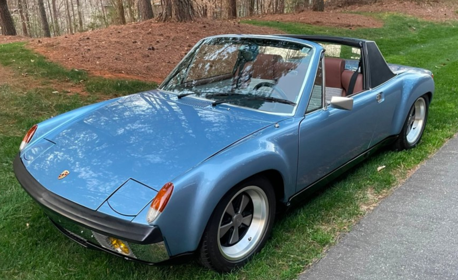

I did a ground up build on a really nice chassis about 22 years ago. It changed hands twice ending up with jerhofer, who took it up several notches. It’ll be fun to watch and see what it hammers at.
Blue wide body 914 6 conversion
