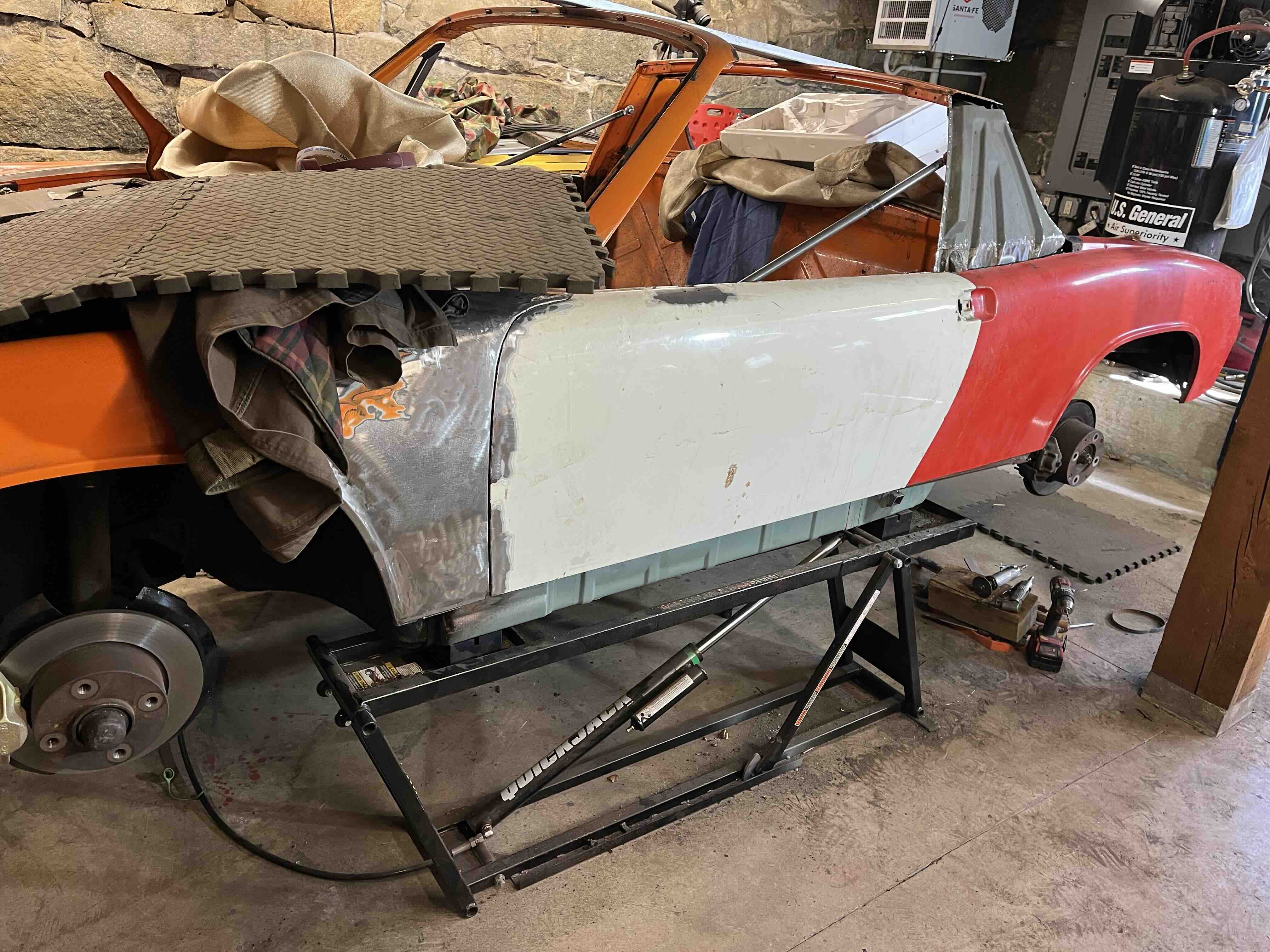

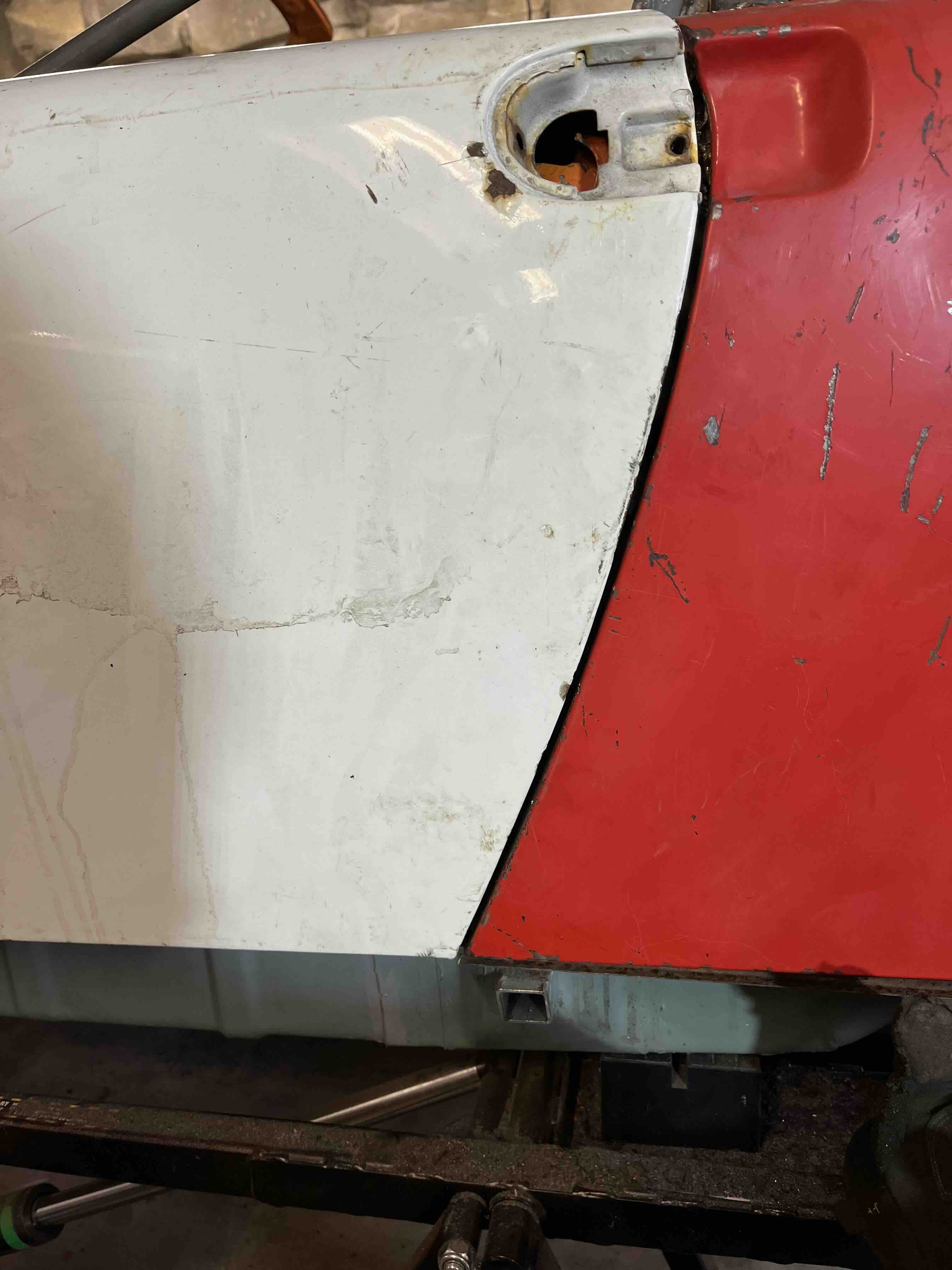

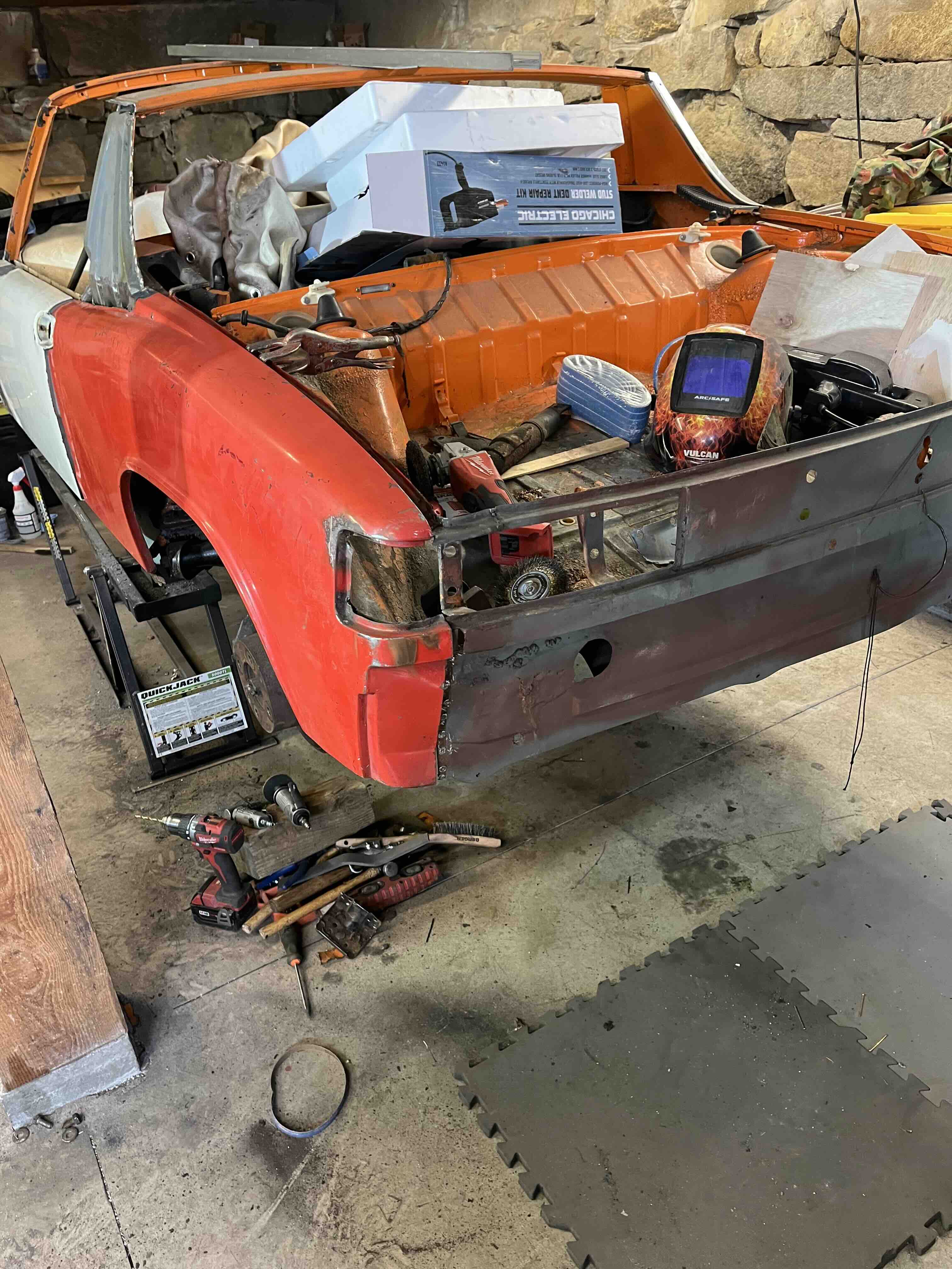

Closing this thread out. I fitted the LH quarter in place and even without any fettling things are lining up near the taillights and the gaps to the driver side door gaps are looking well within tolerances. On to the next challenges!
