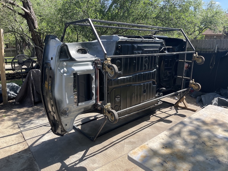

I would like to check the alignment of my trailer arms before I recondition them for the LE. I know there's a Lamont guy in CA that had a jig for 914 trailing arms, which he used to reinforcement the arms. My main concern is the driver side that got hit in an accident long ago. Does anyone know of anyone that can do this check? Tangerine Racing no longer does it and Elephant and PMB provide a reinforcement service. Is there any way I can DIY?

QUOTE(mlindner @ Apr 8 2025, 03:57 PM) *
Why don't you check your alignment first....if good or within adjustment then just add the reinforcement clam shells. Best, Mark
That would normally make sense @mlindner but my car looks like this right now. I guess I could completely assemble everything and check alignment. (IMG:style_emoticons/default/idea.gif) I think I want to tackle this problem before I get the car back on its wheels. All the suspension components are going to get powder coated soon.
