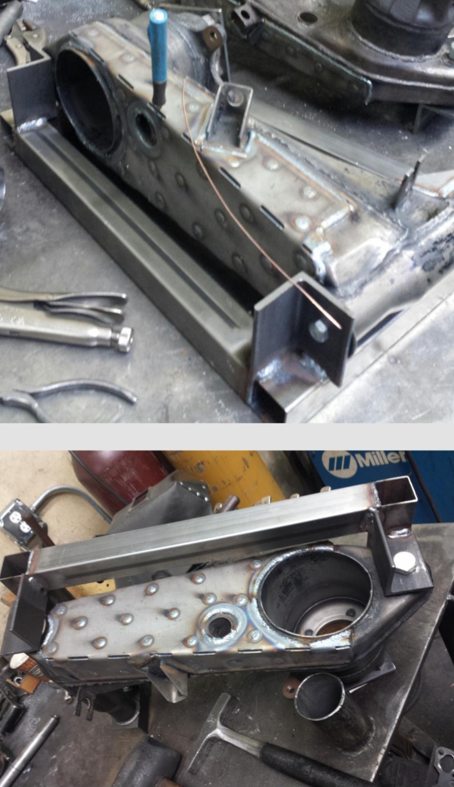

I would like to check the alignment of my trailer arms before I recondition them for the LE. I know there's a Lamont guy in CA that had a jig for 914 trailing arms, which he used to reinforcement the arms. My main concern is the driver side that got hit in an accident long ago. Does anyone know of anyone that can do this check? Tangerine Racing no longer does it and Elephant and PMB provide a reinforcement service. Is there any way I can DIY?

You can always MiG weld a basic steel structure (jig) for checking the Left and Right arms. Of course you will need 2) Good arms to form a 'Correct jig for this purpose. I use ours for reinforcement plate welding>> keeps the arms from deforming.
