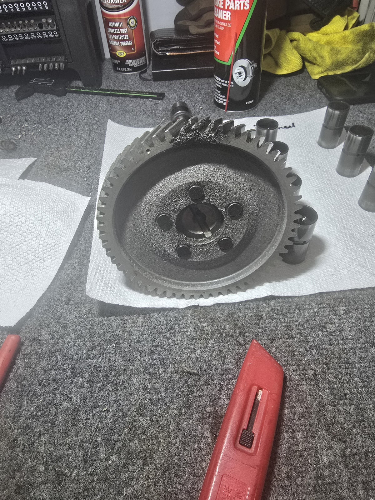

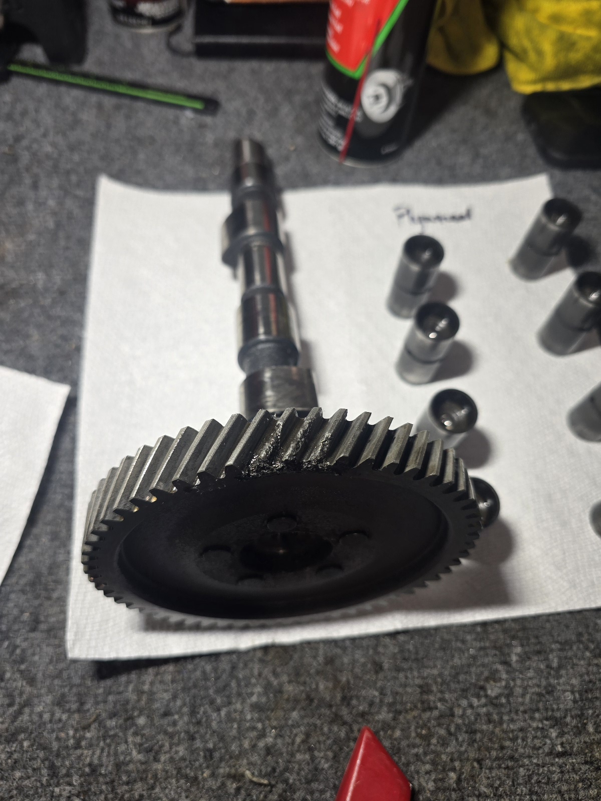

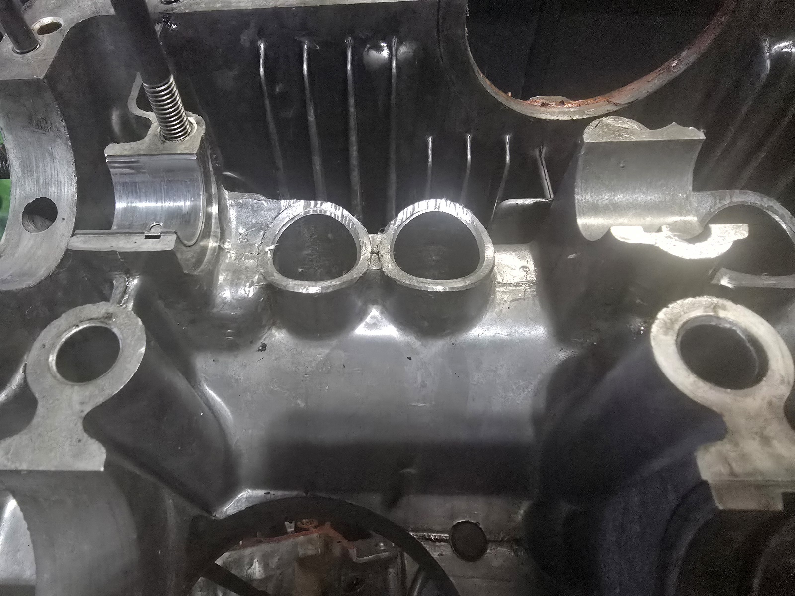

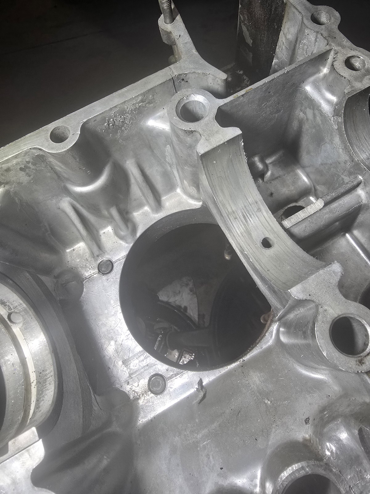

Got back home tonight a bit earlier than expected so of course couldn't wait to get the case apart. I wanted to check the bearings and make sure standard size would work so I could get everything ordered.
As i said before I had my doubts about the story I'd been told by the PO. Allegedly the engine was rebuilt and had 200 miles on it.
The cam gear suffered some kind of horrible damage. For the life of me I'm not sure how that even happens.
The cam showed a good amount of wear. And there was a lot of scoring on the main journals, the bearings and even a decent amount of scoring on the bearing seats of the case. A lot of wear on the lifters, alot of wear on the lifter channels of the case.
I'm going to get the crankshaft inspected. I think it should be salvageable. If not it might be time to think about upgrading to a 2.0 crank and get the case bored out while I'm having the other casework done. Unfortunately that means the motor rebuild is on hold for a few weeks until that's done.

technicalninja   Ouch! Cam gear almost looks burned... Trash ...   Apr 10 2025, 08:39 AM
Vicious   Only MS that I'm completely comfortable with...   Apr 10 2025, 12:57 PM
