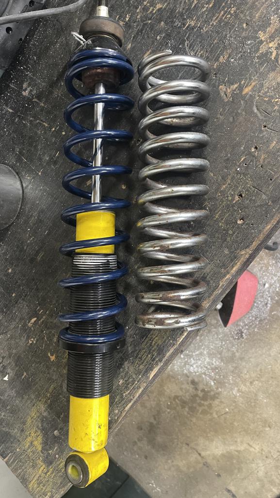

I got the rear springs in yesterday. Massive improvement. For starters the 14" 125# springs don't have any free droop so they don't rattle on the perches, and 125# is a pretty good sport street spring rate. The car came with nice Bilsteins that I never knew were nice because the suspension didn't move.
Here's a pic of the old spring vs the new spring and a link to the springs I used.

How do you like the 14" springs so far? I'm still deciding on weight and length spring to start with and like the idea of plenty of travel. Also how low are you with this setup?
