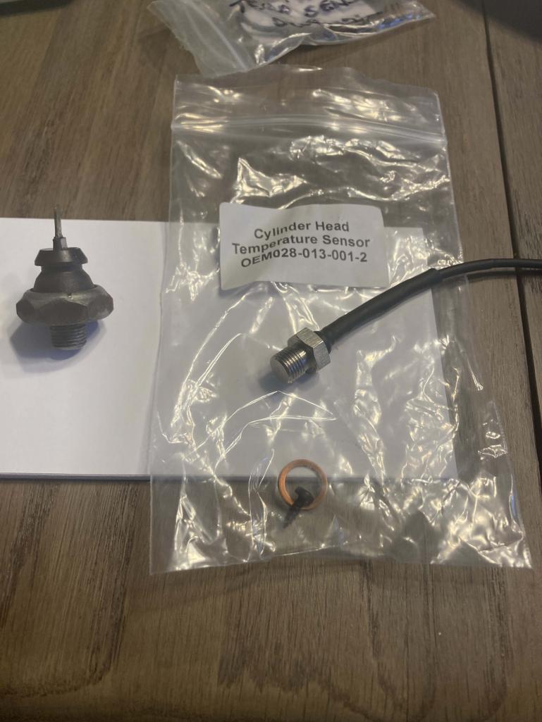

Before I left for AZ I took photos of a couple of parts I have a question about . it of a replacement CHT and what I thought was the original CHT sender .
What is this part ? and is the replacement 012 sender worth installing . I noticed how much bigger the nut is on the old part.I am not sure what the builder of my motor installed an old one or a new one . I think an old one based on the look of the spade connector . I was told this is a must have spare part to carry in your tool kit , and I already know what happens if you unplug it from the ECU connection (the car won't start) so another question ,Which one should I carry with me?

Superhawk996   Part on the left is the oil pressure switch for th...   Apr 11 2025, 04:19 AM
emerygt350   I would hate to be changing the cht sender at the ...   Apr 11 2025, 07:07 AM
Superhawk996   Hopefully what you have installed is the right o...   Apr 11 2025, 08:11 AM
