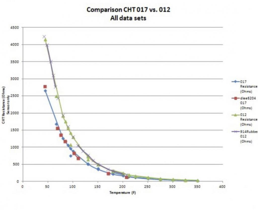

Part on the left is the oil pressure switch for the idiot light.
As a general principle, test parts and don’t replace parts needlessly. It is becoming the new normal that replacement parts are often inferior to the original parts. Measure what you have vs Brad Anders site or the chart below. The chart below has the data for the 012 CHT sensor. If the resistance at couple random points (cold & hot) is OK, keep your new one as the spare.Attached Image

Ron914   Before I left for AZ I took photos of a couple of ...   Apr 10 2025, 06:25 PM
Superhawk996   Part on the left is the oil pressure switch for th...   Apr 11 2025, 04:19 AM
emerygt350   I would hate to be changing the cht sender at the ...   Apr 11 2025, 07:07 AM
Superhawk996   Hopefully what you have installed is the right o...   Apr 11 2025, 08:11 AM
