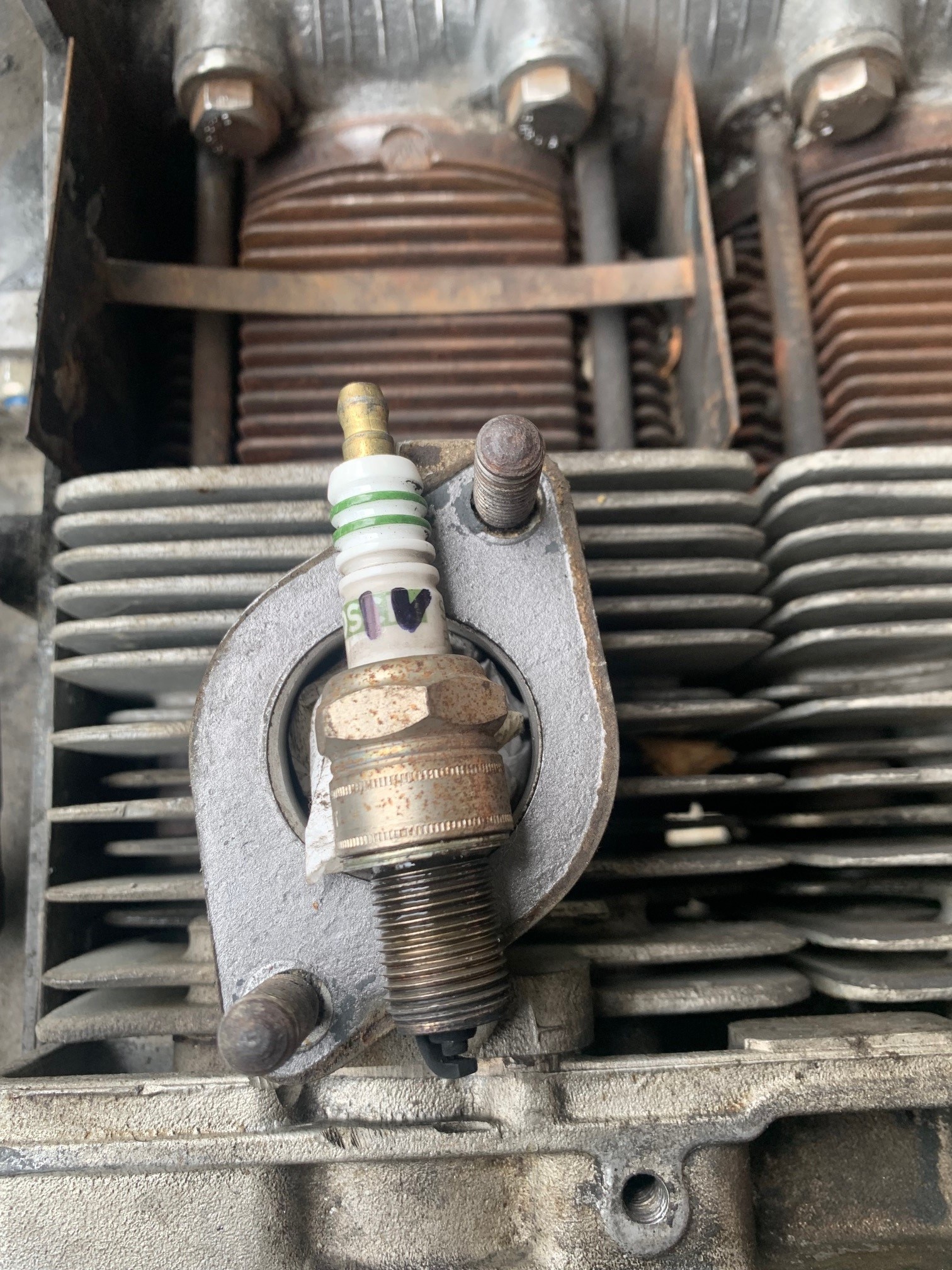

*******UPDATE*******
I pulled the plugs and performed a leak down, all cylinders less than 20%
Compression reading is:
1 - 162
2 - 167
3 - 166
4 - 165
5 - 166
6 - 161
Here are the plugs:

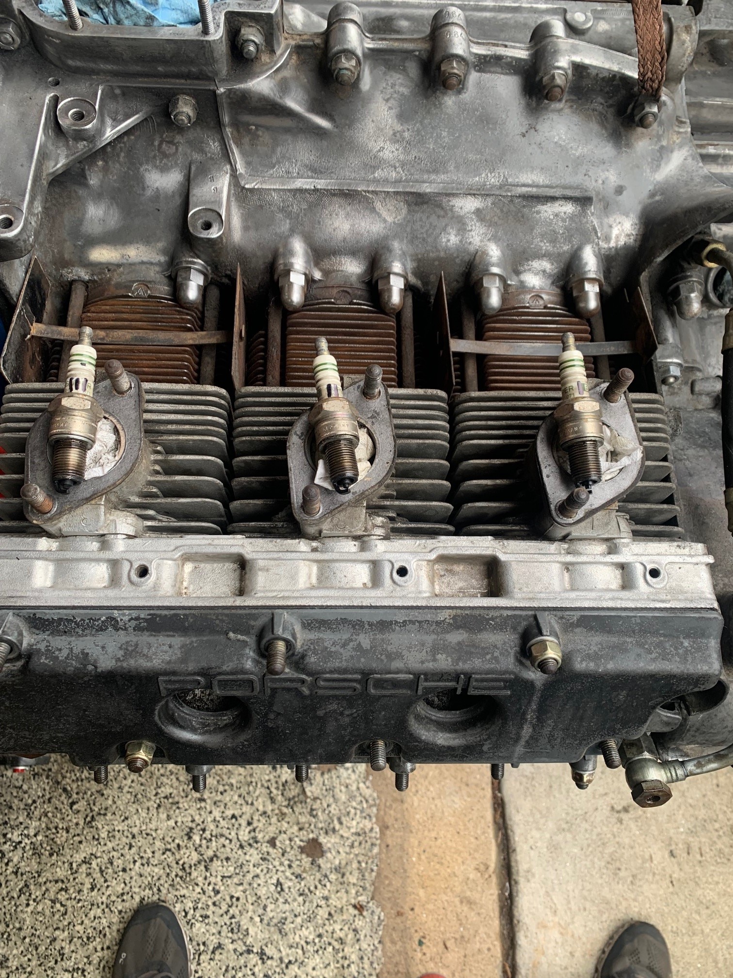

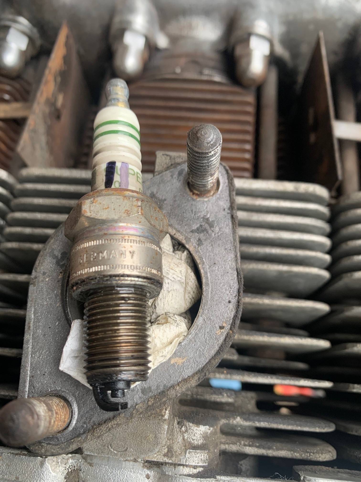

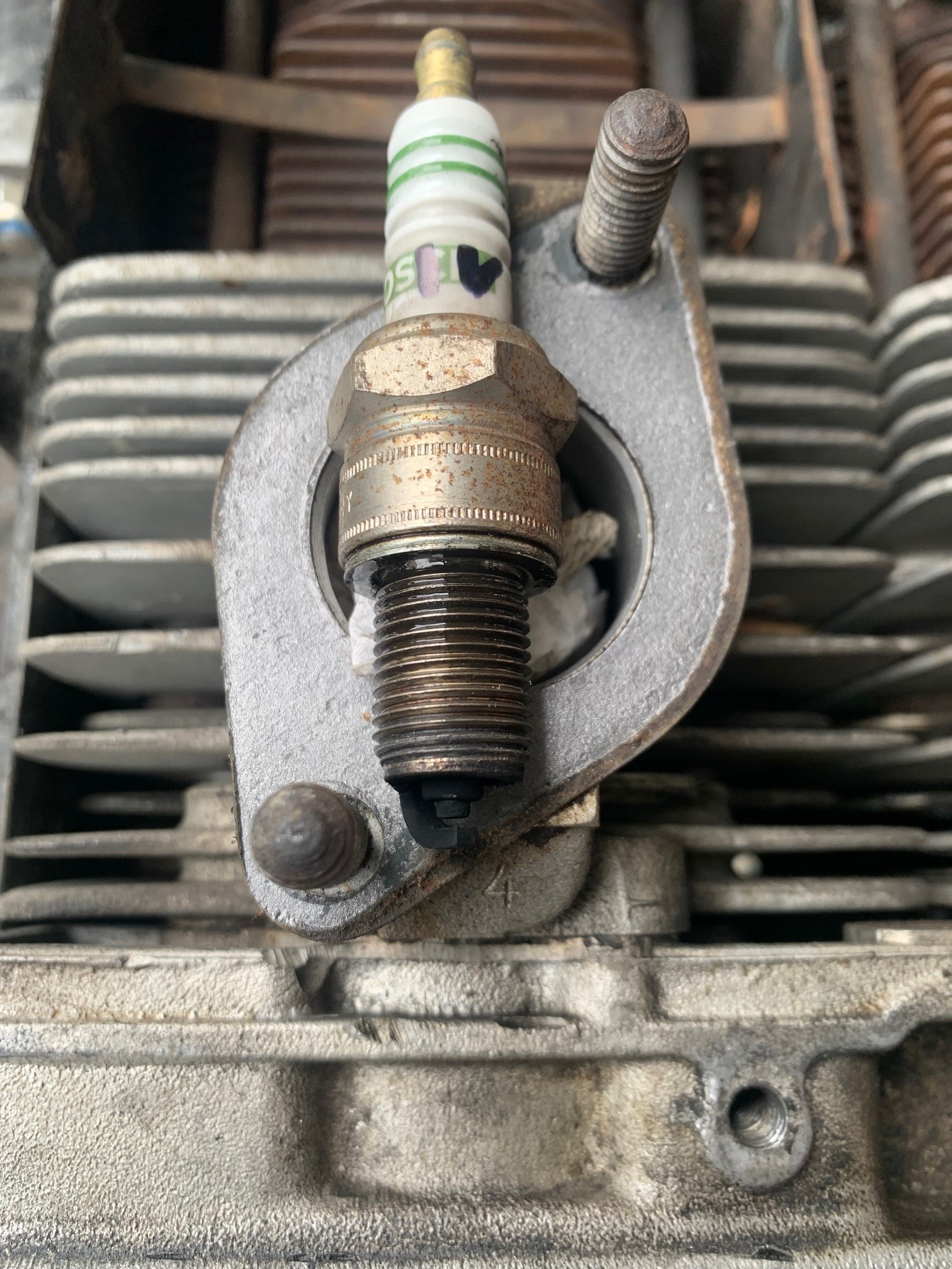

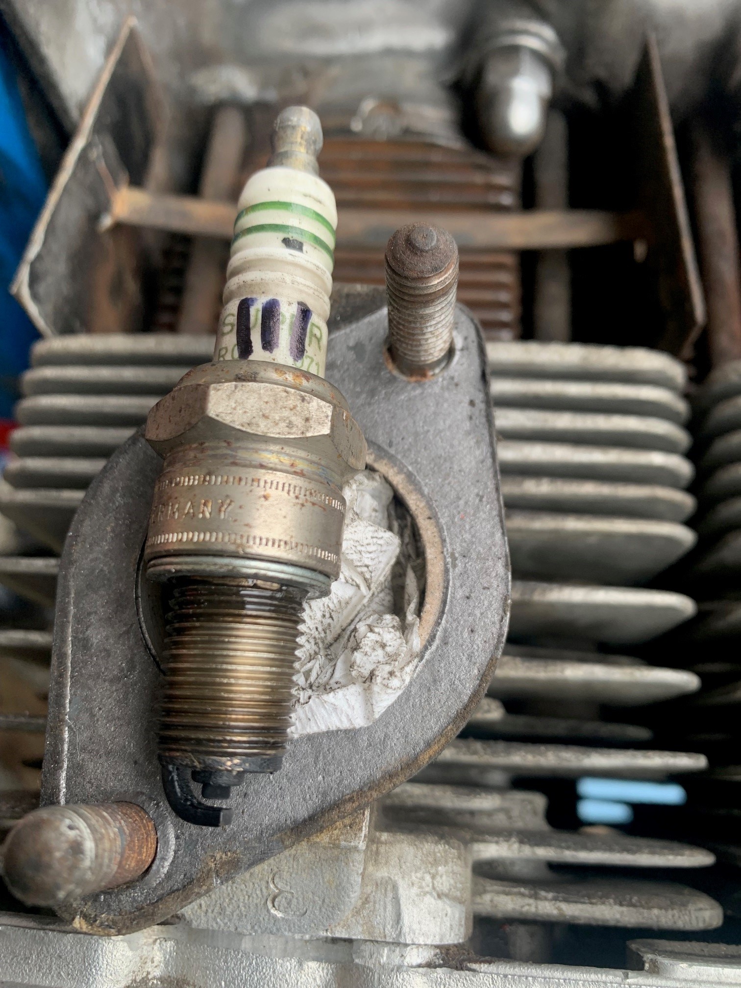

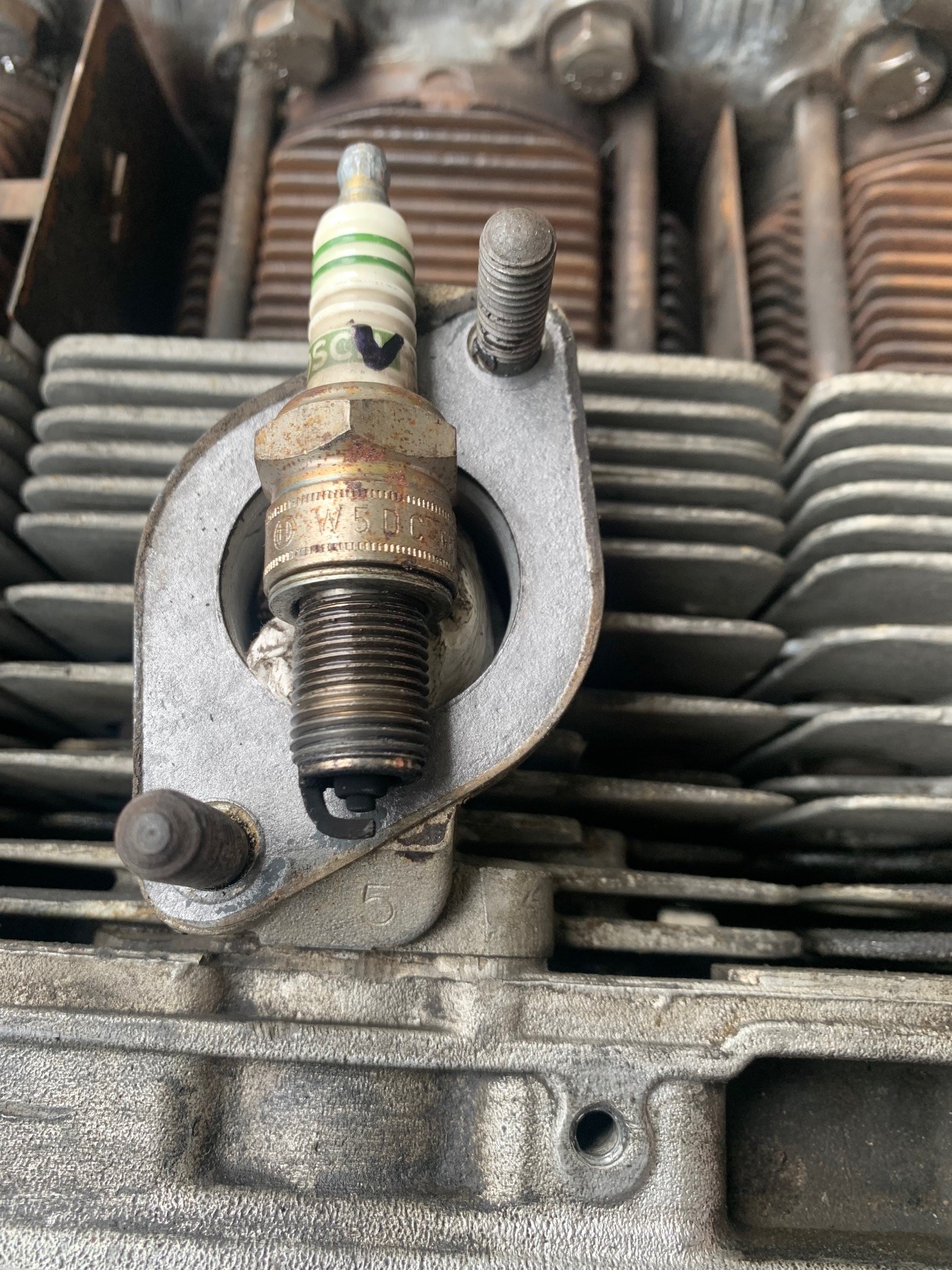

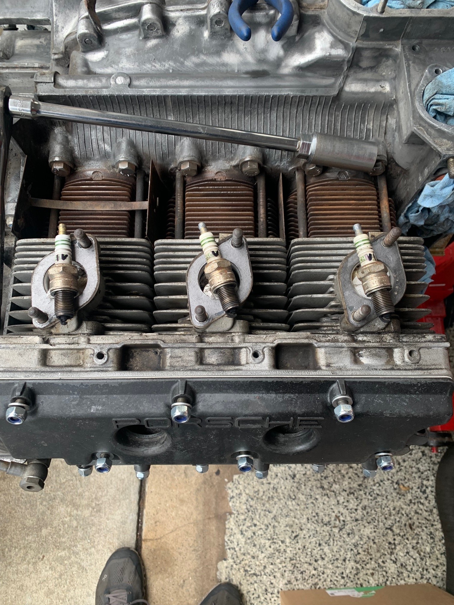

ctc911ctc
post Apr 11 2025, 11:09 AM
Posts: 1,395
Joined: 9-June 18
From: boston
Member No.: 22,206
QUOTE(ctc911ctc @ Apr 11 2025, 11:06 AM) *
1 - 162
2 - 167
3 - 166
4 - 165
5 - 166
6 - 161
Here are the plugs:

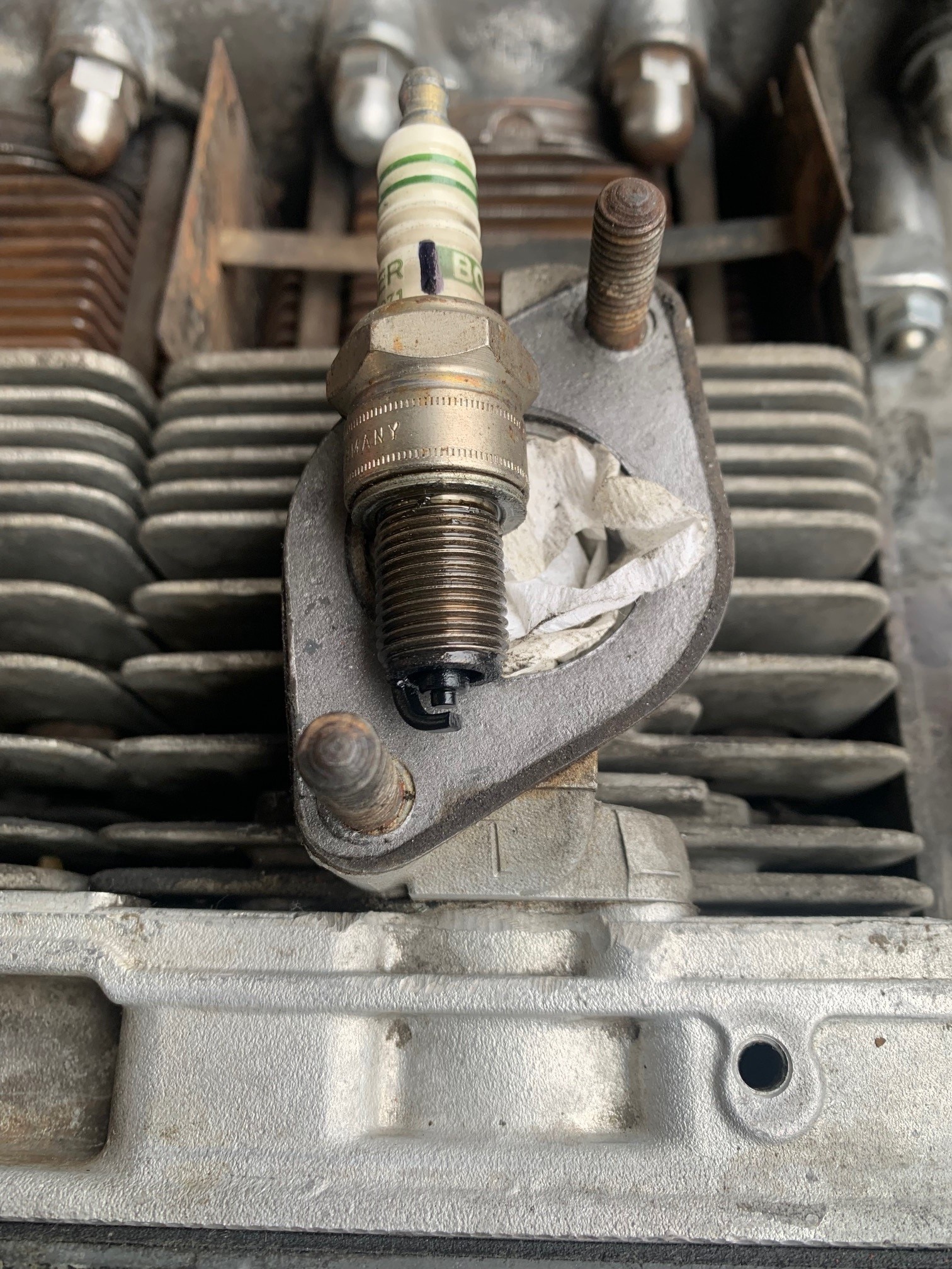

AND the other Side
Looks very rich, any other observations from the Teener Team?
