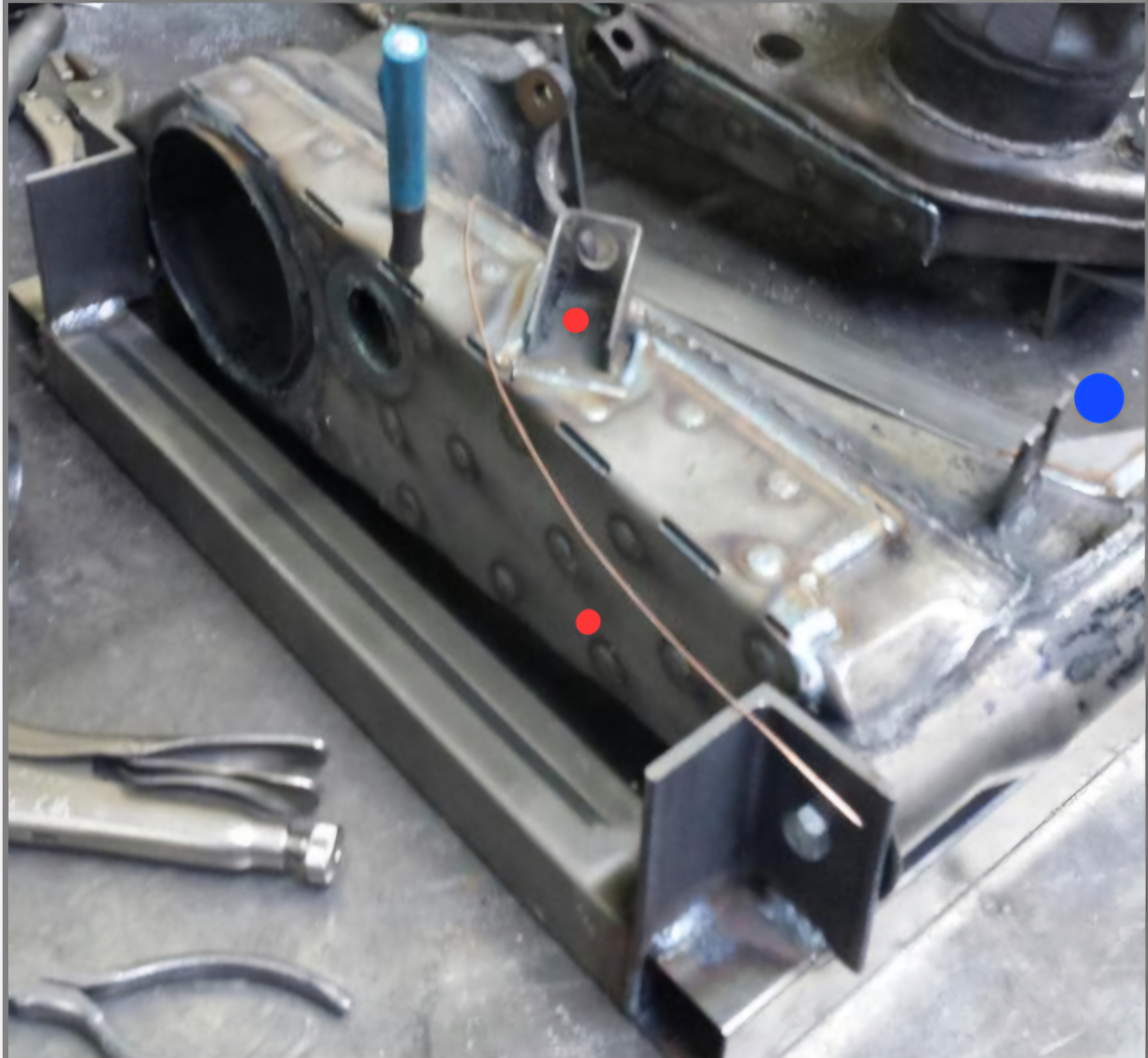

Blue dot if you look close= small .250" ga. (triangular) gusset at the arm + tube. Red dots are where I drilled/welded .750" dia tubes for internal cross-bracing inside the arms.
