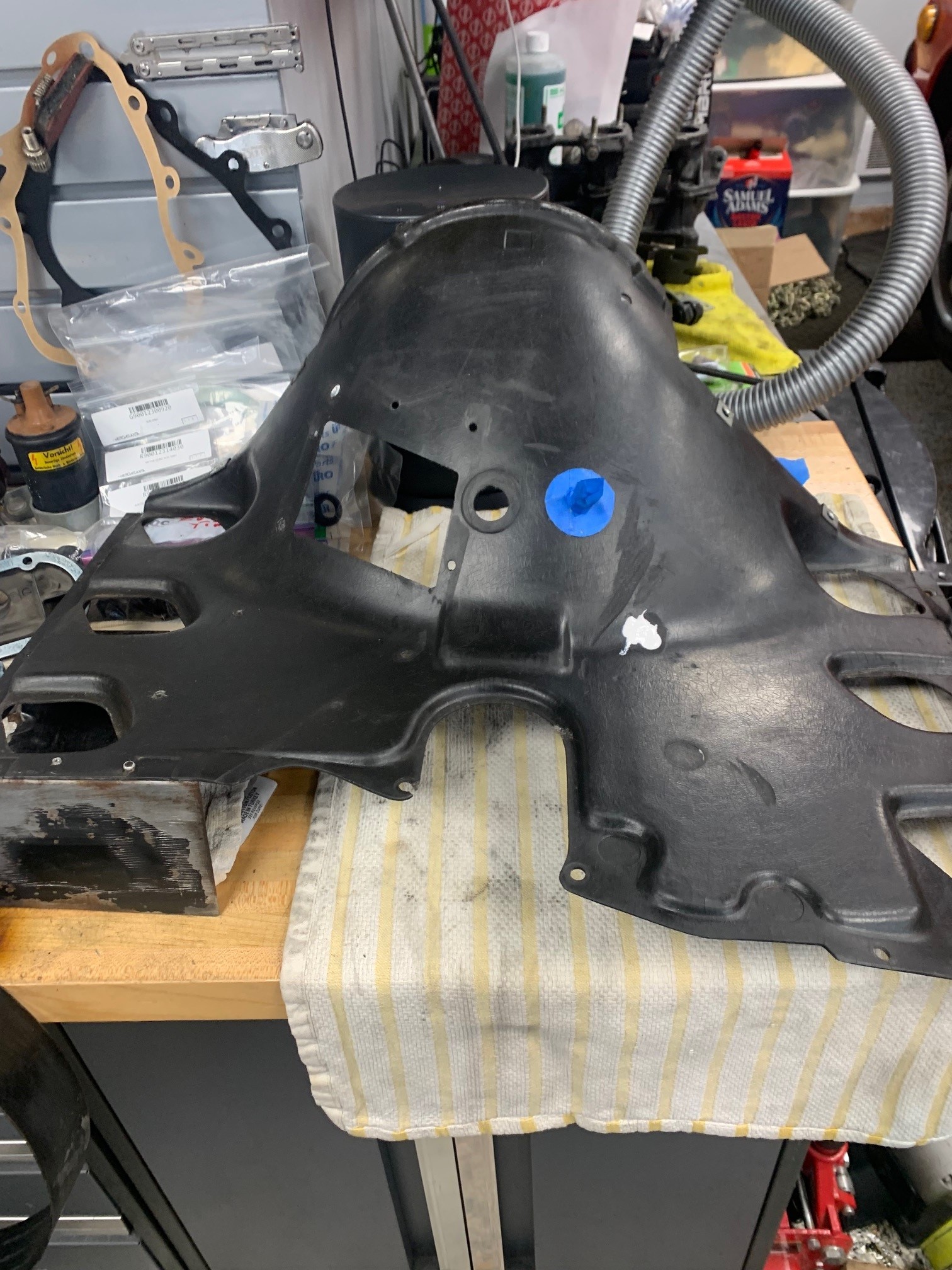

This weekend I have been prepping to put things back together,
There were 2 friction holes on the cowling - not sure what from, filled and sanded

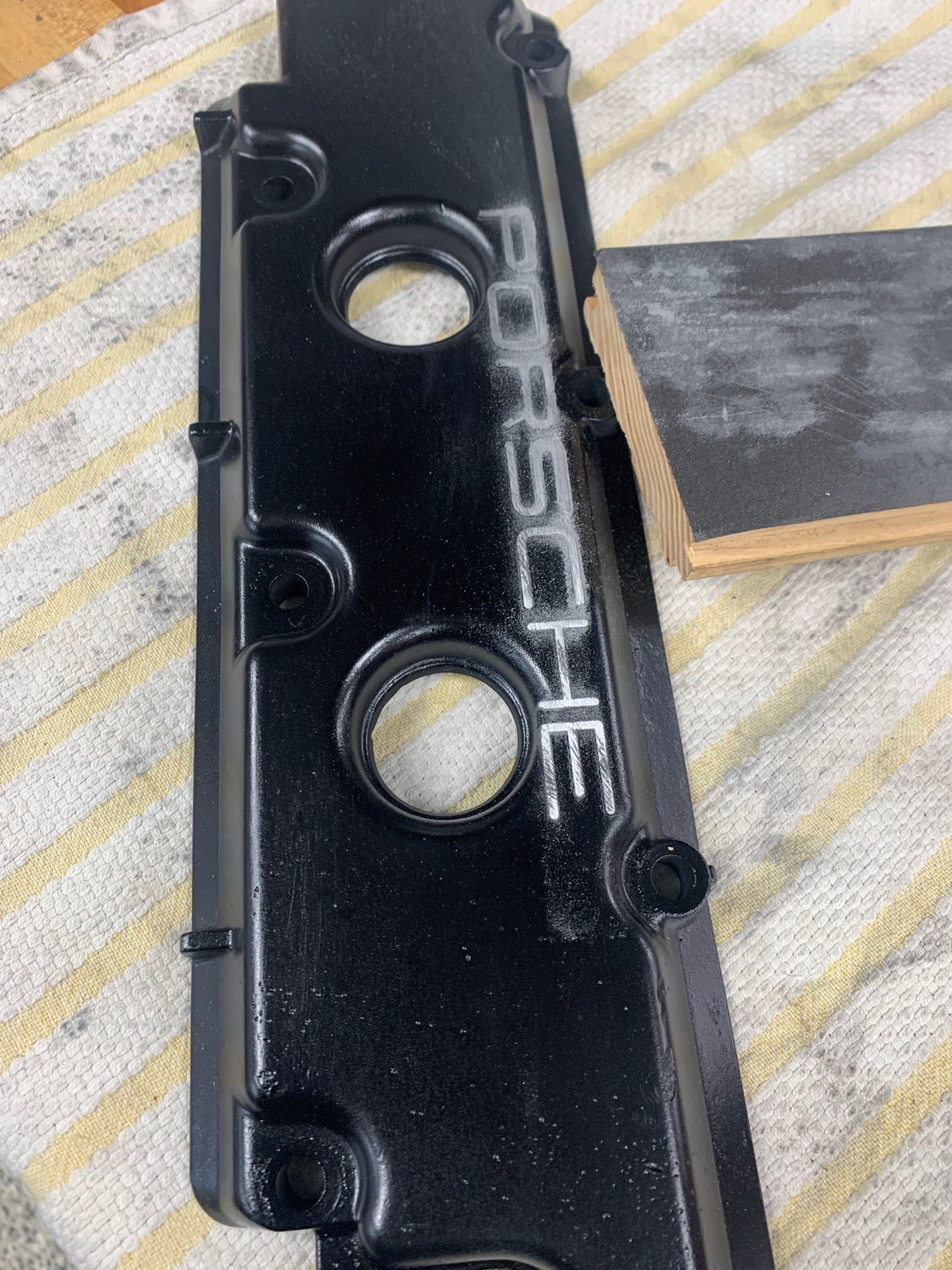

The Cam Box Cover was in tough shape - I painted and then removed the letter paint with a emery paper flat - very flat, block. I saw someone use a mill machine to do the same......talk about tool envy!

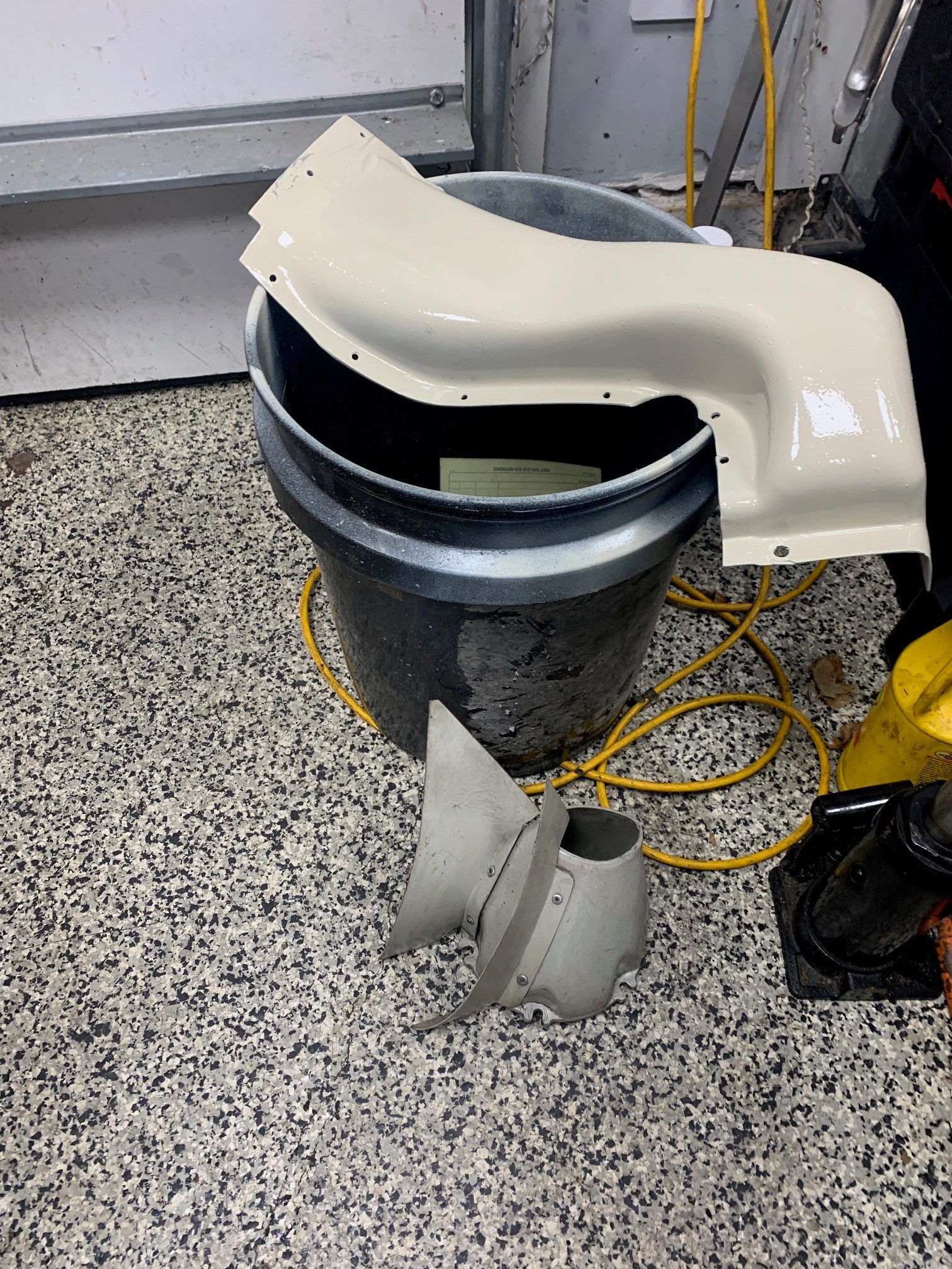

Paint Color is always a topic, I will be keeping all of the original colors, this one is supposed to be a match.....seems ok.......See the original below the freshly painted part.
