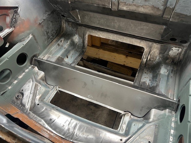

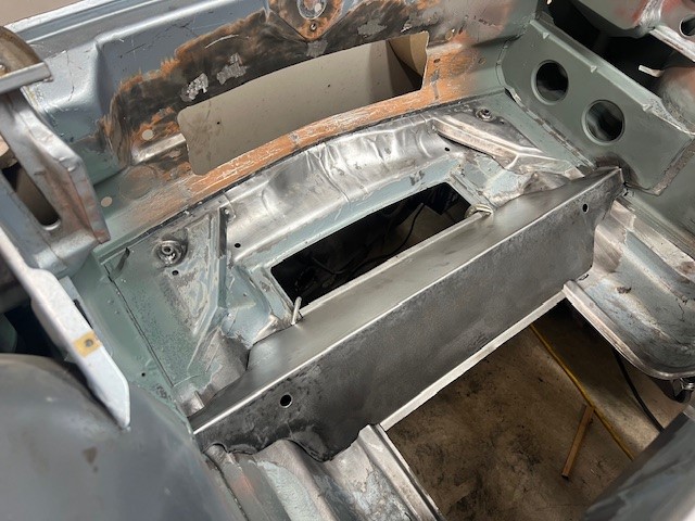

I then made a cross-member to support the bottom of the radiator. I went round and round on the design of this part and the best way to attach this to the chassis. I don't want the final product to look like a cloogey conversion so I'm trying to make the modifications look like they belong in the car to the best of my ability. Not sure I totally hit the mark on this, but I'm satisfied enough.

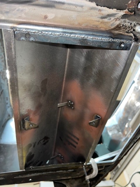

It's a little tricky to tell what you're looking at here, but this is the underside of the radiator support cross member. Since this piece gets in the way of the wires that route from the fuse panel to the headlights/turn-signals/horns, I decided to keep the bottom open so that I can route the wires through this over to the passenger side headlight/turn-signal/horn. I will make some sort of flat cover that attaches to the underside of this so that I can access this area from below the car but still keep the road grime and water out of here. The mounting tabs in the center and welded nuts on either end are for the attachment of this future cover. The sheet-metal tabs are retainers for the wire bundle that will run from drivers side to passenger side (trying to duplicate the factory sheet-metal wire retainers).

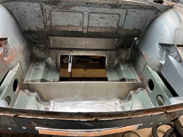

Finally, the cross-member is welded in (not the prettiest welding, my gaps were too big) and I filled in the hole in the front of the frunk floor. I was feeling pretty good about my progress at this point so I invited my wife out the garage so that she could marvel at my work. Her only comment... "when are you going to get to the pretty stuff?" (IMG:style_emoticons/default/dry.gif)

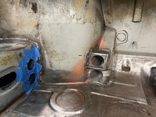

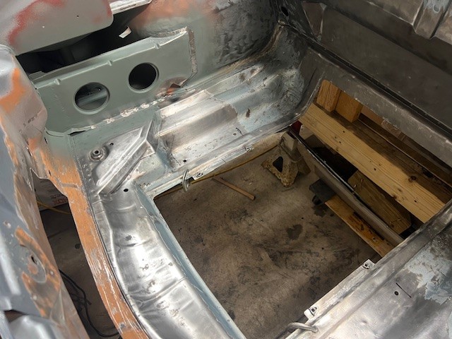

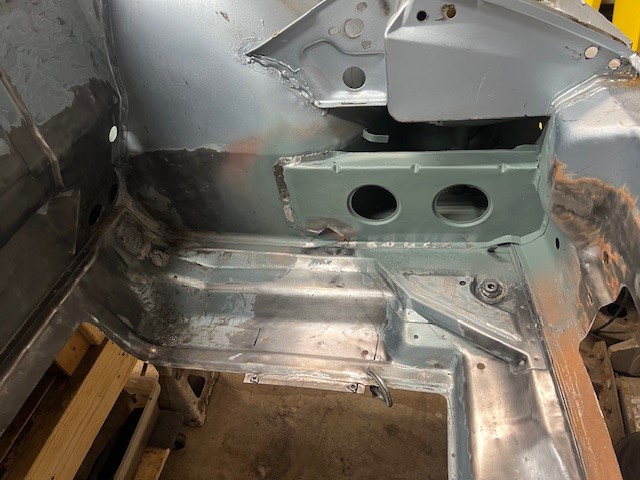

Lastly, the progress on the hose routing... I'm pretty sure I'm going to get some negative feedback on this, but I've chosen to route BOTH coolant hoses through the driver's side longitudinal. Various factors contributed to this decision. I don't like the idea of going under the car (too much chance for damage, IMO) and based on the radiator configuration/location I have, I think this path makes the most sense. Plus, the driver's side longitudinal is currently wide open because of my rust repairs, so this makes it easy to remove the heater ducting and install two individual conduits in there to protect/insulate the hoses and make it easier to fish the hoses through during final assembly or if I ever need to replace them in the future. I plan to make a removable cover that will conceal/protect the exposed hoses in the driver's foot well. I know that having two big, hot hoses right near the driver's seat might make the ride a little warm. I'm really hoping it won't be unbearable!

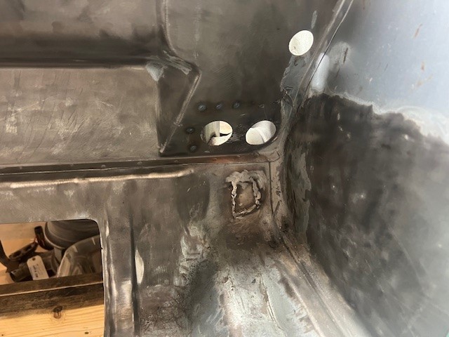

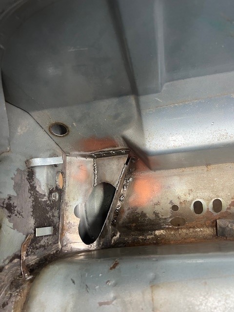

Here is a picture looking down into the area below the gas tank. The two coolant hoses will run in the little cavity that sits right under the torsion bar. The cavity wasn't quite big enough, so I cut it open and flared out the one side so that the hoses could exit next to each other in the frunk. The oval-shaped hole has since been filled in with a domed piece of metal that gives the hoses just a little more room at the bend. I made sure none of this stuff will interfere with the gas tank or the torsion bar.
And the holes in the frunk where the hoses will exit. I'll use rubber grommets at all the holes where the hoses pass through.
