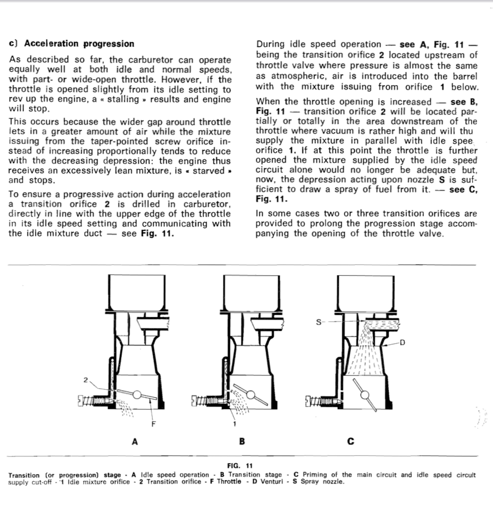

One thing that is critical to tuning IDF’s is to understand the transition ports and that in light throttle / light load you are running on the idle circuit and transition ports more so than the mains.
Take the time to read the Weber tuning manual to get a baseline understanding of the transition ports. The manual isn’t specific to IDF but the principles are the same.
https://www.lainefamily.com/images/WeberTuningManual.pdf
