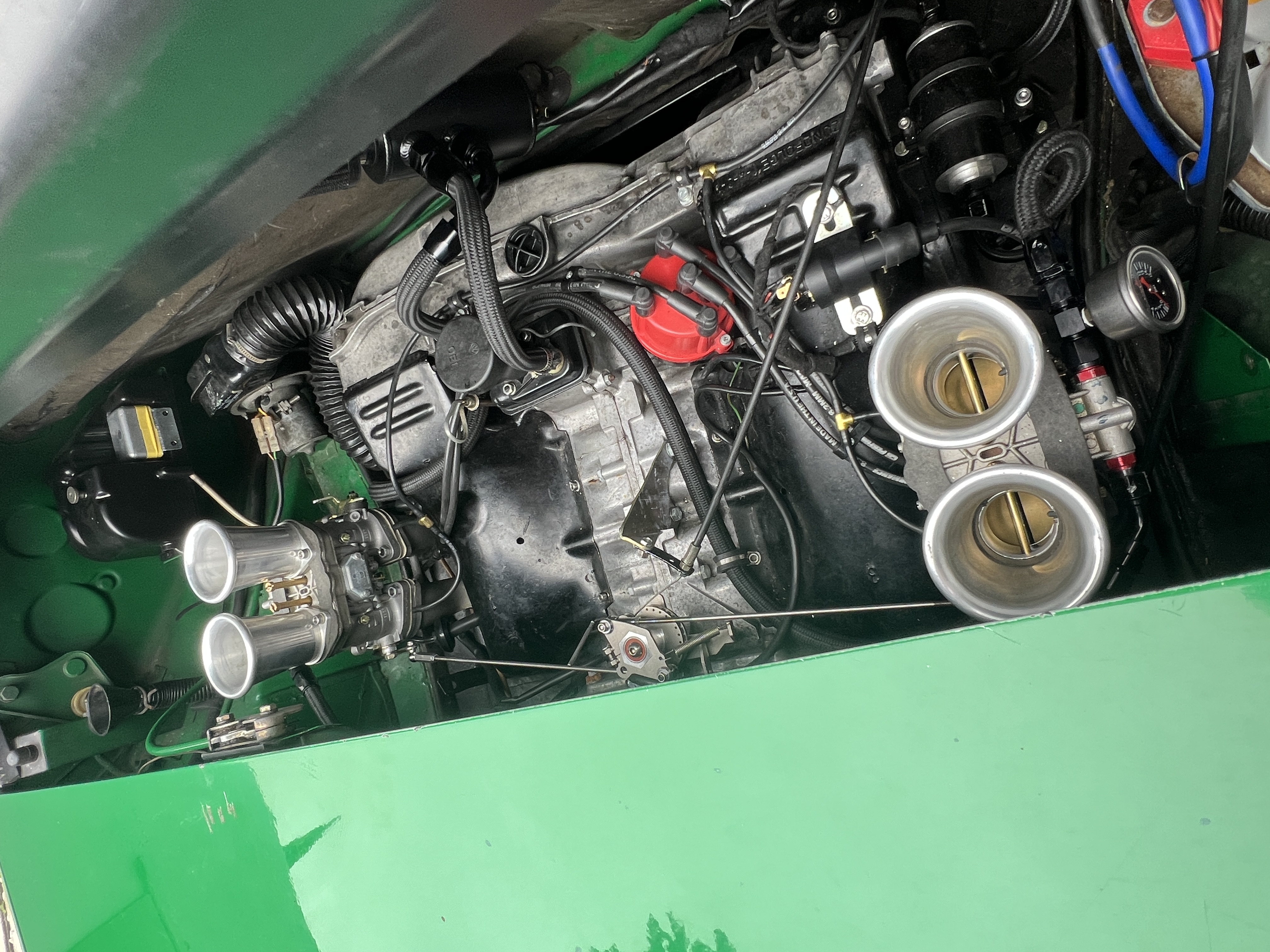

As you I know NOTHING about carburetors and had some similar issues 2 years ago, my mechanic saw the motor and modifications it had, 44mm twin webers cbperformance distributor and my main issue was jetting and high altitude in Mexico City. He recommend cbperformance black box for timing and a Weber update kit (Like black magic) had no more issues with timing, jets or venturies. And the car motor is very happy now. Here is a picture.
