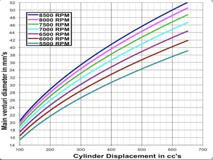

QUOTE(mmichalik @ Apr 20 2025, 09:30 PM) *
Venturi's are 32
Yeah that’s gonna’ suck (IMG:style_emoticons/default/blink.gif) (IMG:style_emoticons/default/lol-2.gif)
Seriously though 28 is going to be better for street drivability and throttle response. 30 is middle of the road, and 32 is way better suited to top end power / high rpm track type use. Personally back when I ran IDF’s I preferred the 28’s. Driveability is a big deal and more pleasant to drive even if that means giving up a little top end HP at redline. Keep in mind the amount of time you really spend at 5000 - 5500 rpm is minuscule.
nditiz1’s recommendation is a very sound stating point.
With the setup you have - not at all surprising you’re not a happy camper.
Here is the standard venturi selection chart that has been around for a long time that came out of one of the aftermarket Weber tuning books or something like that (ie not my data). Keep in mind this chart is for Horsepower - not optimum drivability. Attached Image
