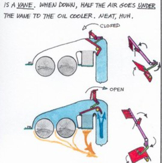

I was asked my a member helping me with my high idle /vacuum leak problem how I currently have it hooked up .This is the diagram I am using .

“ I assumed the thermo would pull them if working.”
The thermostat expands when hot - releasing tension on the cable - allows flaps to open. This is a fail safe - if the cable breaks - the flaps default open.
Double check against diagram above

Superhawk996   “ I assumed the thermo would pull them if w...   Apr 23 2025, 08:57 AM
