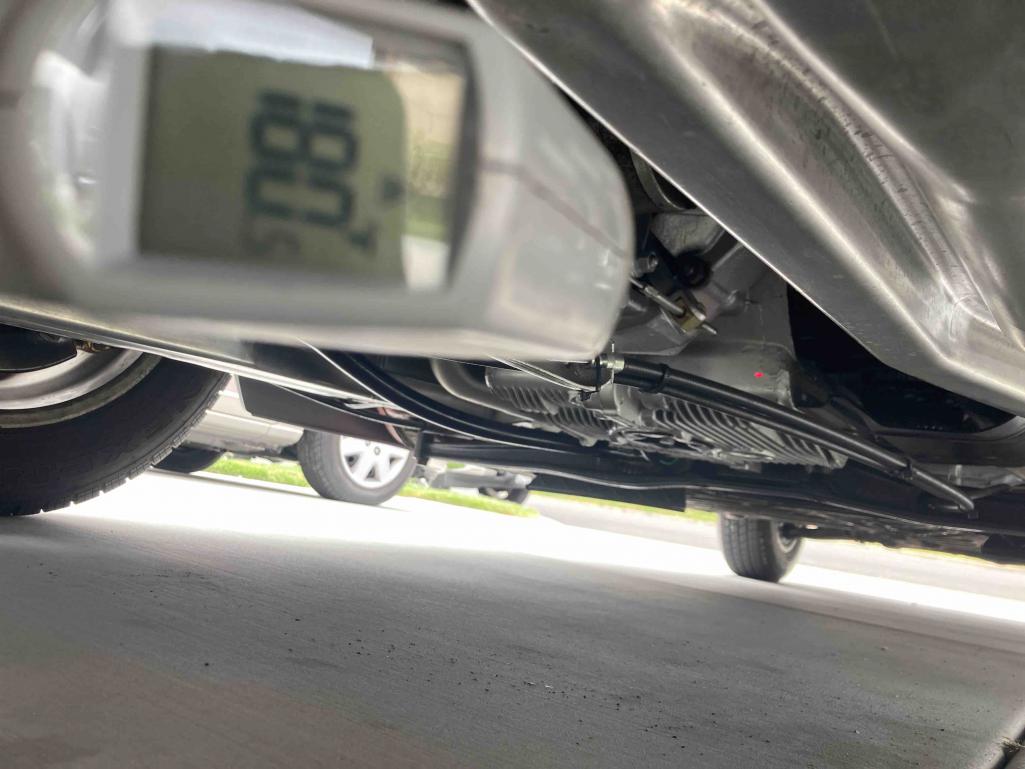

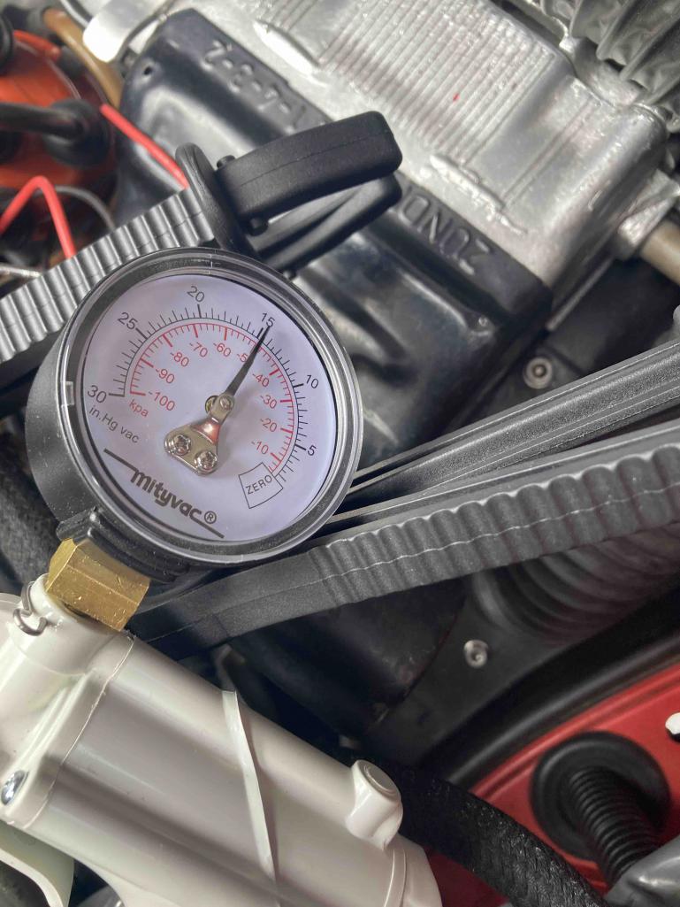

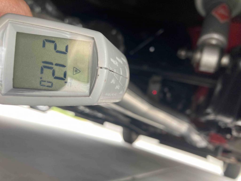

I pulled my car out this morning and started over .
1) First I disconnected the 3 hoses going to my plenum except the MPS . Well I actually do have the MPS disconnected here and connected to the Mityvac , I tried to hold 19inhg but it bleeds off quite fast to around 9-10 inhg so I reconnected to the MPS because I could not get the car to start. I also disconnected the retard hose going to the TB and I am using that hose to read the vacuum of the plenum .
Idling apx 1100 I am showing 13-15inhg of vac on the plenum , motor is hunting 11-1300rpm. and plenum vac is fluctuating
2) after I played with the dizzy to get car started I got it idling about 1000rpm (but it was hunting ) I set the ECU knob to 9:00 position , and let it warm up until the AAR closed.
3) that resistor I bought from AA is no longer in the CHT circuit .
4) Checked the CHT and block with my infrared thermometer.
Lettingf the car cool down and will see if it will start again with out moving my dizzy.
The motor is hunting a lot ,doesn't seem right .
I feeling I should send my throttle body to Mark to be rebuilt and in the mean time I believe Bruce might have one I can borrow . @bdstone914

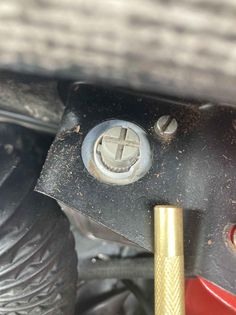

Ron914   Before I left for AZ I took photos of a couple of ...   Apr 10 2025, 06:25 PM
Superhawk996   Part on the left is the oil pressure switch for th...   Apr 11 2025, 04:19 AM
emerygt350   I would hate to be changing the cht sender at the ...   Apr 11 2025, 07:07 AM
Superhawk996   Hopefully what you have installed is the right o...   Apr 11 2025, 08:11 AM

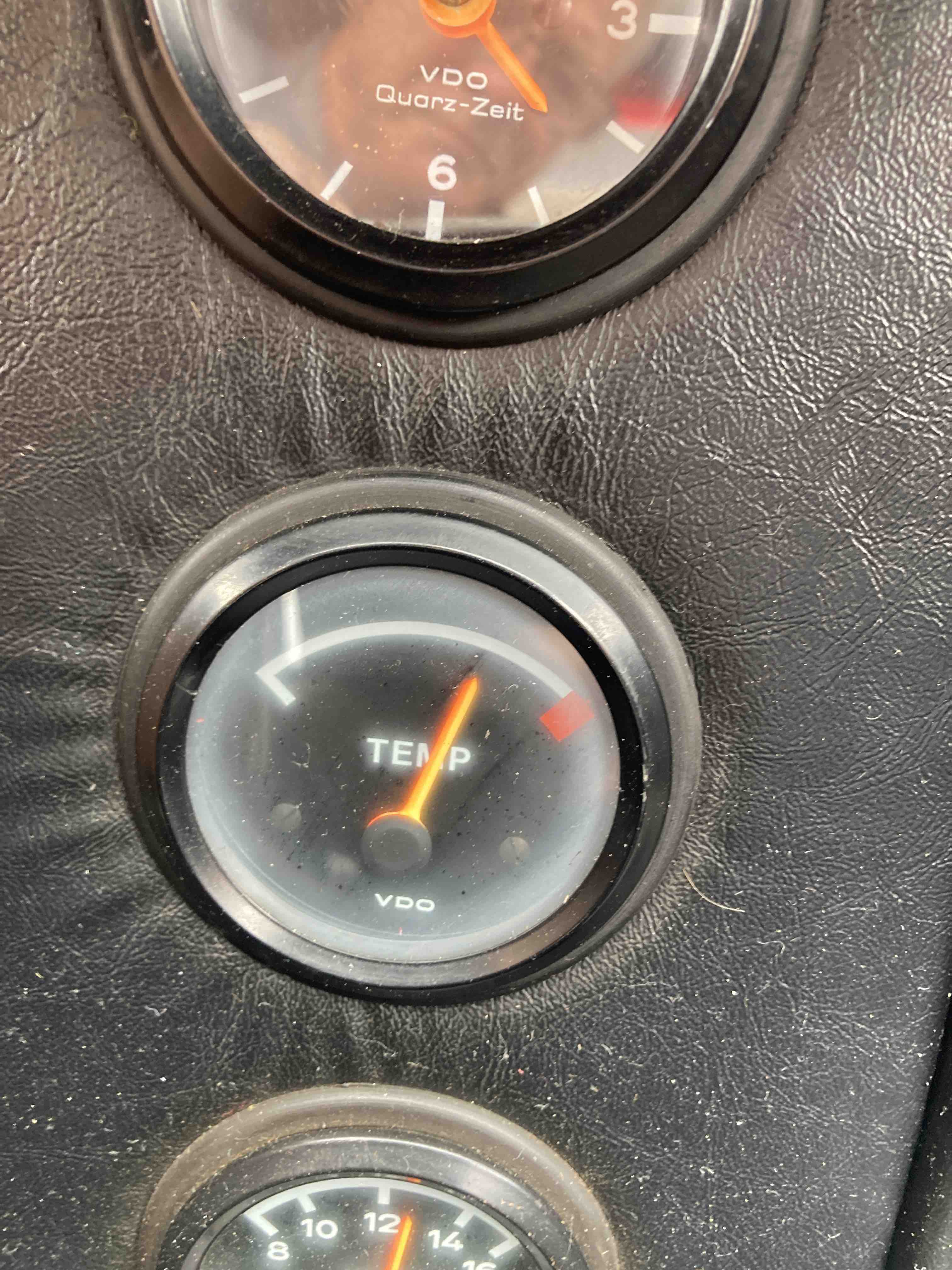

Ron914   Hello Emery, Finally had time to look at my car t...   Apr 22 2025, 08:42 PM
emerygt350   Definitely don't use the retard till you are g...   Apr 23 2025, 06:09 AM
emerygt350   The more I think about the more I suspect your diz...   Apr 23 2025, 06:15 AM
Superhawk996   :agree: Gauge measures oil temp. Vehicle shoul...   Apr 23 2025, 07:38 AM
Ron914   I was probably idling and driving 30-40 minutes. I...   Apr 23 2025, 07:58 AM
Superhawk996   “ I assumed the thermo would pull them if w...   Apr 23 2025, 08:57 AM

Superhawk996   MPS should not be bleeding down noticeably Redo ...   Apr 24 2025, 01:44 PM
