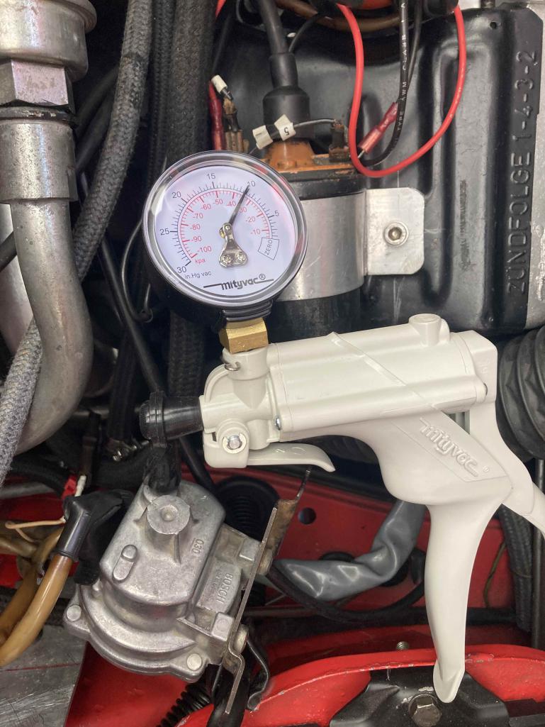

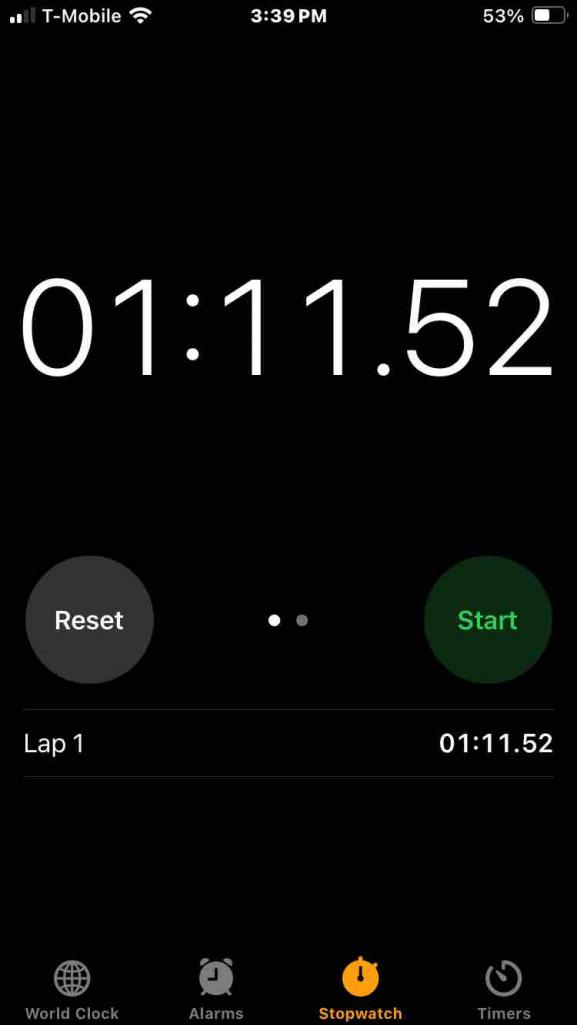

MPS should not be bleeding down noticeably
Redo - make sure you have tight hose connections to Mighty-vac.
Continued leakage means MPS diaphragm cracked or bad seals / gaskets but cracked diaphragm is by far the common failure.

QUOTE(Superhawk996 @ Apr 24 2025, 02:44 PM) *
Phil, @Superhawk996
I was told by Bruce only pull 10inhg on my MPS so I did that and set my stopwatch .
I pulled 10inhg vac on my MPS and timed it. It took apx. 1:12 seconds to bleed down to 5inhg and about 2:30 to zero inhg vac. does this show a bad MPS and part of my problems getting my new motor to run properly?
