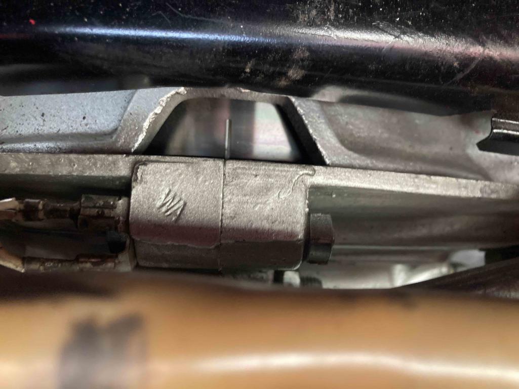

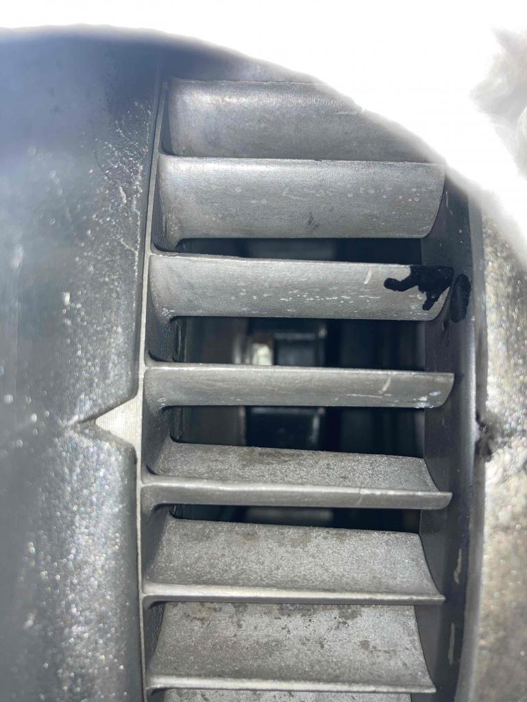

@emerygt350
I decided I need to get my priorities in order and quit beating my head against the wall .
I jacked my car up on drivers side and put in 5th gear and turned my wheel until the only timing mark I know of showed up on my flywheel .
This the what I see in my fan housing view hole . no mark in the V I remember when I installed this that there was one mark only a red O.
I am going to use this flywheel mark assuming it is TDC and check my valves first .then try my timing by using this mark on the flywheel.
Thoughts?
Not sure why I put that sharpie mark on the fan blade or why the red O does not show up in the V .
