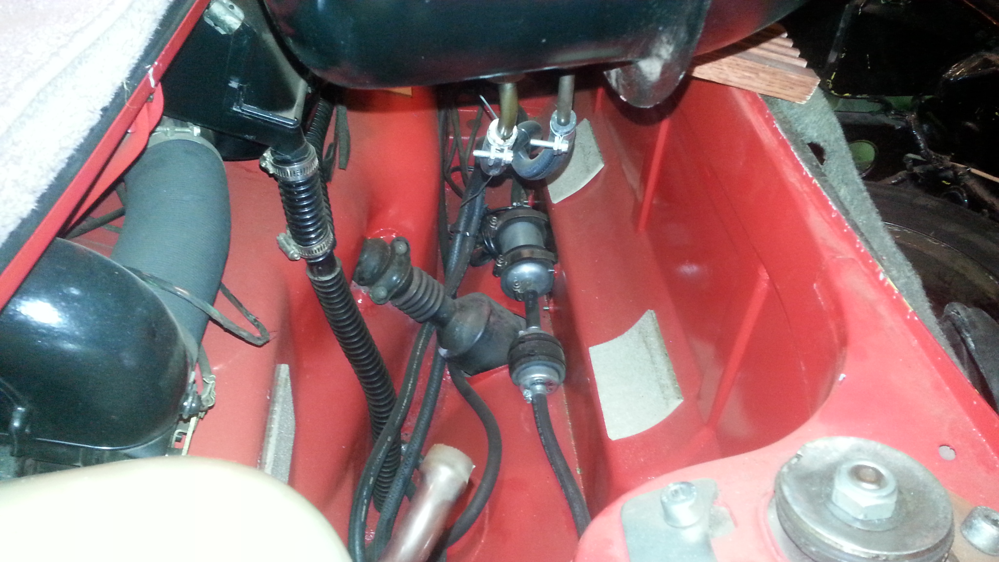

Jerry ![]() ![]() ![]() ![]() ![]() Group: Members Posts: 7,284 Joined: 29-October 04 From: Allentown, PA Member No.: 3,031 Region Association: None
When I moved the FP to the front I looped the hoses to/from the tank to allow complete removal of the tank w/o disconnecting hoses. Hoses do not kink and I welded the access hole closed since I didn't need it.
Attached thumbnail(s) Attached image(s)
