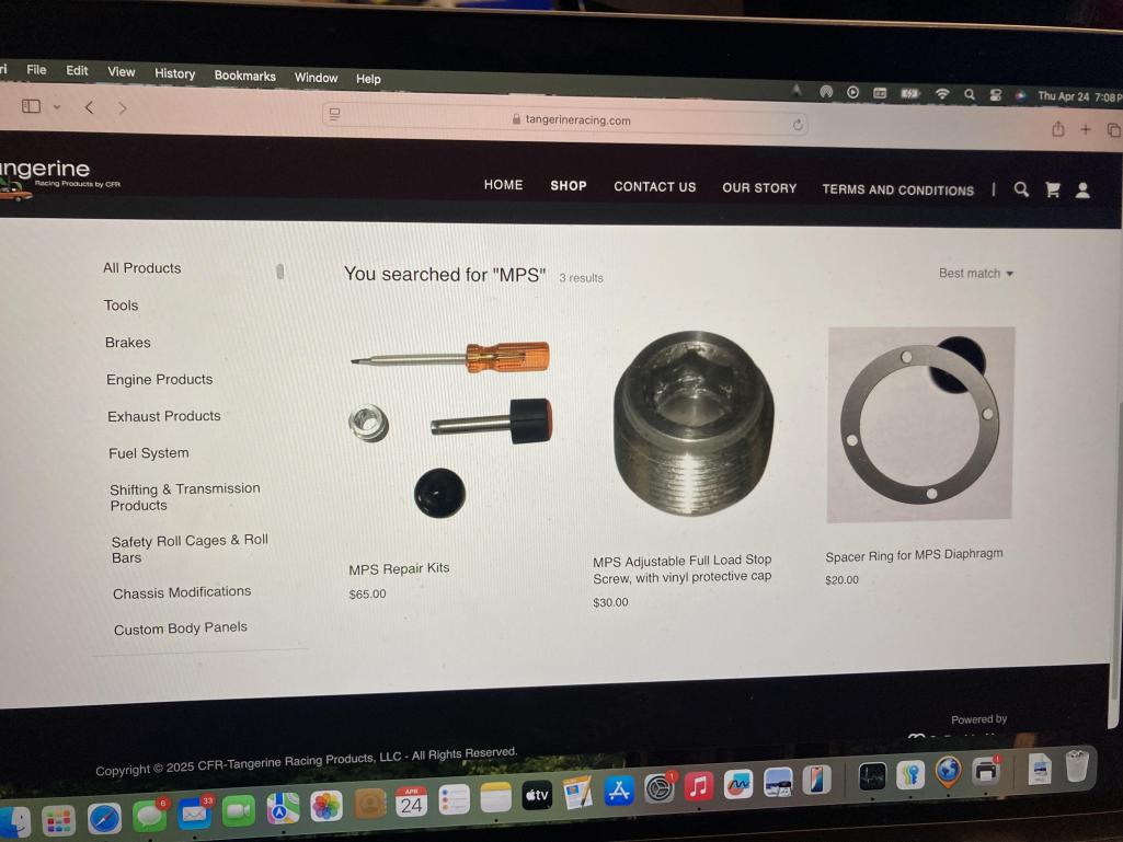

Ron914
post Apr 24 2025, 08:11 PM
Posts: 562
Joined: 19-April 22
From: Huntington Beach,Ca
Member No.: 26,487
Nothing on Patrick's site
I just found this but not sure if available , I'll have to go back and check again but Is this what I need ?
@emerygt350 , @Superhawk996

Ron914   If I can find parts I will need some coaching on r...   Apr 24 2025, 08:05 PM
Ron914   Nothing on Patrick's site I just found this bu...   Apr 24 2025, 08:11 PM
emerygt350   That's part of it. On a 76 if you have the ori...   Apr 24 2025, 08:21 PM
