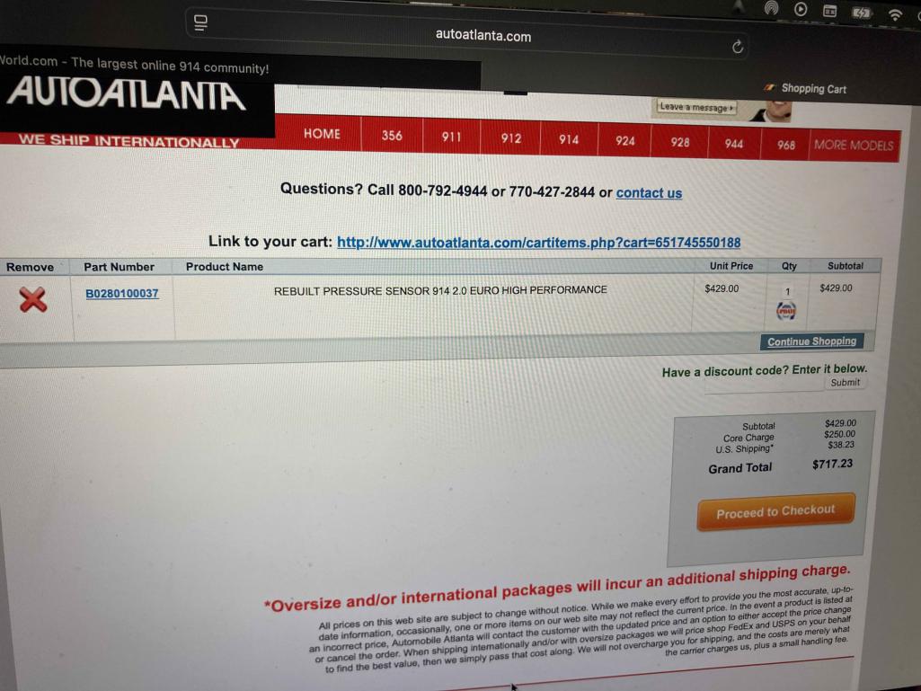

The kit does not show a diaphragm only a spacer ring for the diaphragm.
George shows he has one but I may need to call first and send in my old one , he will give you $75 per is post for anyone who sends him one but wants a $250 core charge .
Still pricey but what choices do I have

Superhawk996   I’m getting old - I don’t remember seeing that...   Apr 24 2025, 08:45 PM
Ron914   I’m getting old - I don’t remember seeing tha...   Apr 24 2025, 09:11 PM
