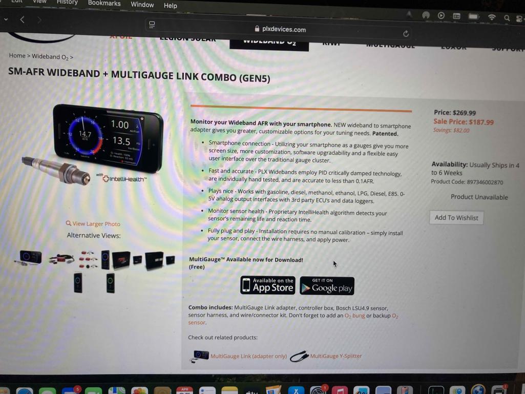

I found this AFR on a website ,What do you think ?

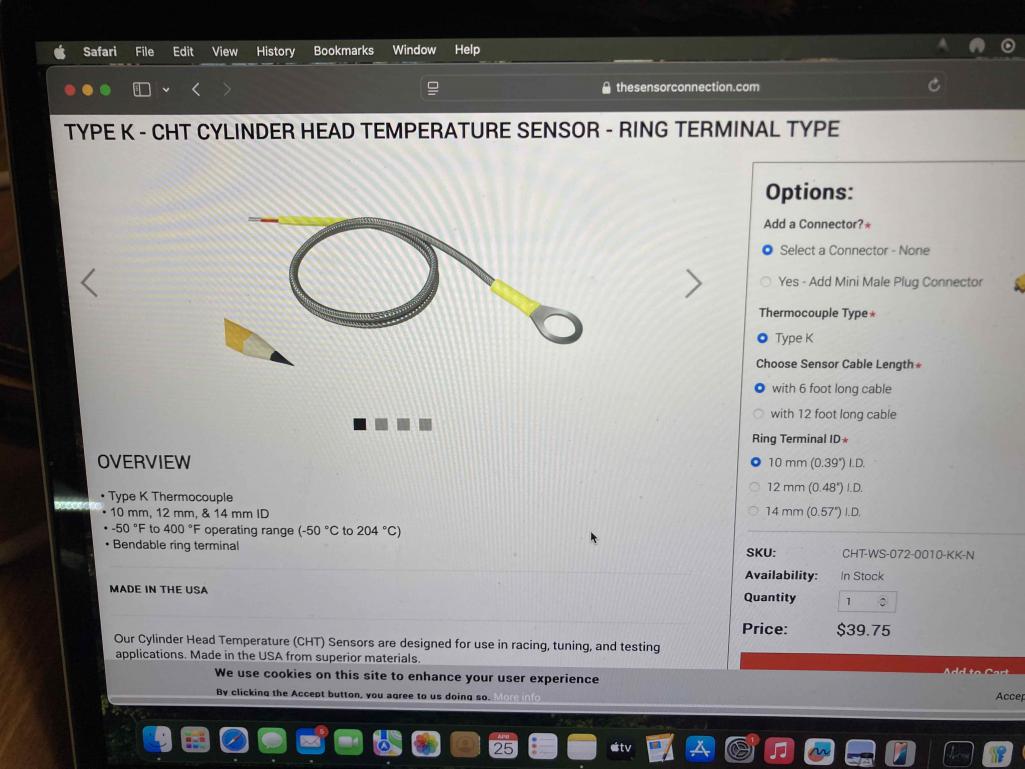

I had purchased a used CHT with gauge from a member but gave it away because it always showed 100 degrees and was only a 52mm gauge which did nut fit as a replacement for my clock in the center console. I just found this sender but still cannot locate a 60mm gauge .

emerygt350   I suggest an aem O2 sensor and gauge, I have tried...   Apr 25 2025, 11:15 AM
Ron914   I suggest an aem O2 sensor and gauge, I have trie...   Apr 25 2025, 12:21 PM
