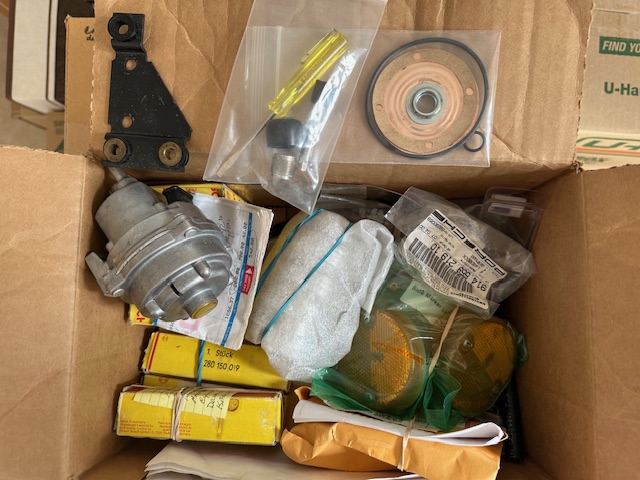

TJB/914   Hi Ron, I sent you a PM this morning. I have what ...   Apr 25 2025, 07:03 AM

Superhawk996   [b]@[url=http://www.914world.com/bbs2/index.php?s...   Apr 25 2025, 07:56 AM
JeffBowlsby   [b]@[url=http://www.914world.com/bbs2/index.php?s...   Apr 25 2025, 08:29 AM
Ron914   [b]@[url=http://www.914world.com/bbs2/index.php?...   Apr 25 2025, 08:32 AM
TJB/914   [b]@[url=http://www.914world.com/bbs2/index.php?s...   Apr 25 2025, 09:00 AM
Ron914   [b]@[url=http://www.914world.com/bbs2/index.php?...   Apr 25 2025, 09:10 AM
JeffBowlsby   Sincere apologies Ron, did not realize your engine...   Apr 25 2025, 09:03 AM
Ron914   What else do you have in that box of junk(just kid...   Apr 25 2025, 09:13 AM
