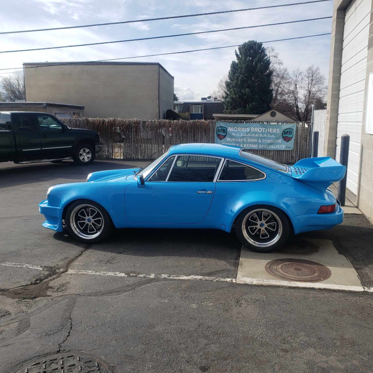

(IMG:style_emoticons/default/aktion035.gif) (IMG:style_emoticons/default/aktion035.gif) (IMG:style_emoticons/default/aktion035.gif) see the 930 EV on display.. (IMG:style_emoticons/default/sheeplove.gif) Mention MBMs...
