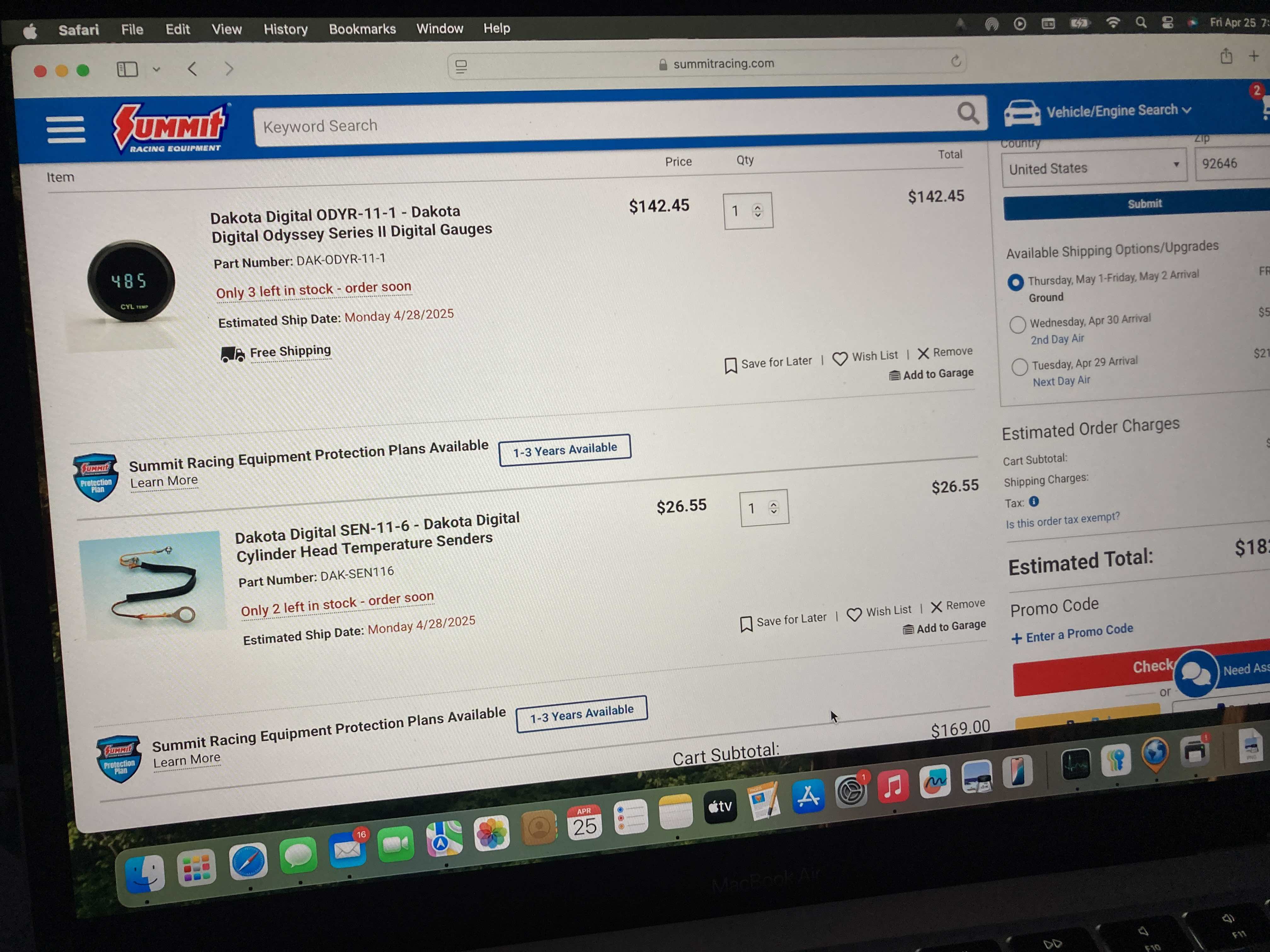

Ron914   @emerygt350 I found these online ,would they be w...   Apr 25 2025, 07:56 PM
Ron914   I can actually buy this set up on Amazon with free...   Apr 25 2025, 08:15 PM
Ron914   I forgot this one , and these choices look like my...   Apr 25 2025, 08:24 PM
emerygt350   Yes, those look good. Make sure the cables are lo...   Apr 25 2025, 08:27 PM
Ron914   Yes, those look good. Make sure the cables are l...   Apr 25 2025, 09:11 PM
