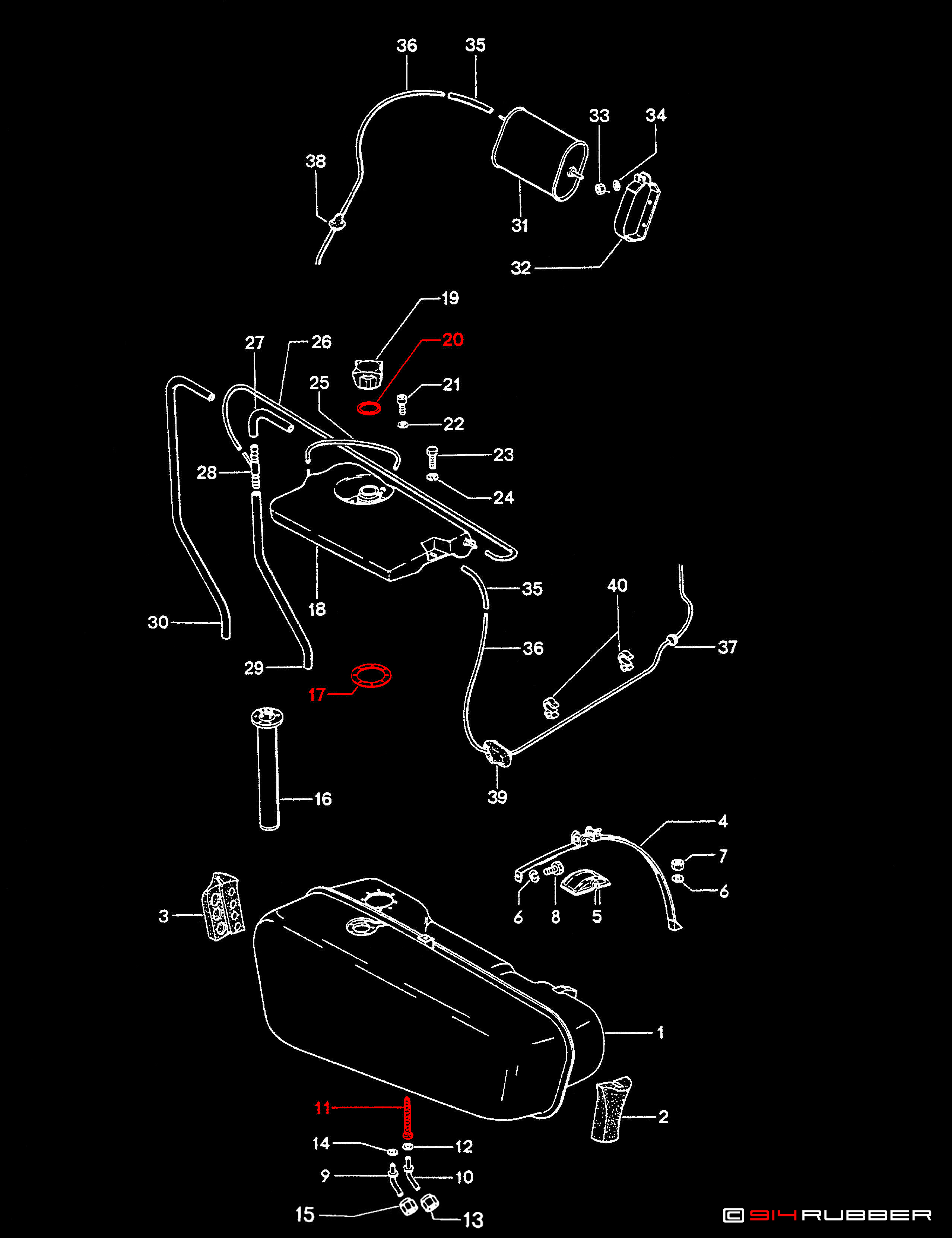

Hey, I removed my fuel tank, had it blasted and am trying to re-install it. BUT there is a blockage in the larger (of the two) fuel lines. It seems to have been there since new?The vehicle is a late '73 and to the best of my knowledge looks like it is original. How am I suppose to insert a (maybe) 3" long screen into this fuel outlet with this circular thing approximately 1/2" inside there? I am trying to get the car up and running to make to the Porsche Swap Meet next weekend.

The fuel screen fits into the bottom of the gas tank. The fittings at the bottom where the fuel hose fits to the tank. the screen is connected to the supply line and sits inside tank.
If you have a blockage in the line then the lines should be replaced. If fuel lines are plastic those are as old as the car and should be changed out for you and your cars safety.

bdstone914   Your description is confusing. Post a picture of t...   Apr 26 2025, 05:29 AM

Artfrombama   Is the old screen still in the tank?   Apr 26 2025, 10:40 AM
Superhawk996   That side with the restriction closest to the weld...   Apr 26 2025, 11:04 AM
shag   Yup, Peter Egan is right. I did not remove the tu...   Apr 26 2025, 11:22 AM
