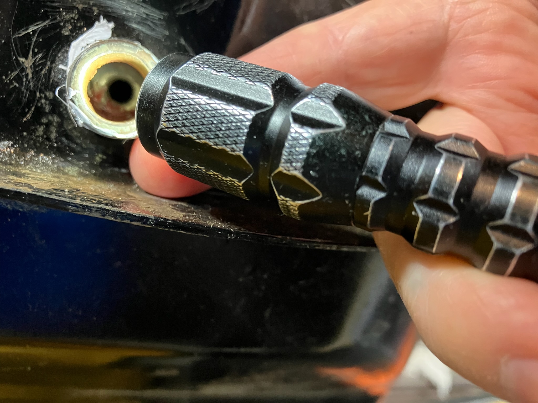

Hey, I removed my fuel tank, had it blasted and am trying to re-install it. BUT there is a blockage in the larger (of the two) fuel lines. It seems to have been there since new?The vehicle is a late '73 and to the best of my knowledge looks like it is original. How am I suppose to insert a (maybe) 3" long screen into this fuel outlet with this circular thing approximately 1/2" inside there? I am trying to get the car up and running to make to the Porsche Swap Meet next weekend.

bdstone914   Your description is confusing. Post a picture of t...   Apr 26 2025, 05:29 AM
shag   Hello Gentlemen, I have never posted a picture bef...   Apr 26 2025, 06:23 AM
shag   I took a picture and have no idea how to submit it...   Apr 26 2025, 06:47 AM
saigon71   Pics:   Apr 26 2025, 08:56 AM
rick 918-S   That does not look normal. I will see if I have a ...   Apr 26 2025, 09:39 AM
Artfrombama   Is the old screen still in the tank?   Apr 26 2025, 10:40 AM
Superhawk996   That side with the restriction closest to the weld...   Apr 26 2025, 11:04 AM
shag   Yup, Peter Egan is right. I did not remove the tu...   Apr 26 2025, 11:22 AM
shag   Rick, Thank you for trying, I really appreciate th...   Apr 26 2025, 11:25 AM

shag   Can you install a gas filter between the fuel tank...   Apr 26 2025, 03:36 PM
Jamie   Can you install a gas filter between the fuel tan...   Apr 26 2025, 06:50 PM
shag   Thanks to Jamie (will see you at Octeenerfest) and...   Apr 26 2025, 09:20 PM
