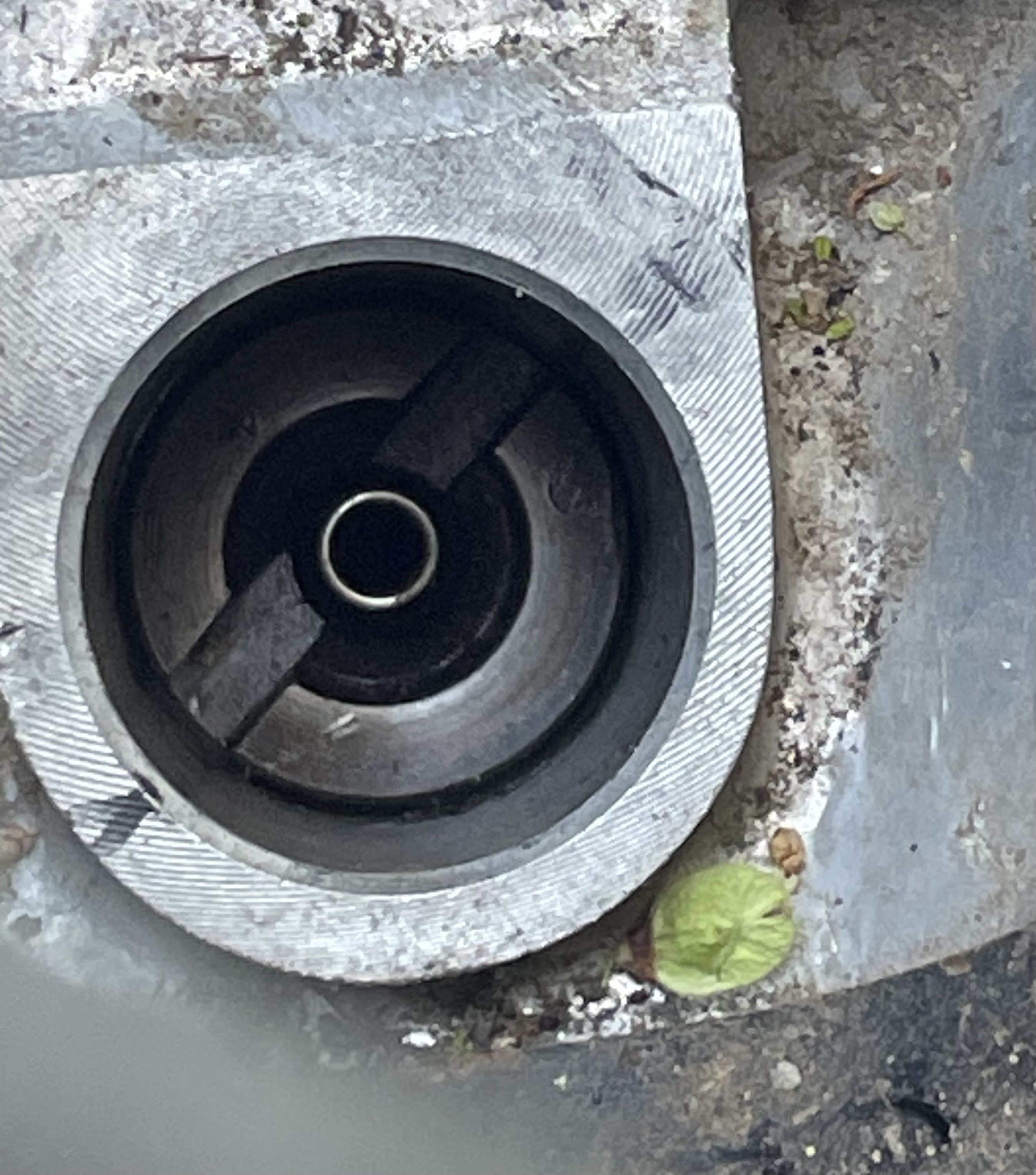

Ok that’s a significant issue then. The thing is that with the big ‘ol vac canister, there is really a pretty limited space in which it can be installed at all. I think my drive gear is fine but i don’t wanna run hot - so you guys tell me.

QUOTE(Literati914 @ Apr 26 2025, 01:17 PM) *
QUOTE(ClayPerrine @ Apr 26 2025, 12:10 AM) *
.….However, on a VW Type IV distributor, the #3 point cam lobe is retarded about 3 degrees from the other three. That is to drop the temperature on the hottest running cylinder. So you have to install the distributor drive correctly or the #3 cylinder will run hot.

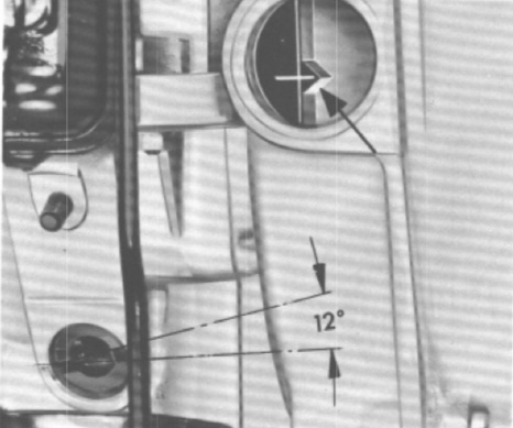

With all due respect - your drive gear doesn’t look correct. The dizzy drive has 12 teeth - each being 30 degrees of rotation. You are off by 1 tooth.
Compare to factory manual

Superhawk996   More photos of correctly installed dizzy drive T...   Apr 26 2025, 12:33 PM
technicalninja   :agree: Be careful when you pull the drive out. ...   Apr 26 2025, 12:47 PM

Literati914   .. The more I look at yours I think the dizzy dri...   Apr 26 2025, 01:02 PM
Literati914   .. The more I look at yours I think the dizzy dr...   Apr 26 2025, 01:13 PM
Superhawk996   Hmm, ok looking closer I see what you mean about ...   Apr 26 2025, 01:28 PM
Literati914   Ok checked everything.. im on compression stroke. ...   Apr 26 2025, 02:20 PM
Superhawk996   This looks like about 12deg., right? :agree: ...   Apr 26 2025, 08:45 PM
