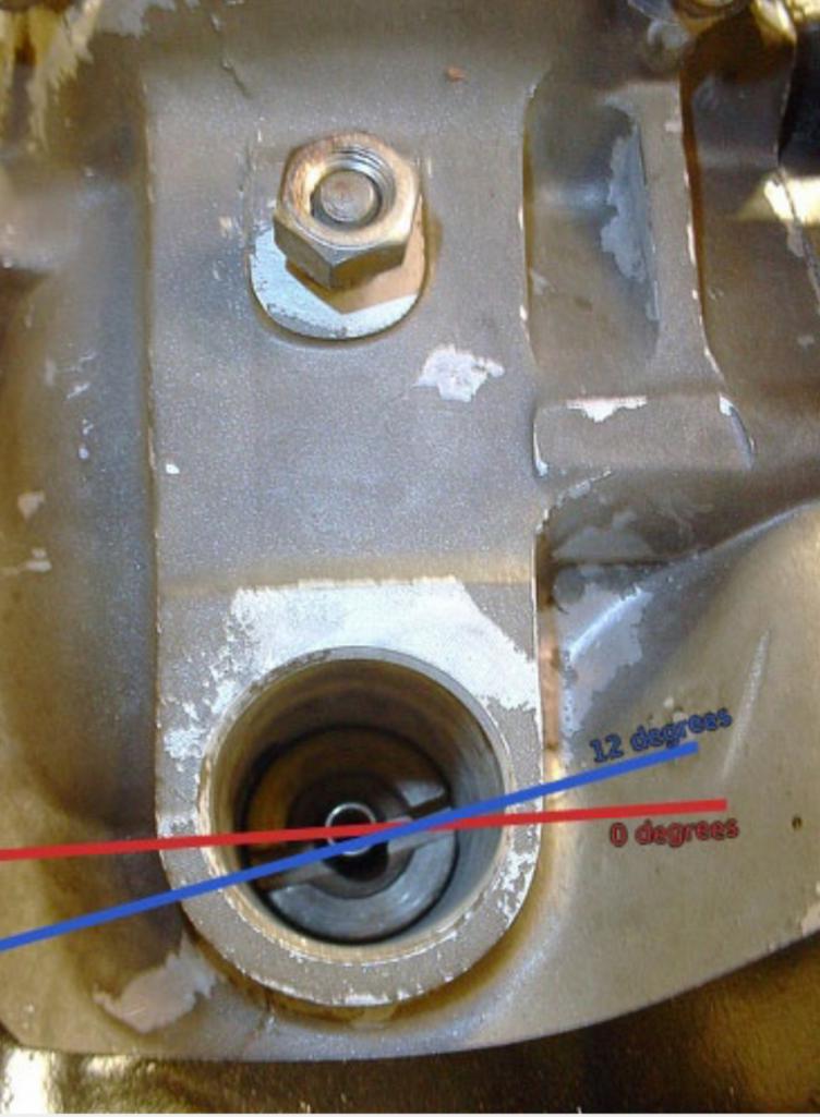

More photos of correctly installed dizzy drive
The 12 degrees is a bit confusing but it’s basically a reference of 12 degrees from engine centerline
Just focus on the fact that the two “c” shaped 1/2’s are not symmetric and focus on the orientation (smaller “c”) should be on the bottom
The more I look at yours I think the dizzy drive is 180 +/- a tooth off

Superhawk996   More photos of correctly installed dizzy drive T...   Apr 26 2025, 12:33 PM
technicalninja   :agree: Be careful when you pull the drive out. ...   Apr 26 2025, 12:47 PM

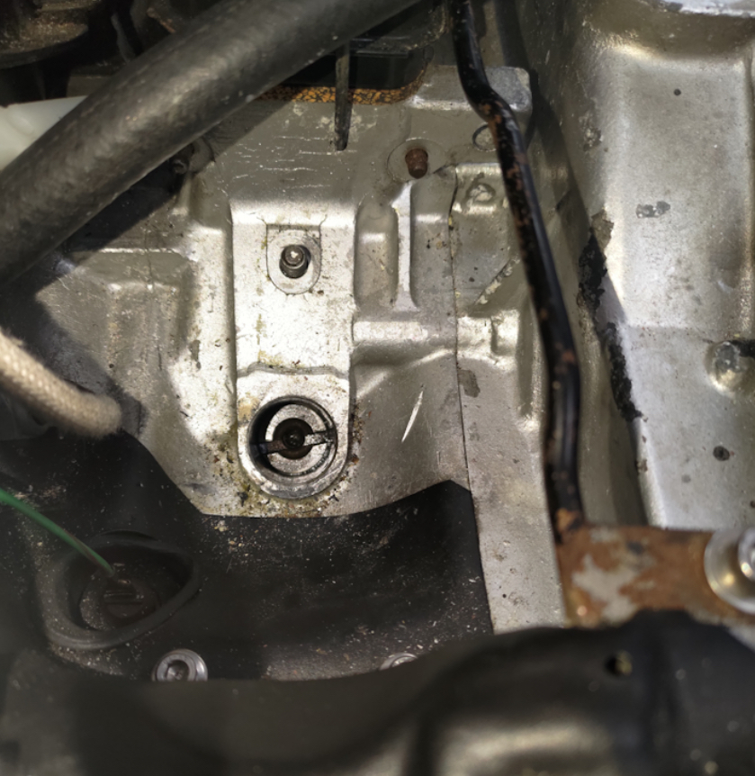

Literati914   Ok checked everything.. im on compression stroke. ...   Apr 26 2025, 02:20 PM
Superhawk996   This looks like about 12deg., right? :agree: ...   Apr 26 2025, 08:45 PM
