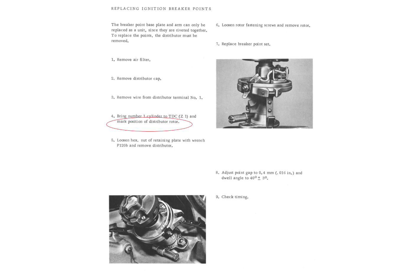

Teeners,
I took the engine apart to clean it, will add more about that within the rebuild thread I started - however - I removed the distro without noting the rotor position, can someone advise as to how to re-install the distro if I did NOT mark the position of the rotor. Sigh
(IMG:style_emoticons/default/confused24.gif) (IMG:style_emoticons/default/confused24.gif) (IMG:style_emoticons/default/confused24.gif)
UGH!

I just did this the other day.
1. Take out the #1 spark plug.
2. Put a compression tester hose in #1.
3. Using a starter button, turn the motor until compression comes out of the hose.
4. Using a 19mm wrench, turn the motor over until the TDC mark matches the case splitting line on the flywheel. Now the motor is on TDC on the compression stroke on #1. Then you can install the distributor.
5. To get the timing correct, hook a test light to the points lead with the other end on the positive side of the battery. Turn the distributor until the light goes out. That will static time the motor.
Now you can start it and set the timing with a light.

Clay,
I need to be fine-tuned - I am struggling with the position (orientation) of the Distro in relation to perhaps the hands of the clock or something the distro could point to? The instruction you gave will allow me to get the timing very close, but I could be with the instructions 360/6 or 60 degrees off and still get the same results?
BTW - I bought a rebuild kit for the distro - will be a week or two before I re-install.
Thank you Clay and Teeners!
