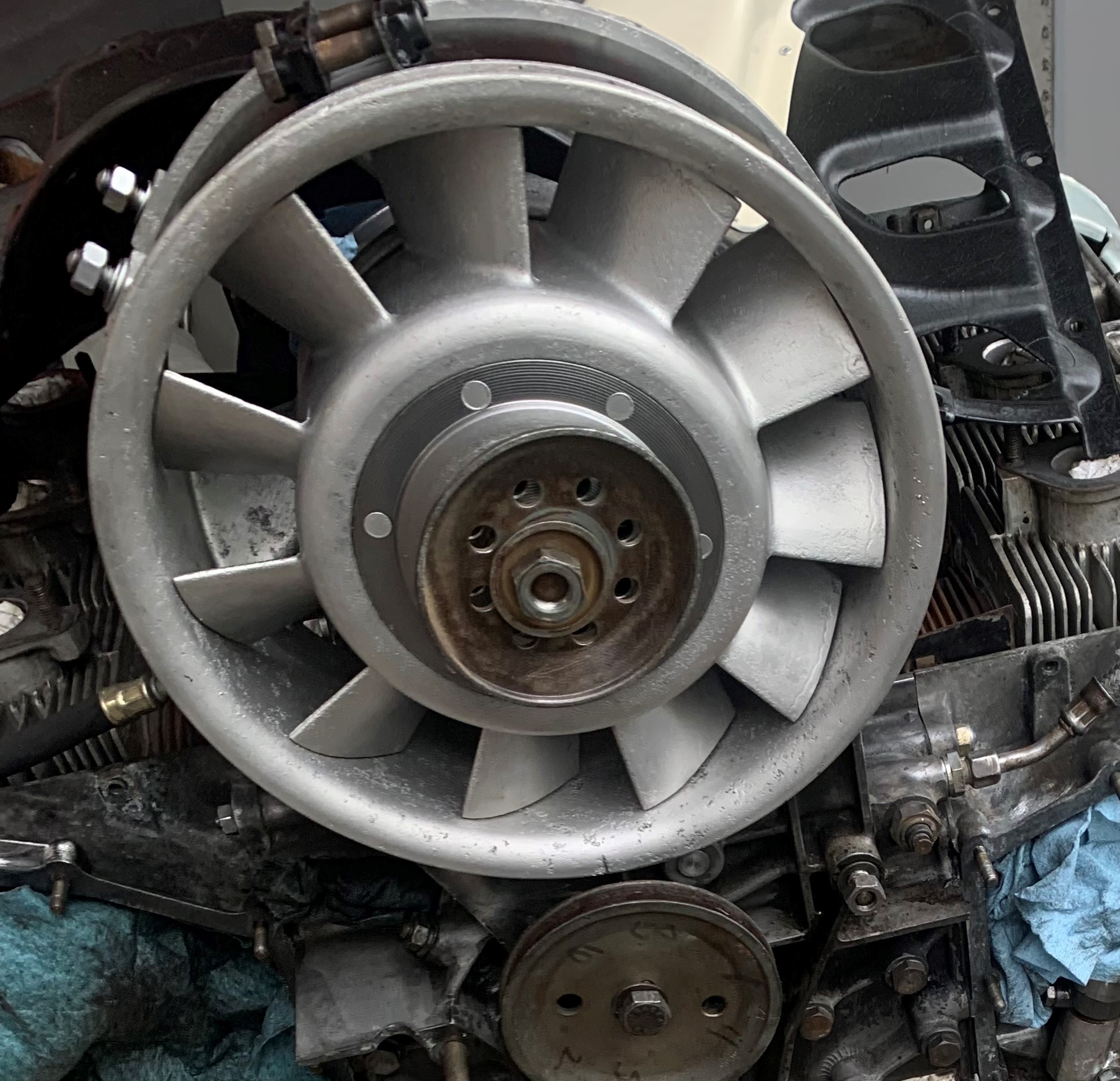

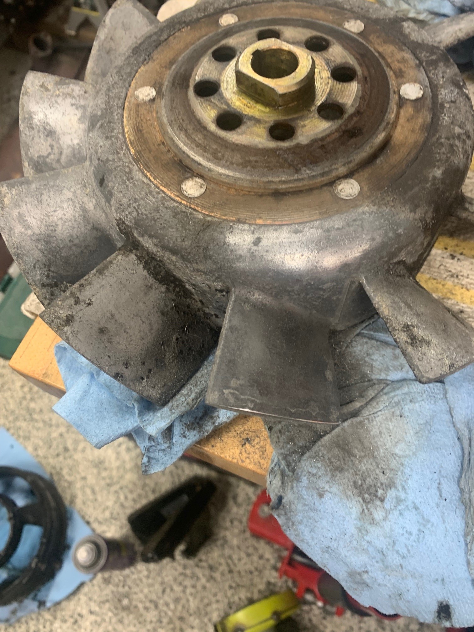

Before and After
The Magnesium is pitted but cleaned up pretty good!
