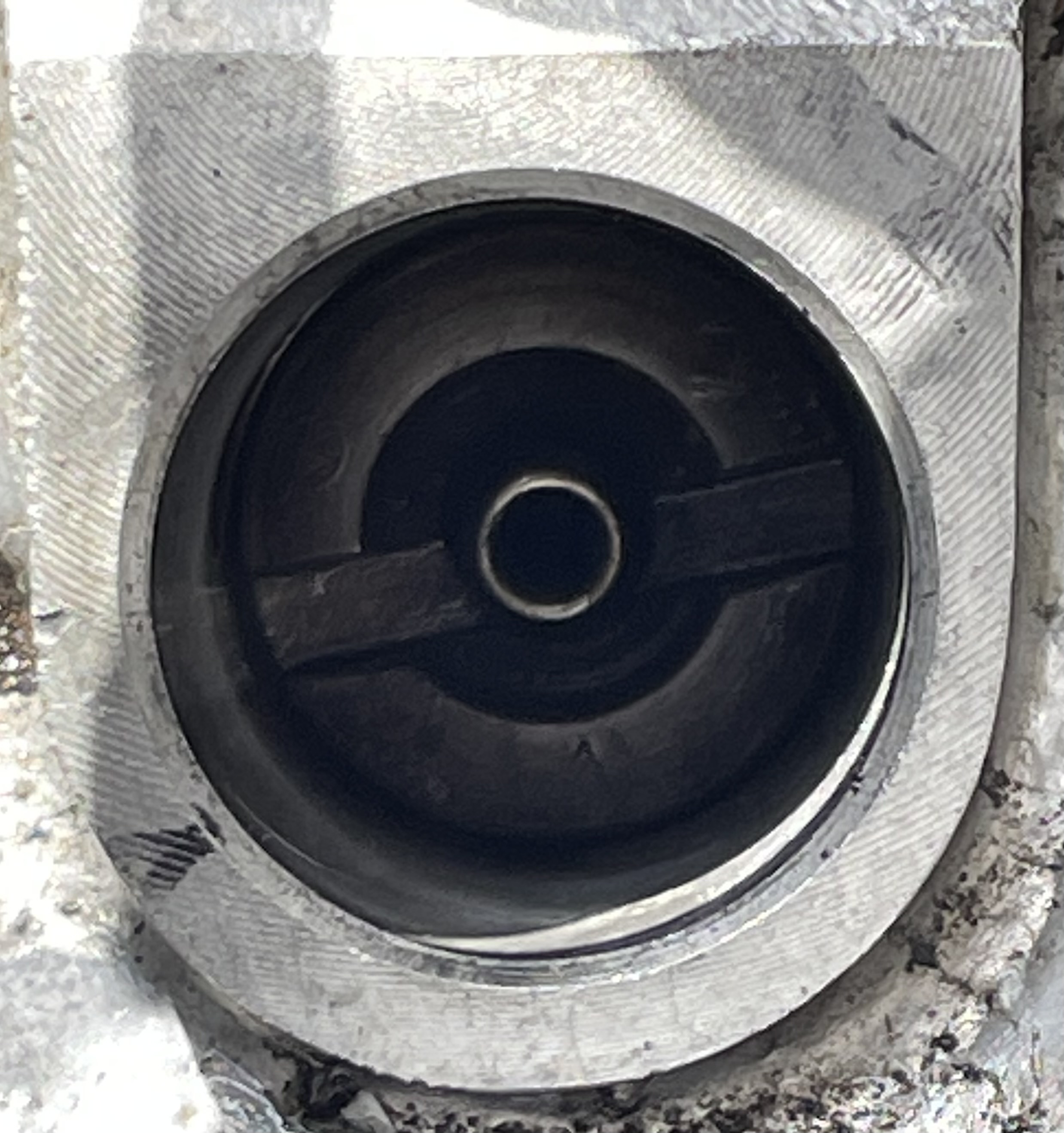

Ok checked everything.. im on compression stroke. I clocked the drive gear (small “C” on the bottom). This looks like about 12deg., right?

QUOTE(Literati914 @ Apr 26 2025, 04:20 PM) *
(IMG:style_emoticons/default/agree.gif) (IMG:style_emoticons/default/aktion035.gif)

Literati914   Ok checked everything.. im on compression stroke. ...   Apr 26 2025, 02:20 PM
Superhawk996   This looks like about 12deg., right? :agree: ...   Apr 26 2025, 08:45 PM
