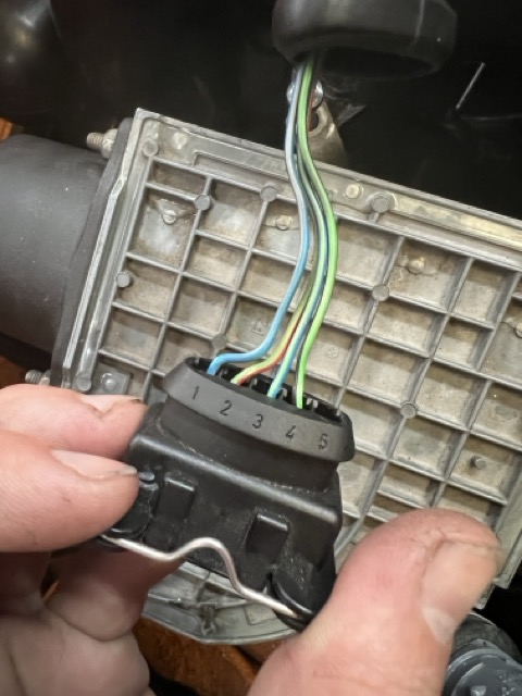

I eventually shut it down, but being only about 1-2 miles from my parents house made it back at a bit higher than normal revs. I believe a small bracket holding the Mass-airflow gave out and as a result, the air-intake lines / boots came disconnected. This made sense to me, as the engine was acting as if it might have had inconsistent air-intake / fuel mixture.

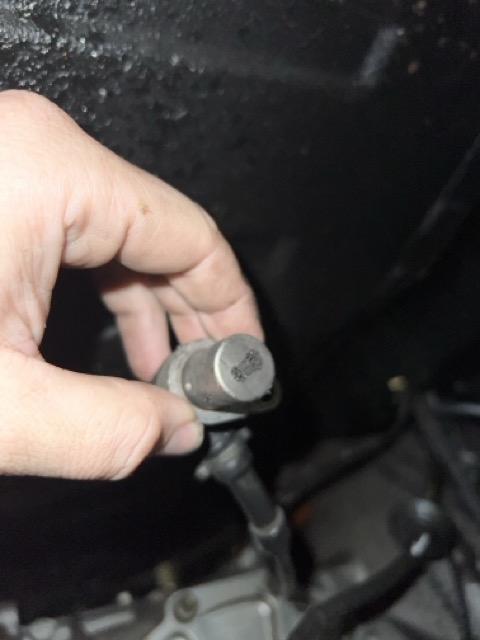

- Checked the Flywheel position sensor - shook it, seems secure
- Checked the camshaft sensor - shook it, seems secure

- Found inconsistent resistance on AFM, and corrected (loose terminals)

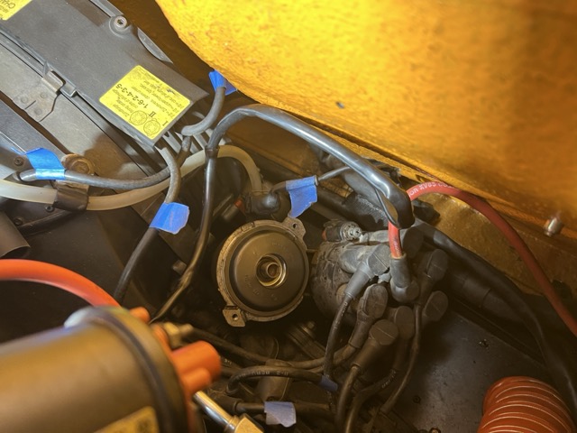

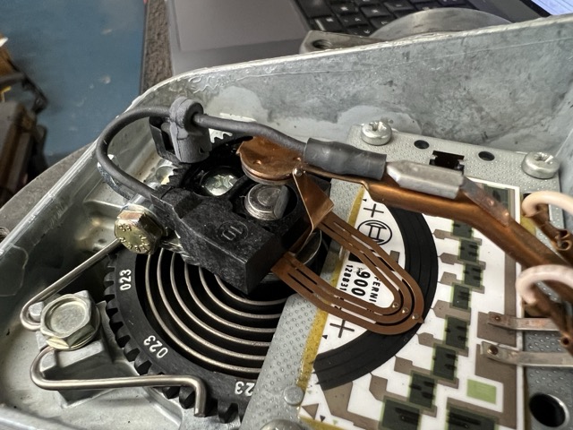

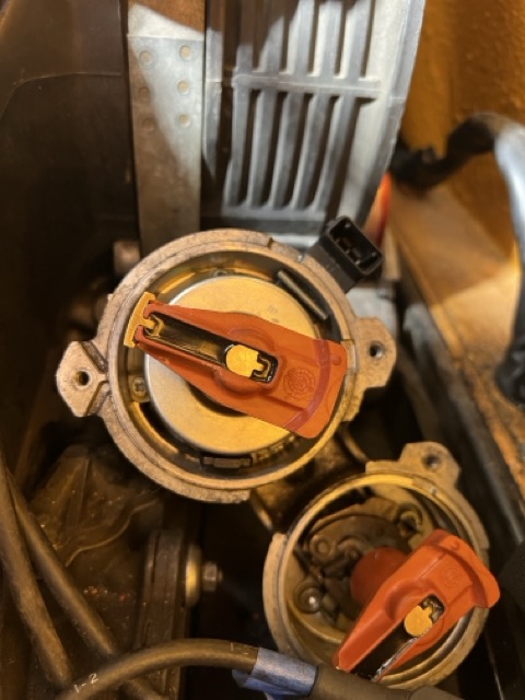

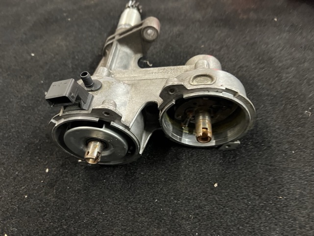

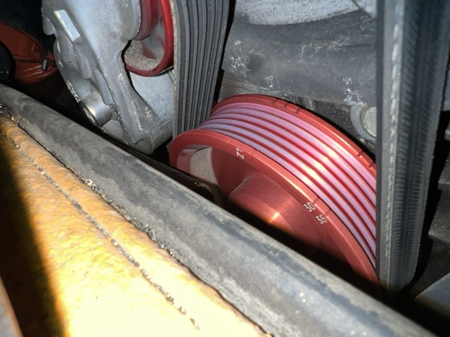

- Checked dual-distributor belt (This is a known issue, Porsche recommends replacement every 5-years / 50k miles). I misdiagnosed this as broken, but easy enough to correct. Extract, cleaned, Set engine TDC, Reinstall, Reconnect leads, etc. For the record, while not fun, I did this with the engine mounted - took about 2-3 hours - add another 2-3 if one truly replaces the belt.

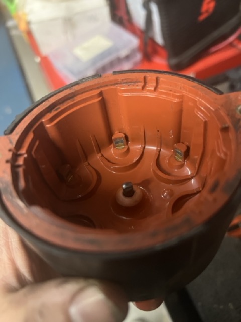

- Re-placed distributor caps and rotors and 'tested' swapping coil leads.
- This was CLOSE to my actual problem, more on that.

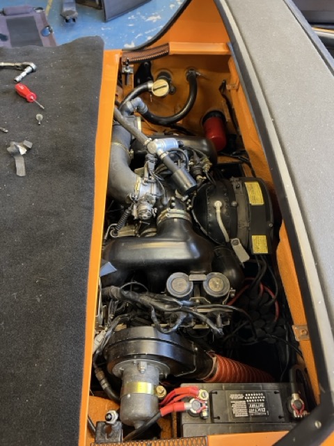

This whole thing had me thoroughly stumped and, with a Saturday 'deadline', I thought I would be going to Air and Water sans car. Bummed, I started packing and setting-up for the show load in Friday morning. My Father had just returned from a 3-day Performance Driving Course and I had been using his workshop and crew to work through the issue. Walking in, we were gathered around he car recapping the last few days when he asked, 'Have the checked the coils'? I replied that I did, and had tried 'swapping' the leads from the distributor to each (One coil and dist. controls the top-spark plugs, the other the bottom). Thats when he replied, 'Yeah... But from the top-connector', as there are two-leads from the control unit to the distributor.
I swear, the man had 1-hand in his pocket. Leaned over the car. Unplugged both coils. Swapped them. Reconnected. Immediate 'start up'. My jaw was on the floor. I was 'close' and had spent hours, often until 2-3 in the morning, but he hit it dead on after coming off the racetrack.
Solution: While I need to dig in further, it looks like the car was running on 1-set of the twin-plug (which it should be able to), though with the issue of the AFM and probably some sort of leak from the bracket giving way, was just too much to overcome. When we secured everything and switched to running off the 'top end' of the ignition, it was able to run and drive, even though underpowered.

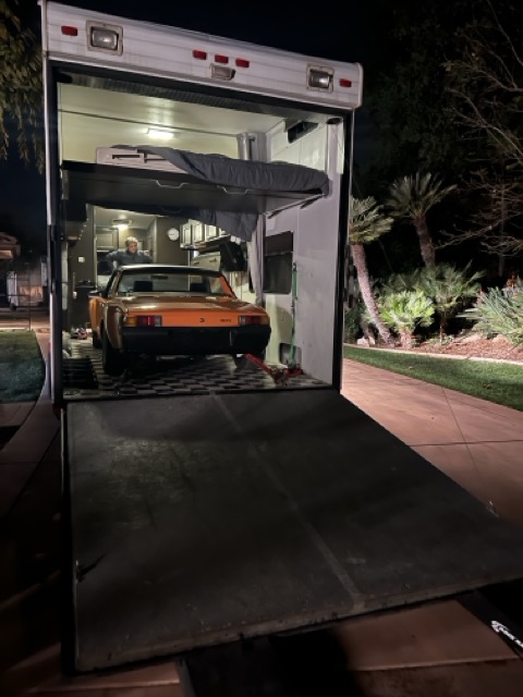

For me, this was incredible news. I was lucky enough that the guys I had worked with over the previous days where familiar with the car to get it back up to presentation-level for Air and Water as myself and the 914Seis team setup. I returned home late, my Father helped me load the car in one of his small race-trailers, and early morning, we set off for the show where it made its first-appearance!
Shout out to my Father as well as his shop-crew, Ben Martin, Bruce Stone, Steve Wong could have done it without them. Same here - I'm so happy and proud to be part of this online-community of 914World, Rennlist, and individual-builders and drivers and very grateful to EVERYONE who chimed in on this massive 'headscratcher'.
Sharing a snapshots to give you all my perspective over the last week and photos of the ordeal - Thanks everyone! (IMG:style_emoticons/default/bye1.gif)
