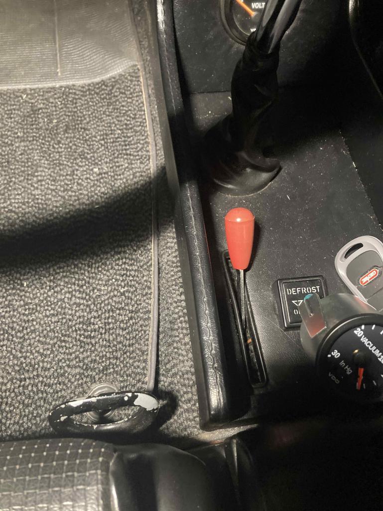

As I go through the somewhat butchered wiring harness on my new to me '73 2.0L, I've run across a green with white stripe wire which has been lengthened with some butt connectors running along the center of the car. It looks like the wire is connected to the heater control lever. Can someone explain what this does? The only green/white wire I find referenced in the Prospero Garage drawing goes from the heater fan switch to pin 9 regulator plate in the engine compartment. Thx for the help.

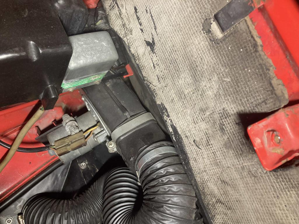

As I go through the somewhat butchered wiring harness on my new to me '73 2.0L, I've run across a green with white stripe wire which has been lengthened with some butt connectors running along the center of the car. It looks like the wire is connected to the heater control lever. Can someone explain what this does? The only green/white wire I find referenced in the Prospero Garage drawing goes from the heater fan switch to pin 9 regulator plate in the engine compartment. Thx for the help. Jesse I believe it goes to the red defrost control lever behind the shifter to turn on the blower fan in the engine compartment drivers side. |

As I go through the somewhat butchered wiring harness on my new to me '73 2.0L, I've run across a green with white stripe wire which has been lengthened with some butt connectors running along the center of the car. It looks like the wire is connected to the heater control lever. Can someone explain what this does? The only green/white wire I find referenced in the Prospero Garage drawing goes from the heater fan switch to pin 9 regulator plate in the engine compartment. Thx for the help. Jesse I believe it goes to the red defrost control lever behind the shifter to turn on the blower fan in the engine compartment drivers side.This is from my 1976. Actually as I re-read I think I am wrong . I think this is what its for . |

Dave_Darling No, you've got it right.
This wire gets groun... Apr 28 2025, 11:55 PM

jim_hoyland Where on the Heat-lever does the wire attach ? May 16 2025, 08:58 PM
914sgofast2 It attaches to a male spade type connection on the... May 16 2025, 09:19 PM
jim_hoyland Thanks; I’ll have to look deeper :) May 17 2025, 08:39 AM
ThinAir When I connected my fan to the connector in the en... May 19 2025, 12:36 PM
jim_hoyland How / where is the little square Defrost light att... May 19 2025, 04:07 PM
jim_hoyland How / where is the little square Defrost light att... May 19 2025, 04:08 PM
jim_hoyland How / where is the little square Defrost light att... May 19 2025, 04:12 PM
BillC
How / where is the little square Defrost light at... May 19 2025, 06:31 PM
jim_hoyland :) I see it, thanks… May 19 2025, 08:12 PM![]() ![]() |
