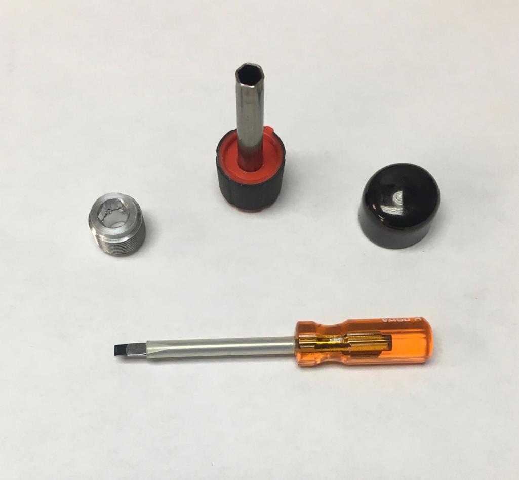

That's an old tool set pictured. Currently, I shorten the handle of the flat screwdriver so it will fit in the engine compartment better, and I sleeve the shank with hard plastic tubing to help keep it centered in the hex tool. The hex tool now has a nice knob on the end instead of a glued on piece of rubber tubing.

Ron914   Thank you Michael. @[url=http://www.914world.c...   Apr 29 2025, 08:27 AM
rjames   The hex tool is used in conjunction with the screw...   Apr 29 2025, 08:50 AM
Ron914   The hex tool is used in conjunction with the scre...   Apr 29 2025, 09:31 AM
