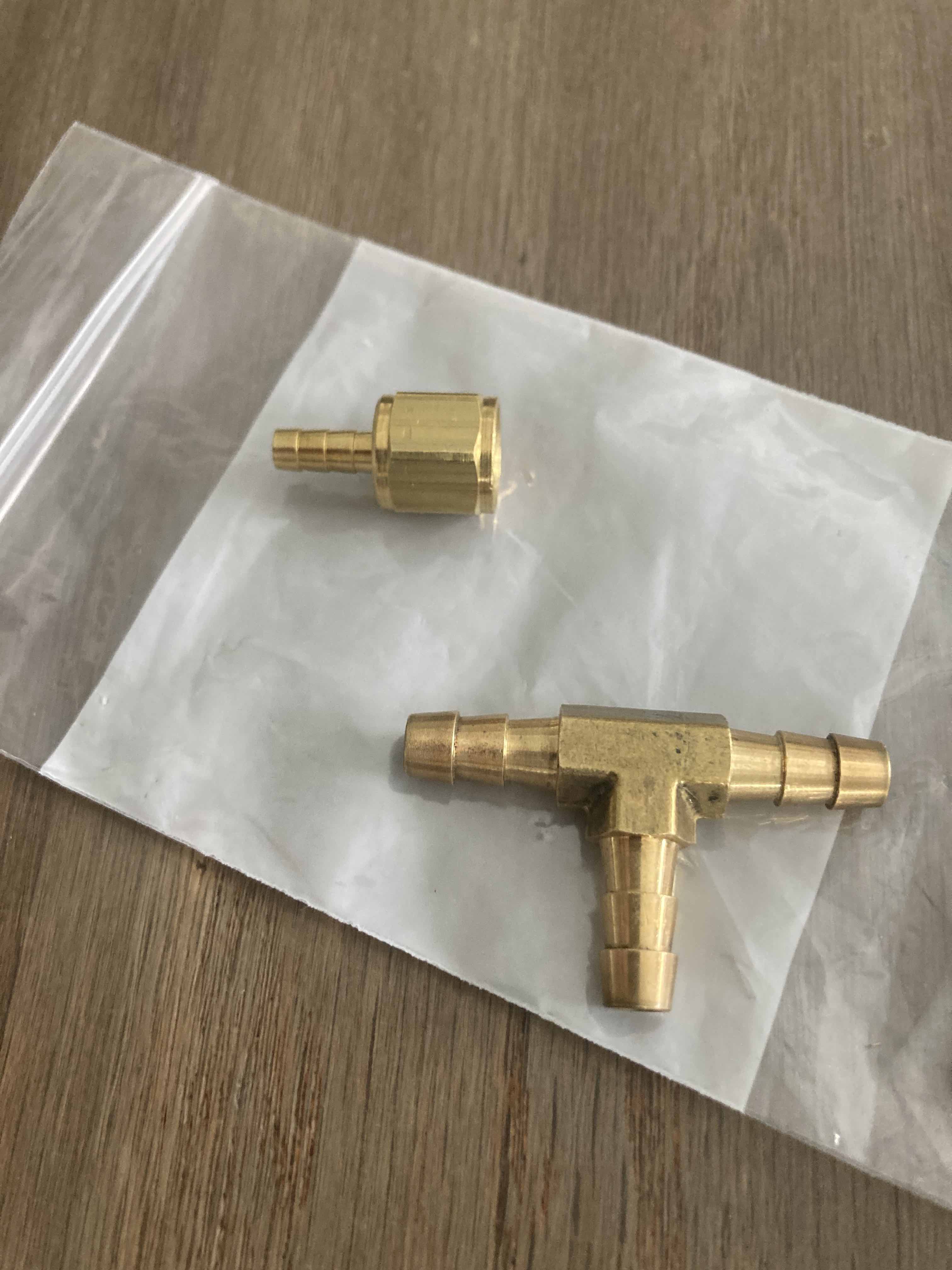

Ron914

Great I was hoping to make a smaller hole . I am having difficulty finding 5mm tee's and the supposed 1/8-27 NPT fitting with 4.69mm barbed I purchased from Grainger does not fit the back of my gauge , I don'r think it is a 27 thread fitting . Any vendor suggestions on locating these parts ? the tee I found is 7mm so maybe I can file down and force the decel hose on to it .
