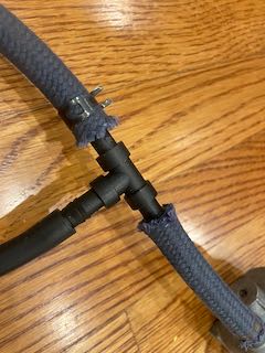

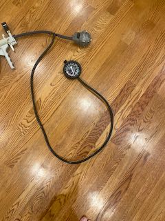

Agree, I use a cheap plastic T connection. Here's the set up I use to measure vacuum for bench testing the MPS and for measuring the vacuum while driving. Get a long enough hose from the T fitting to the vacuum gauge so the you can read the vacuum gauge while driving. This one is 5' and could use another foot or two to reach to the dash.

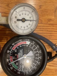

I also use this vacuum gauge instead of the mityvac built in gauge. You can see there is about 2 inHg difference.
