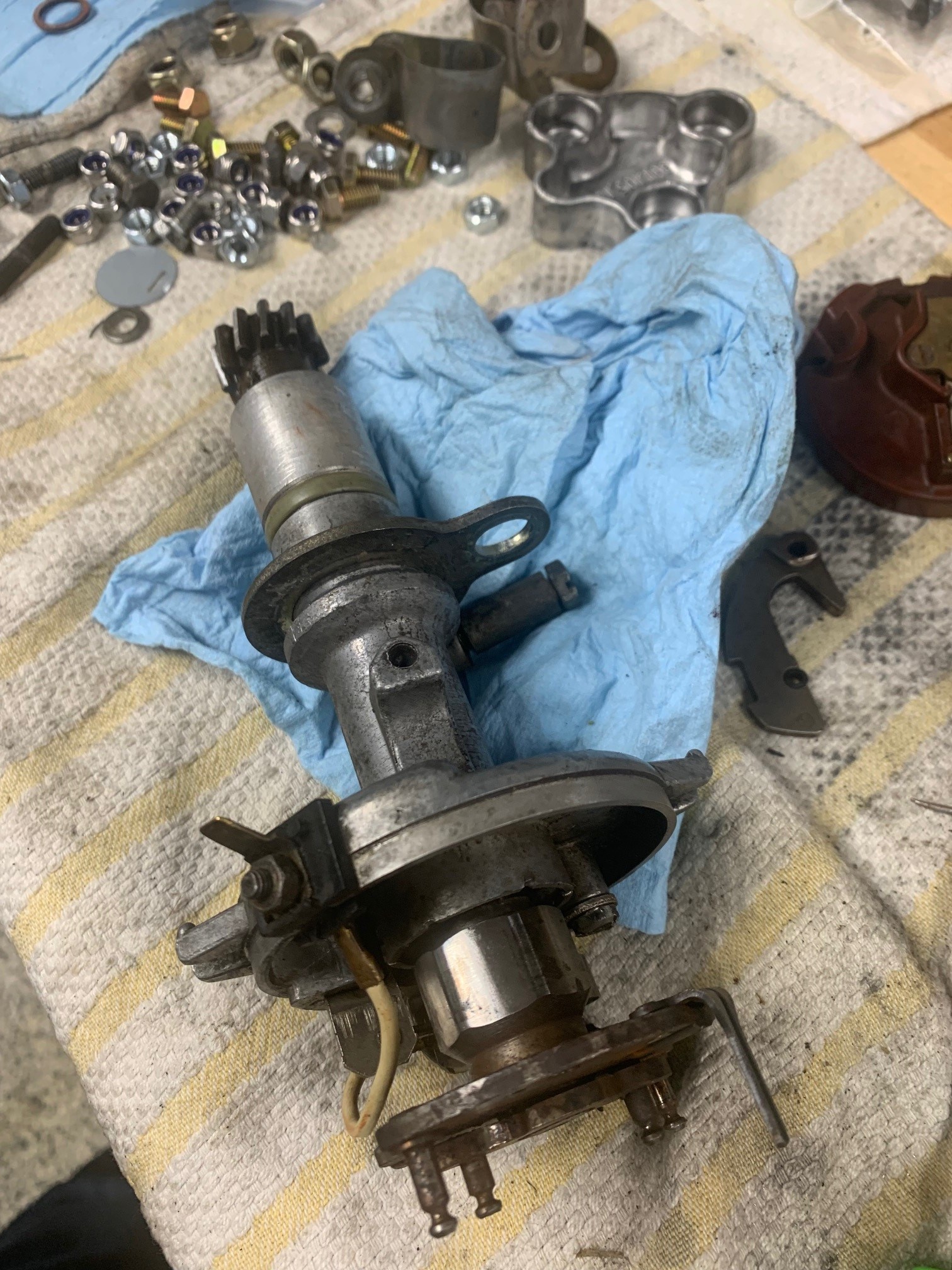

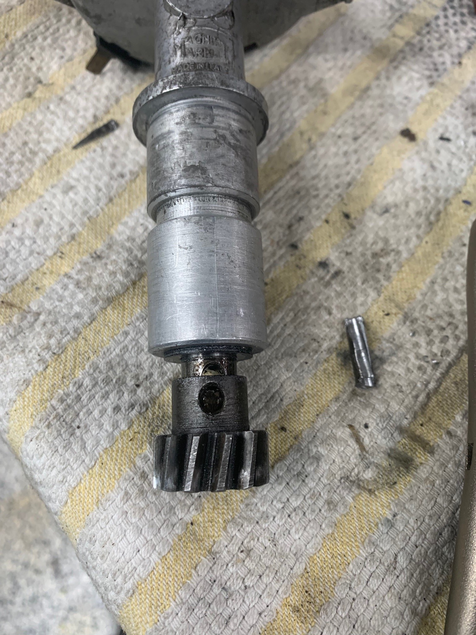

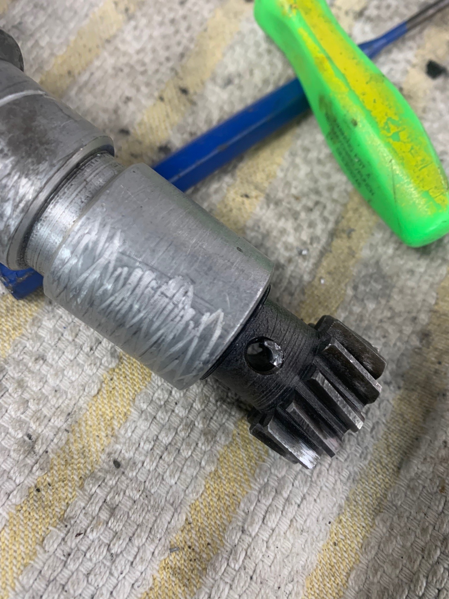

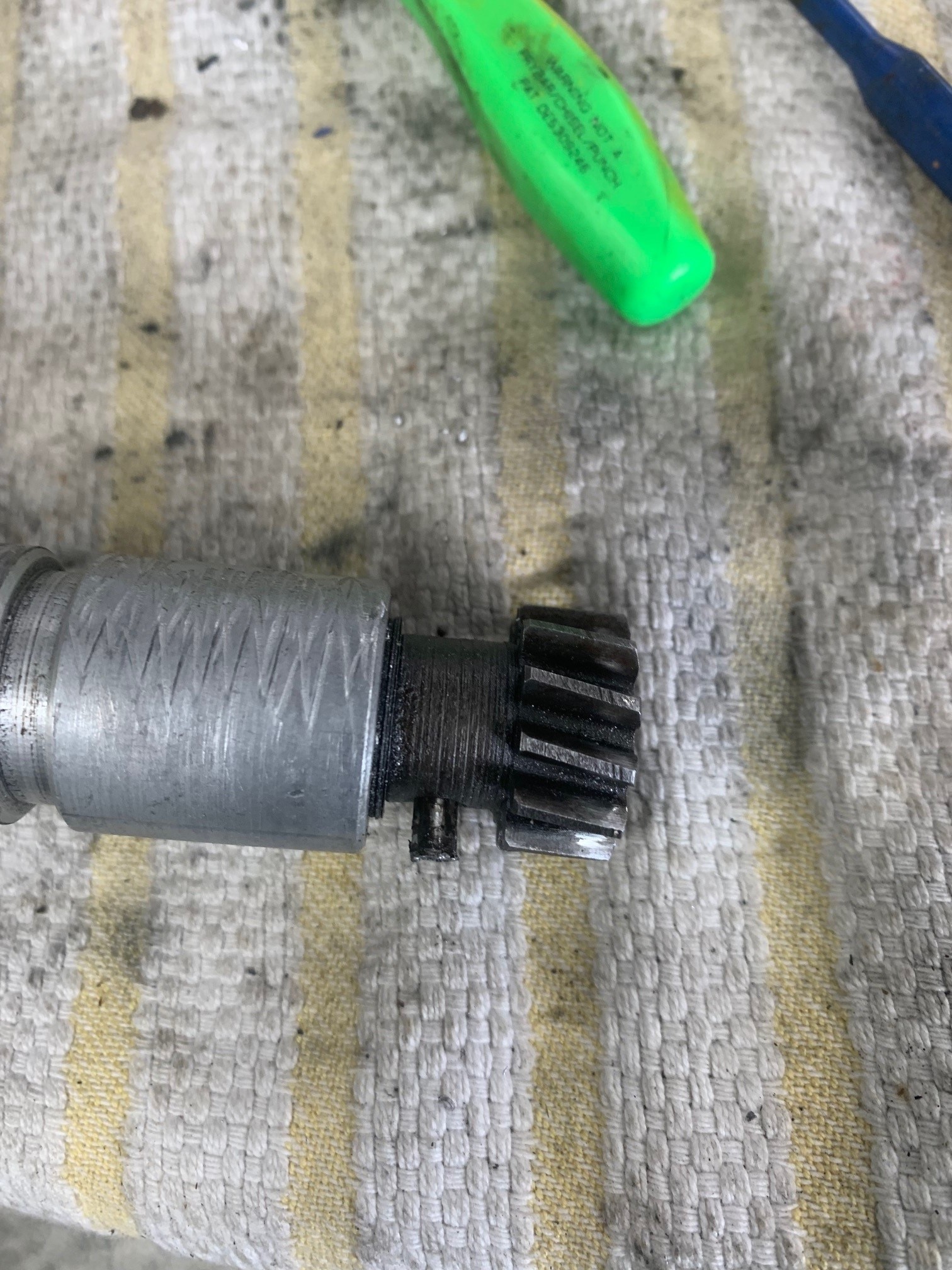

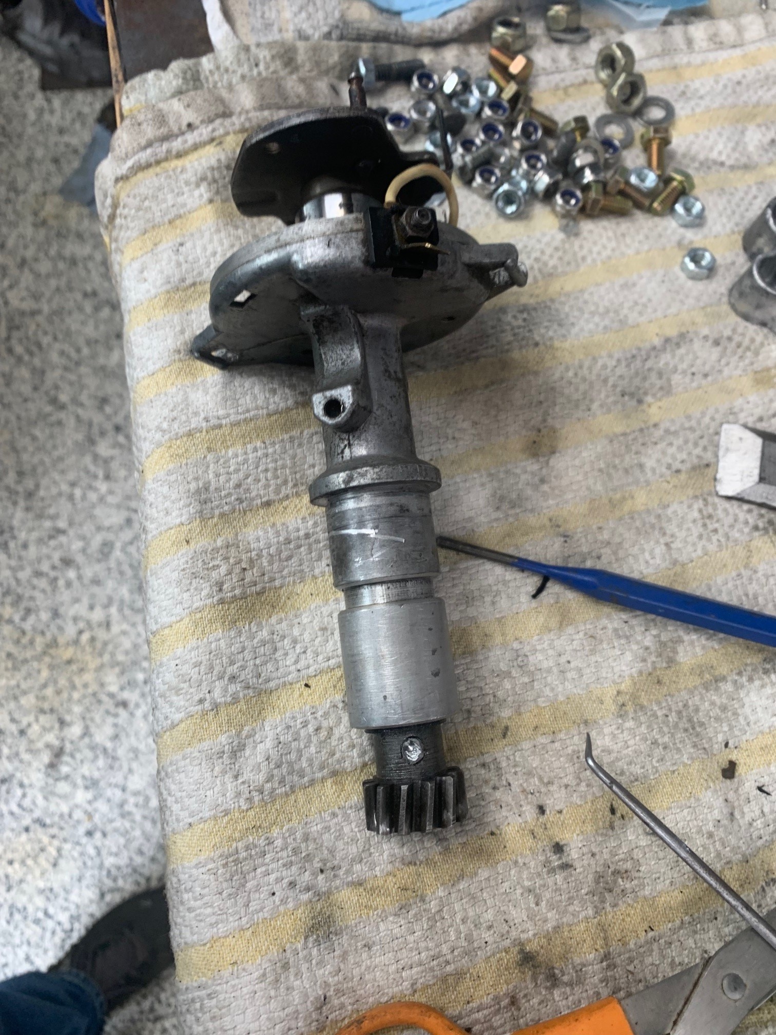

Distributor
I really like this setup, simple, no noticeable wear, however, old grease has made the shaft a bit stiff and the advance operation no doubt is effected by old grease that is now glue........interesting metaphor (IMG:style_emoticons/default/dry.gif)
I took apart all of the screws which were muscle-F****D at some time in the past, also ordered a rebuild kit from PartsKlassic.
The shaft was never removed from the assembly and I had to drill out the original drift, it was distorted most likely with a factory press on either side. My question is the re-distortion of the pin that is with the rebuild kit, has anyone else done this job? Is there a tool I could use in my press to properly distort the pin?
Looking for any guidance, thank you,
There was a minor deformation on the case at the entry to the Distro into the case. Just a small burr that made a nasty score on the shaft - I gently removed this marring with steel wool.
I could not, after removing the head of the drift on one side, get it to come out with a firm drift/punch tool - I did not want to hit it too hard, so I started the long and careful drilling process.............
