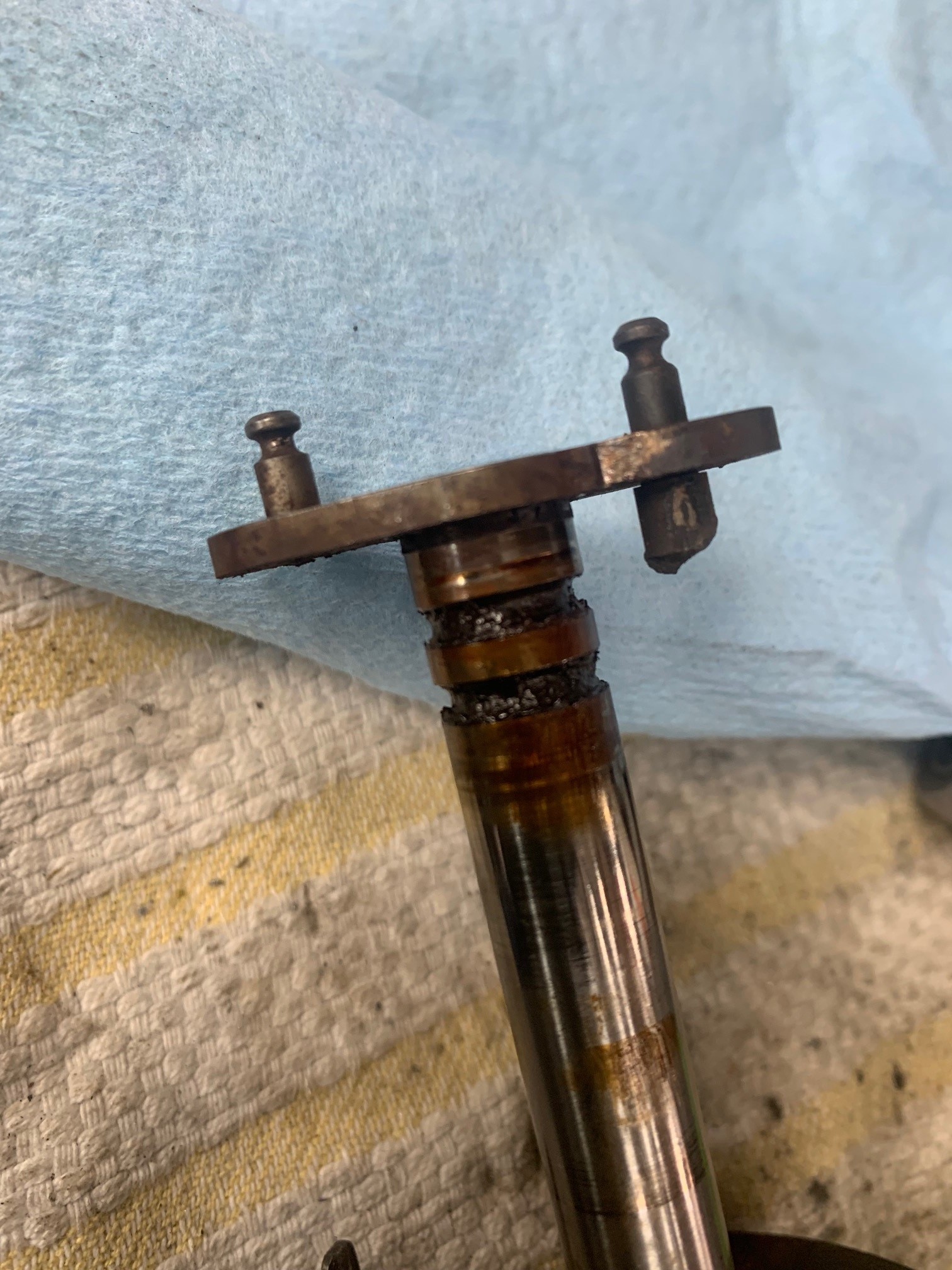

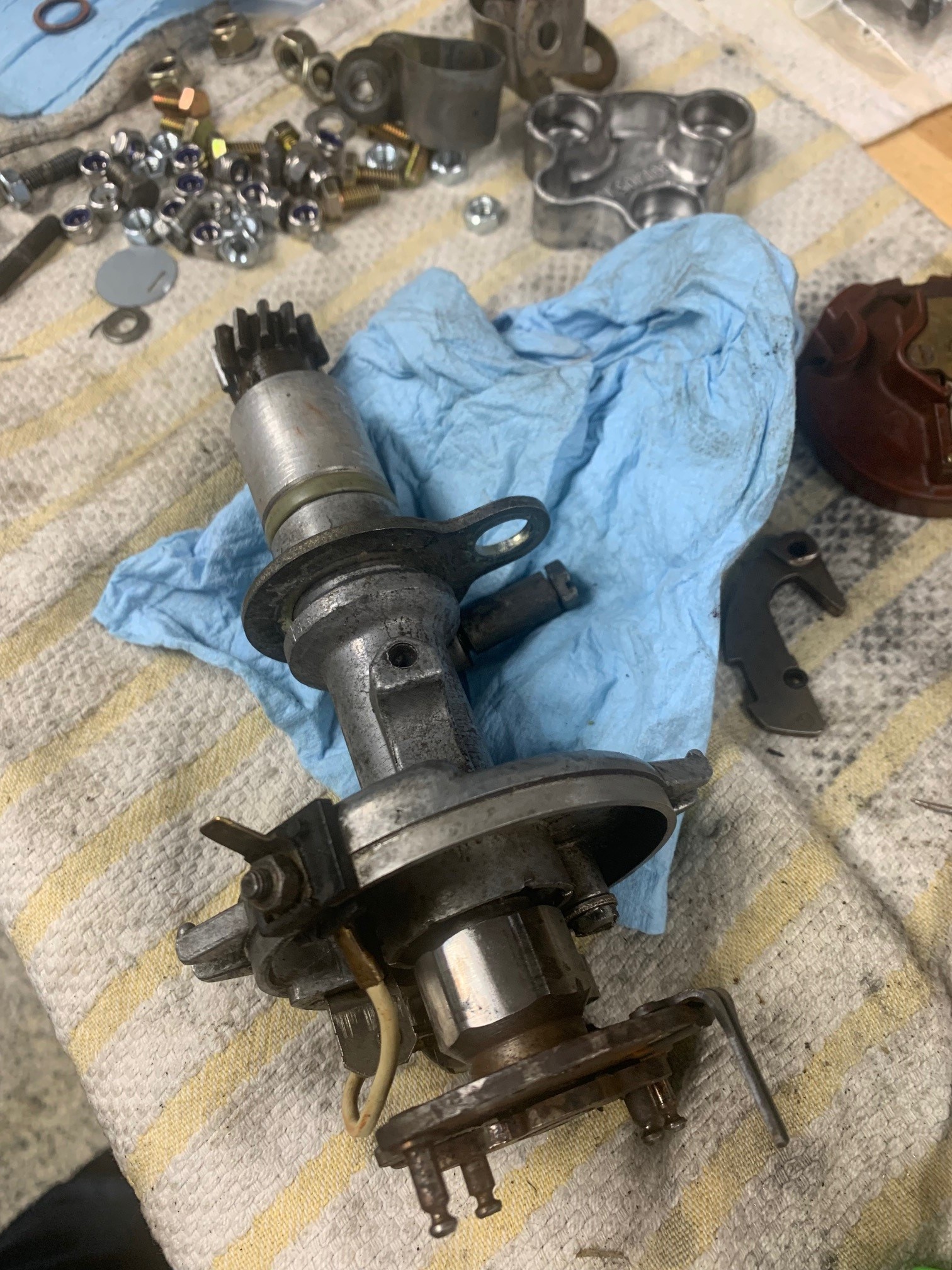

ctc911ctc   Distributor I really like this setup, simple, no ...   May 3 2025, 02:50 PM
mb911   Where is there a rebuild kit available? I remember...   May 3 2025, 05:09 PM
ctc911ctc   https://www.partsklassik.com/p-3794-distrib...mare...   May 3 2025, 08:06 PM
ctc911ctc   Here is what I am trying to fix - all of this old ...   May 3 2025, 08:11 PM
Cairo94507   It may not be the same, but when we replaced the b...   May 4 2025, 06:23 AM
