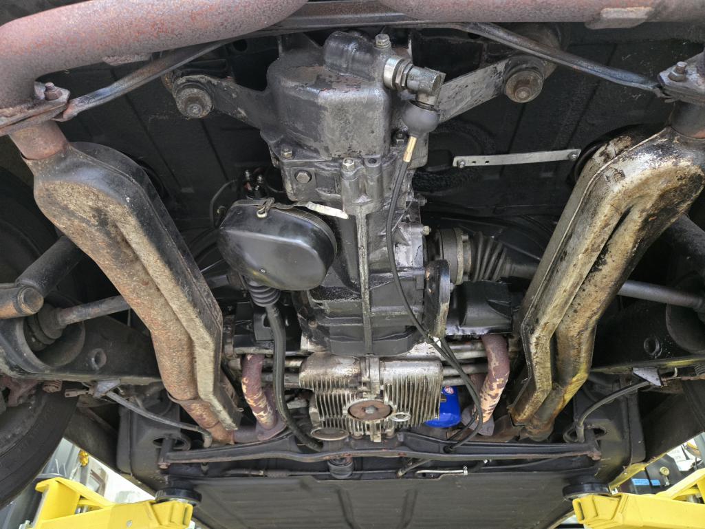

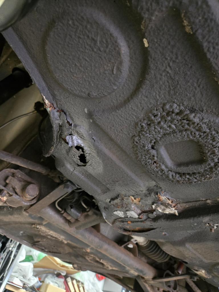

I guess starting this thread lit a fire under my a$$. Yesterday I found time to get crap out of the way to get the car up on the lift. I needed to drain the oil from my makeshift test stand and move a bunch of clutter around. Up on the lift gained me the first time seeing underneath the car. Blackforest did a decent job on the repair. With that said I saw a few trouble areas that were fixed with a crude application of things. I'll pretend I didn't see it until my foot goes through the floor (IMG:style_emoticons/default/beerchug.gif) (WTB: pedal pan section)
Uggo pic
Not so uggo

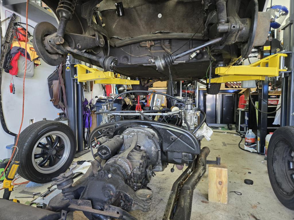

I might have gotten the drop ready in record time. At the same time I removed the shafts from the trans I also removed the shaft nut in preparation for the 5 lug hubs I purchased from Mark (914sixer). Let me put this out there for PMB. The 5 lug conversion they offer at $800 is a steal. Piecing all the parts together I will be at close to $1k and that is only because I already have new front 3.5 calipers, front and rear rotors. It would be more if I didn't have those. I really want the boxster setup like Tom (Olympic914), but that can come later. Breather disconnected, fuel line disconnected, speedo disconnected (might need to replace the cable), clutch cable disconnected, ground strap disco, shift rod disco, throttle cable disco, all 4 bolts loosened. Lowered the engine, unbolted the carrier bar, ran out of time for the trans bolts. Should be out later today (IMG:style_emoticons/default/cheer.gif)
And just like that...it's out!
