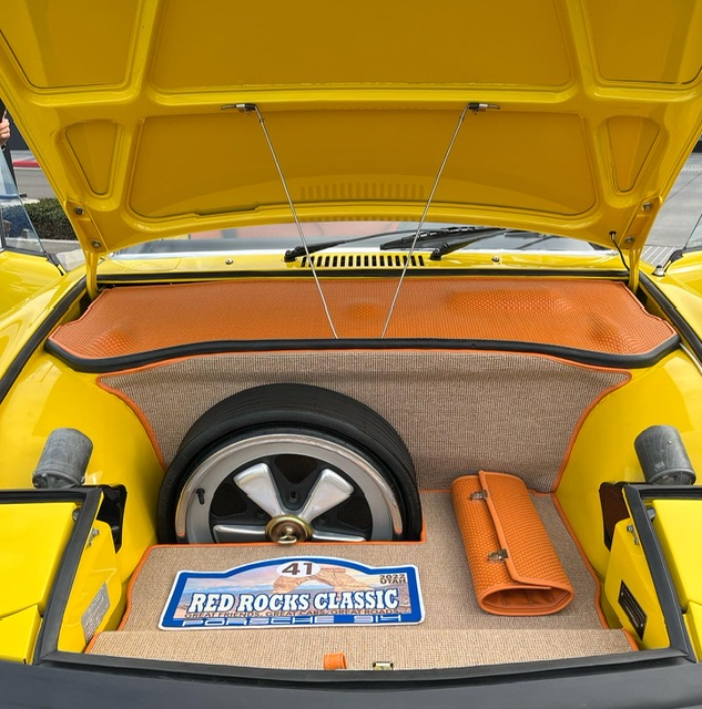

My factory 6 with front oil cooling and a 16in x 6in factory Fuchs and spacesaver. You can see how much space that there is above the tire to the top of the wall in front of the gas tank. This should give you a good idea of the fit.
Best Bob B

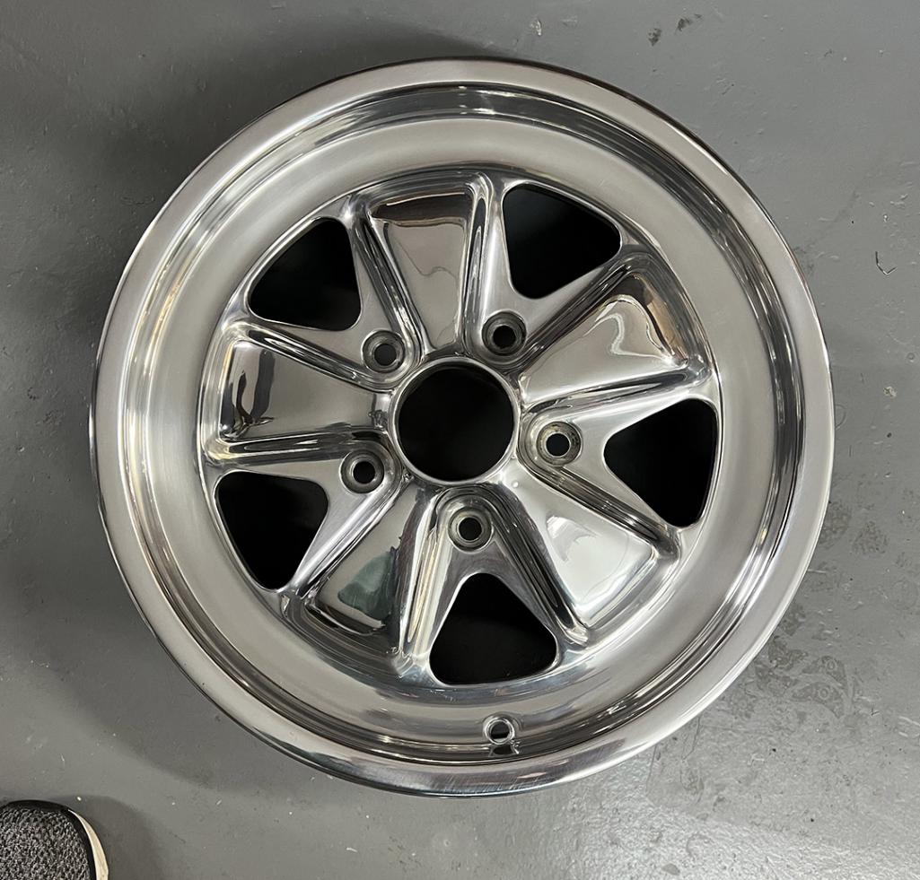

By the way I have had this polished 6x16 real Fuchs for sale in 914world for some time. $350 del. to you
