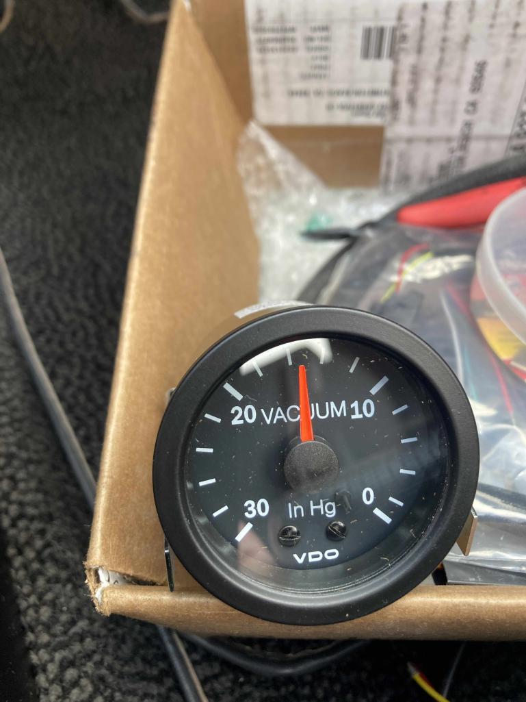

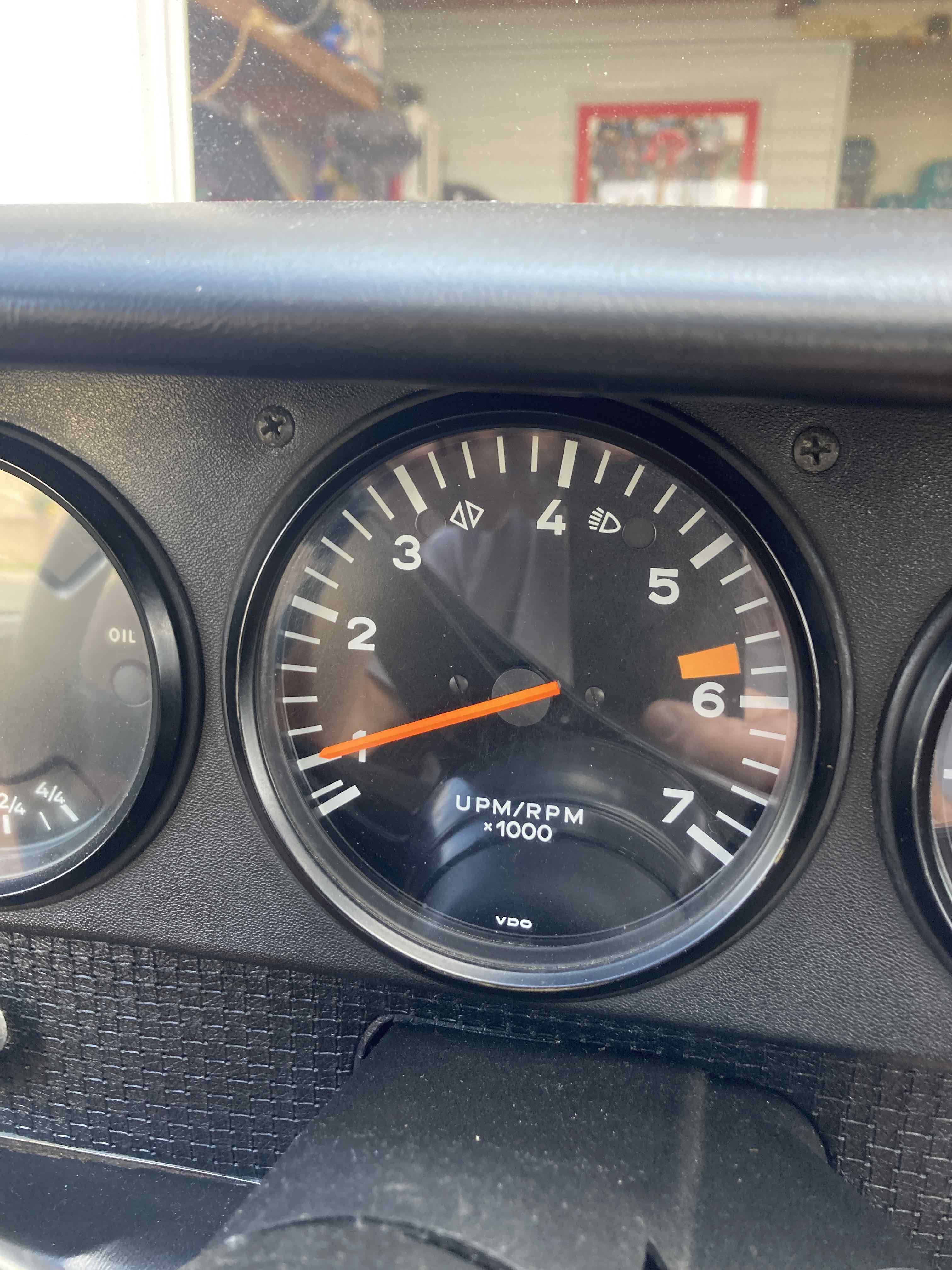

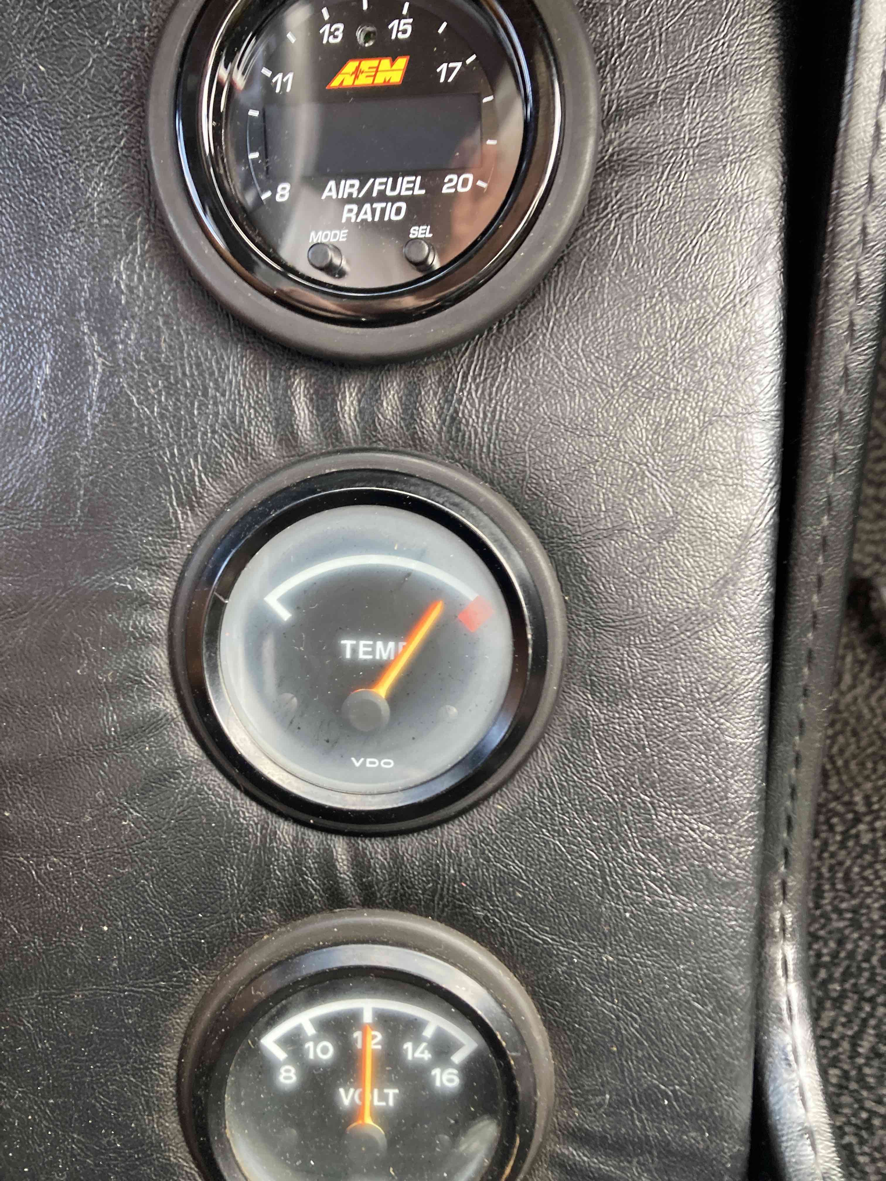

Still working on my D-Jet issues I ran my motor and drove around a few miles today before pulling my MPS for rebuild . I noticed my oil temp getting hot since yesterday .
What changed today , I connected the retard hose back on the distributor .
Below is the temp ,tach at idle and the vacuum at idle .
Due to the high temp I am going to complete the install of my new wiring so I can connect the Dakota digital gauge .AFR gauge install is not completed yet ,still need to have bung welded in my muffler.
