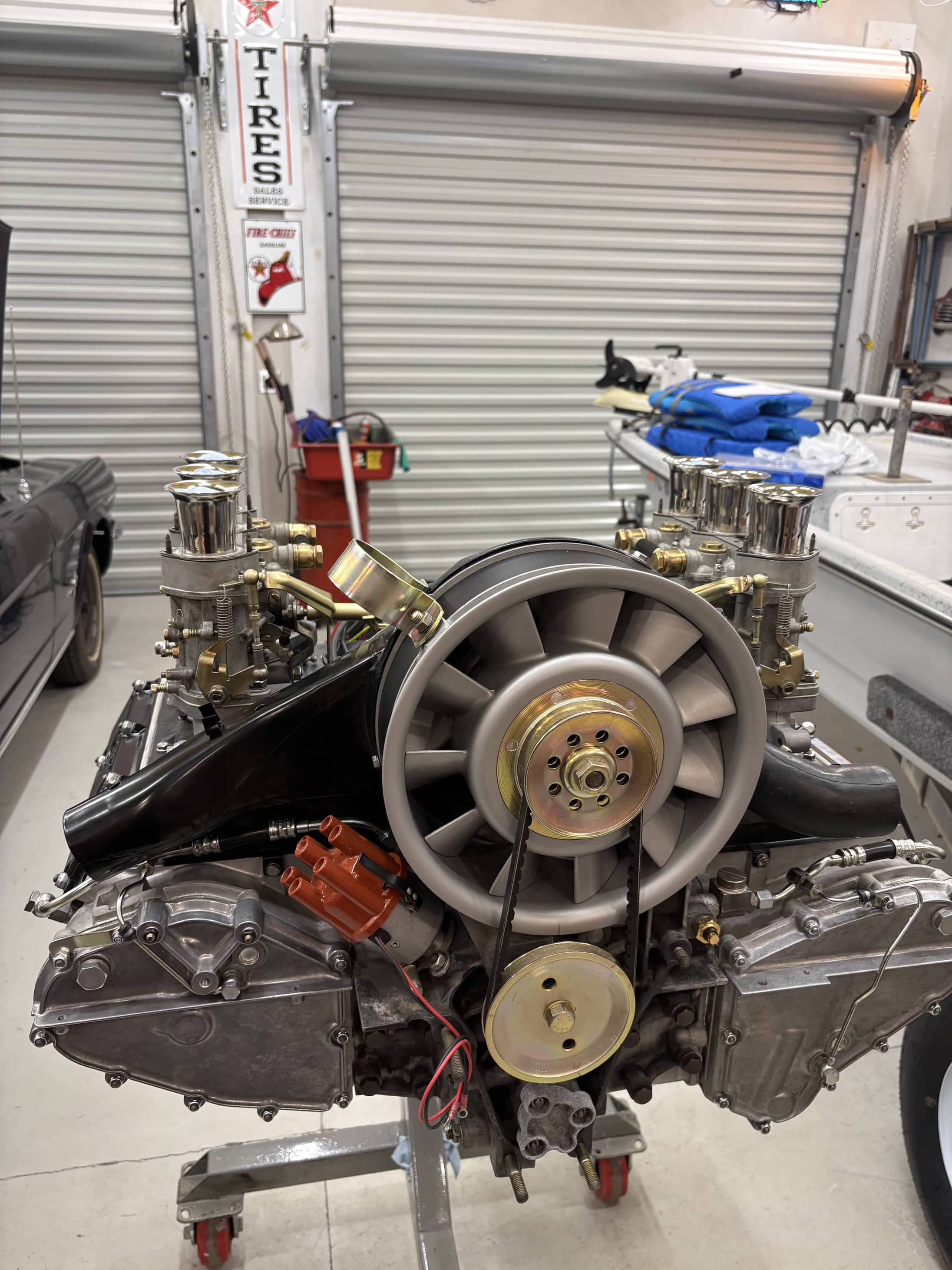

Engine as of today……looks like I have located a run stand….expect it in a couple of weeks. Also delivering engine tin engine mounts and heat exchangers to builder.
Just celebrating small victories.

QUOTE(sixaddict @ May 7 2025, 02:33 PM) *
You are not running the stock Marelli distributor? There are new cap and rotor sets for them now. And a Pertonix module too.
