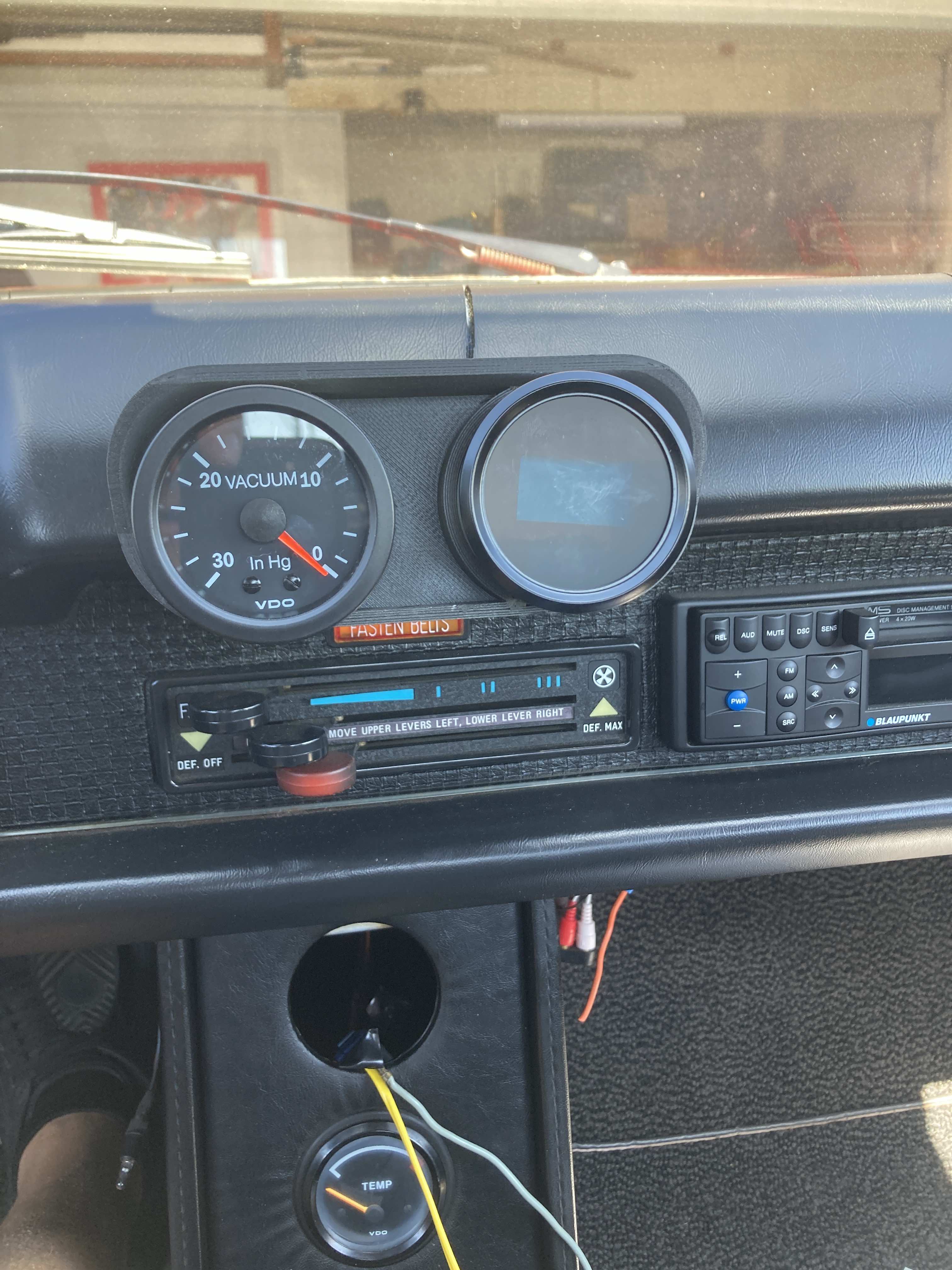

Very good idea. You have the chart for that temp gauge? I think people post it weekly. I would verify the sender matches your gauge as well if you haven't.
That vacuum looks right with retard running. Did it drop your idle down?

I don't have the chart but I can search for it. Yes, I had to increase my idle because it did drop . I am working on installing my gauges and wiring now .Here's a picture of the gauge pod that replaces my ashtray made by RTz and sold in the classifieds .I noticed the AFR gauge does not come with a wiring diagram and will have some questions about the extra wiring leads on the power plug later (still need to get the bung installed and decide which muffler to install it in as I forgot to purchase an additional bung) .Hers a photo of the ashtray gauge pod ,I really did not want to cut up my centrer console to install gauges ,by removing my clock which doesn't work I have just enough holes . I noticed some toggle switches on your center dash . Are those for powering the gauges ?
