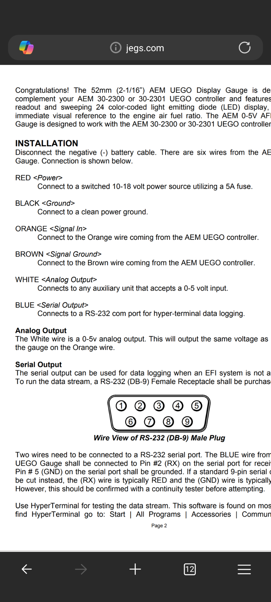

emerygt350   The instructions are online, not sure what model y...   May 8 2025, 04:19 AM
