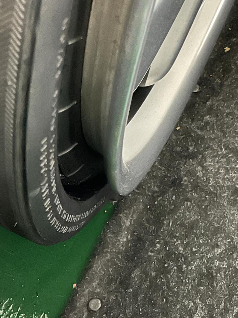

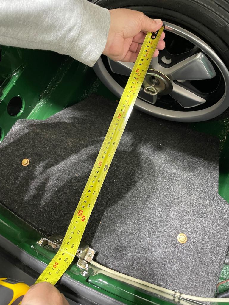

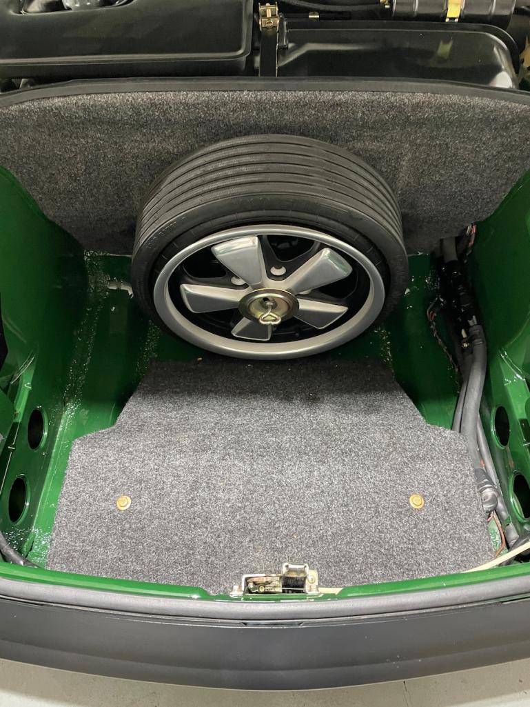

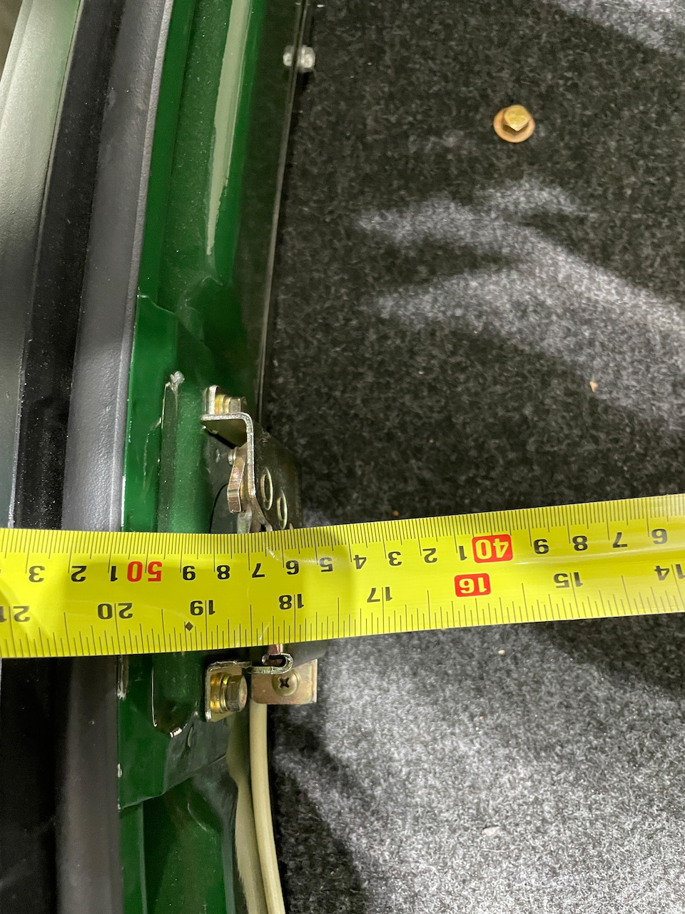

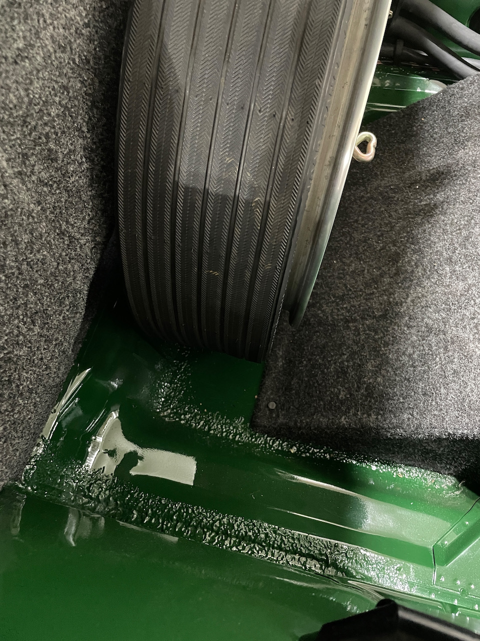

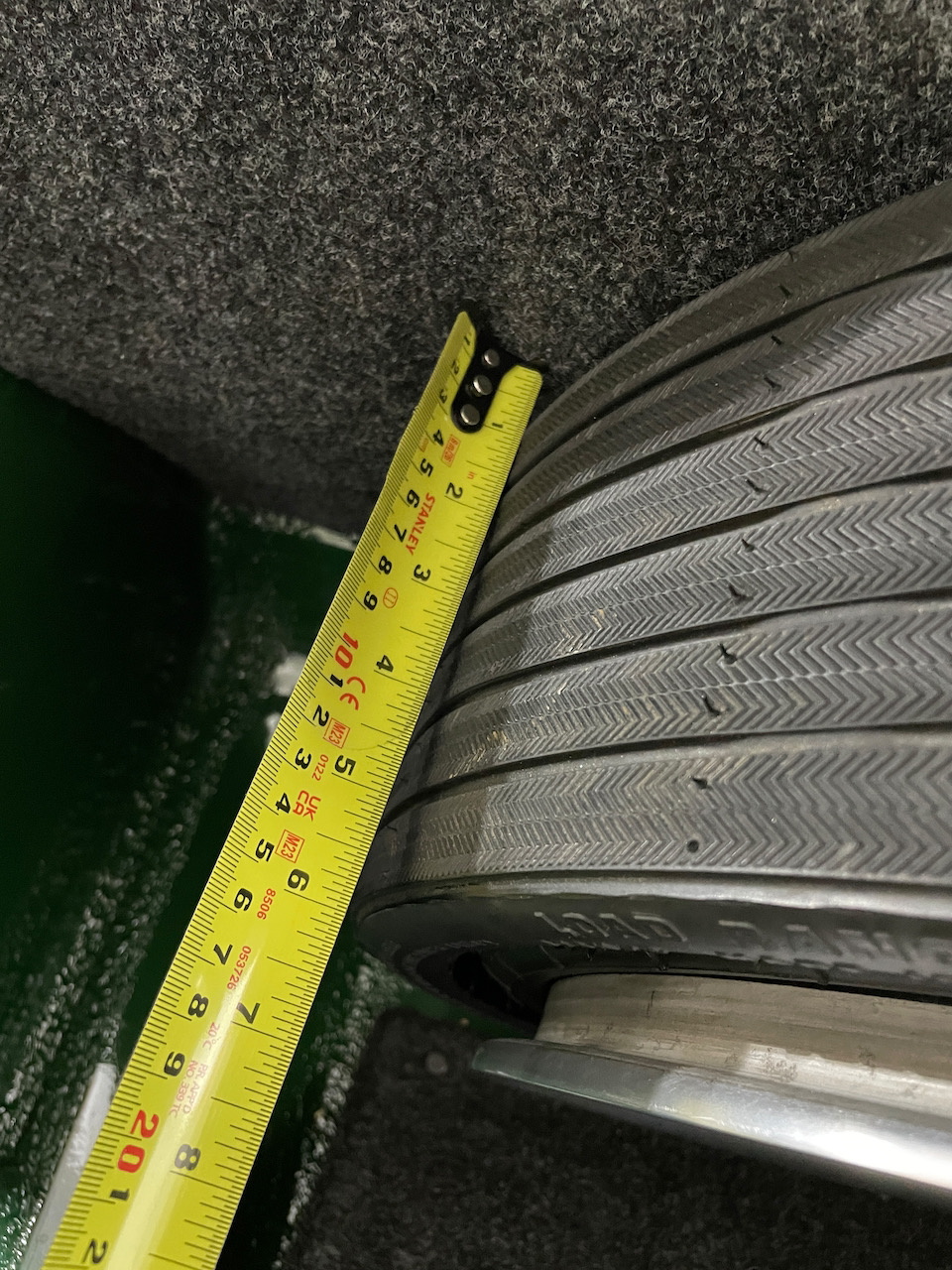

@roundtwo - Here are a few of the way my spare fits. I likely would not try to run it... I have a AAA card with 200 miles of towing.
