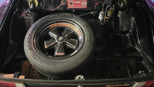

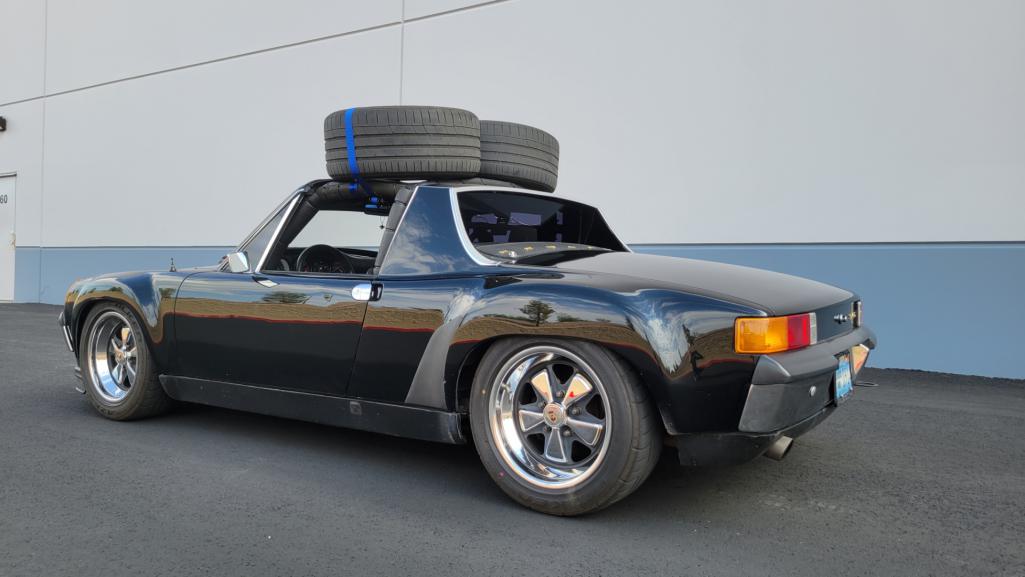

205 will fit in the rear trunk. 225 will not.
(The factory even provided a bolt hole to mount it.)
Or this also works.
